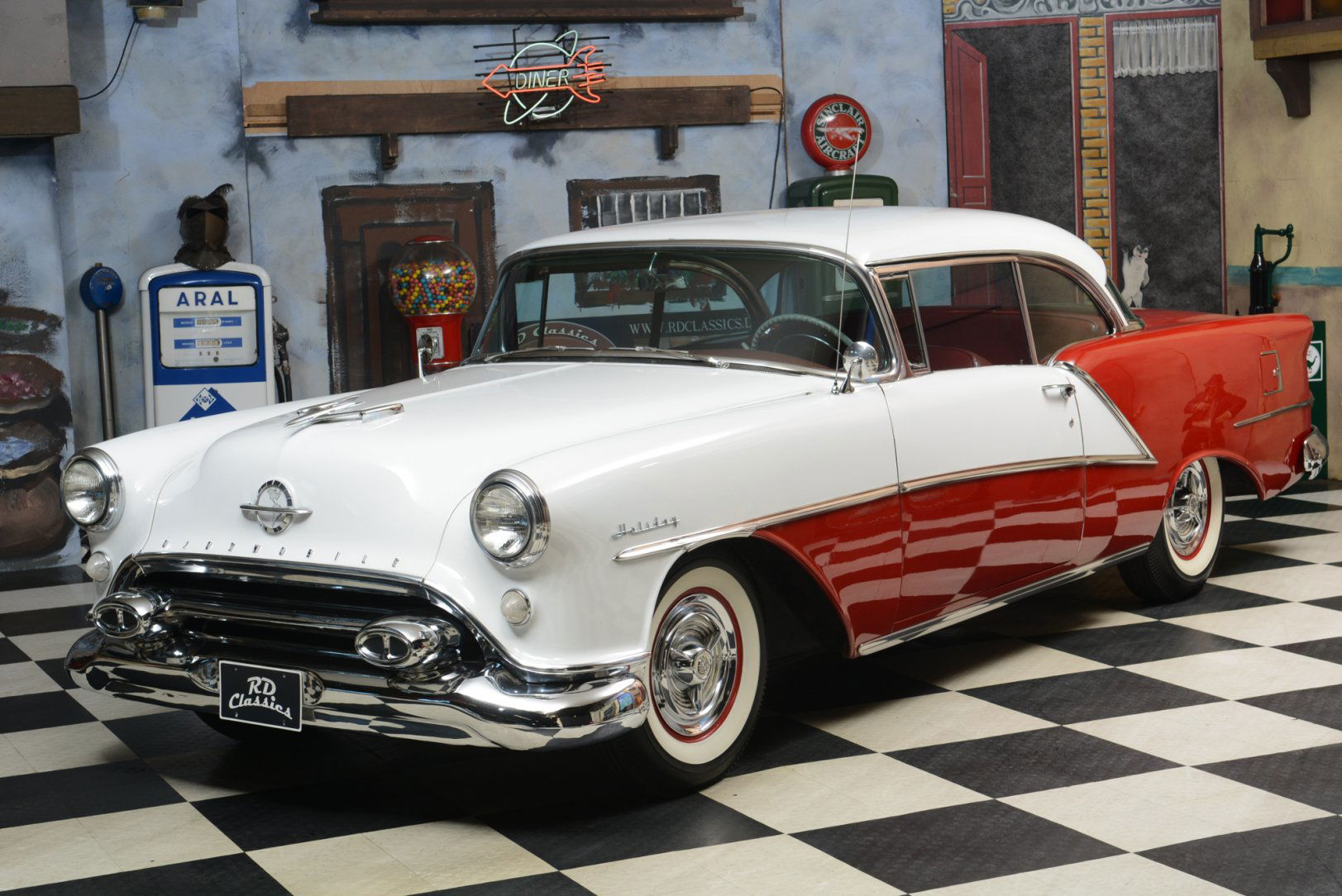

    Love the Olds! My dad had a '54 Holiday 98 up till about 1969 or thereabouts. Red and white like in this picture. Man, I would sure like to have that car today! Mid 50s Oldsmobile are some of the most beautiful cars ever made...in my opinion of course!
    It developed a problem that would kill the battery. My dad was no mechanic for certain. He bought another car, and traded the Olds away for a set of recapped tires to the owner of a local gas station. The guy came by the house, fiddled with it for a bit, clipped the wires going to the driver side power window, fired it up and drove off. My dads was so pissed!
