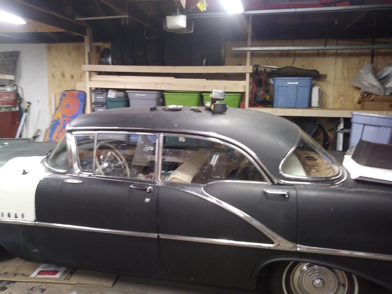

    And here is where it sits two weeks after purchase. I've done a few small things, ordered a few hundred in parts (with a few hundred more wanted). And I've started stripping the bedliner, exposing the badly degraded original paint. I will be stripping the car down and redo it in two-tone green & white, with a green metalflake roof (probably with lace panels). But for now I prefer honest worn original paint to badly-applied bedliner.
    I also spent part of last week wiring, insulating & sheathing the wall behind it and building those shelves so I could make room in the bay for it.

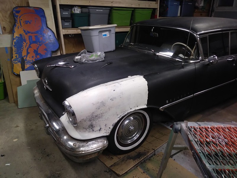

    While waiting on the fuel pump and other parts, I have been continuing to strip the bedliner & clean out the car. As seen in the first video, the front hood emblem had been covered in bedliner. Well while sorting through the bin in the trunk I found an old lens & globe from the emblem, which made me curious. So I took the emblem off, and disassembled it, the lens & globe were clearly new reproductions, with the lens coated in bedliner. Well with some careful removal and polishing, I got them back to looking new. So some prior owner spent almost $100 on these new parts, then covered them in bedliner. Weird.
    I also did some experimenting and discovered brake cleaner and a plastic bristle brush will get the bedliner off chrome easily. Can't use it on paint, but it'll save me time on the trim.

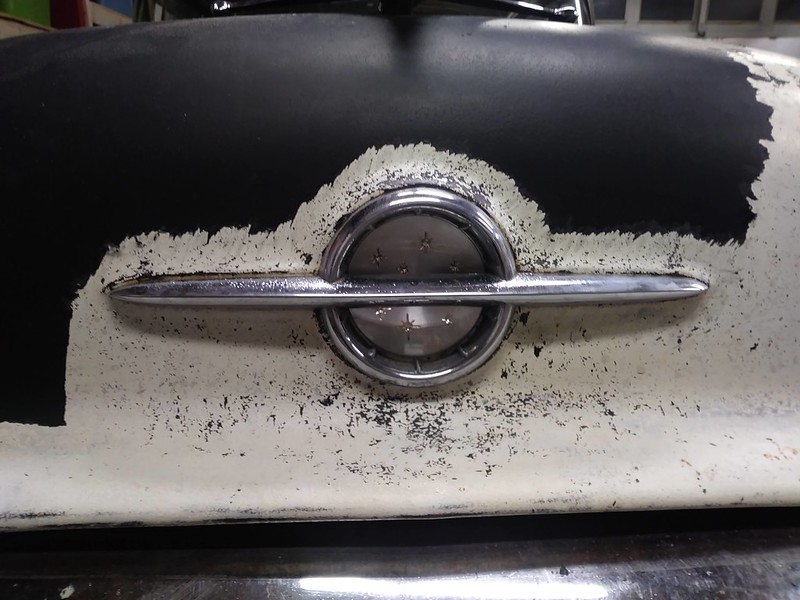

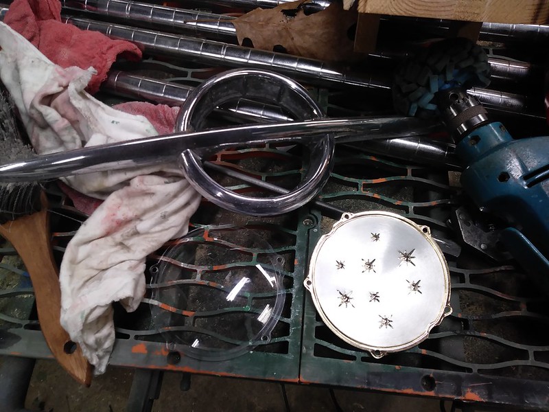

    Hood emblem cleaned of bedliner and polished and put back on for now.
    Bedliner stripping continues.
