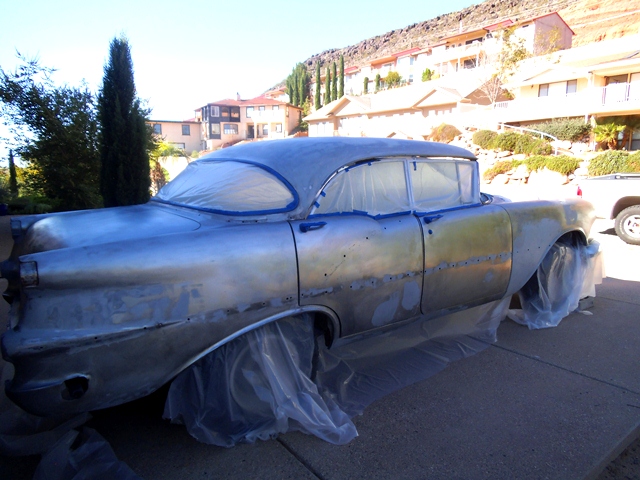

  1. ps i didnt use any 3m stripping pads..the wire wheel on a angle grinder did it all perfect..i have to say its one of the best most versitile tools..i can wire wheel...put a cutoff blade on and cut...and of course grind too...the spot sand blaster was nice too..just slow..but it only cost about 18 bucks on ebay..but it took everything down to bare clean metal..just save it for the really hard to reach areas

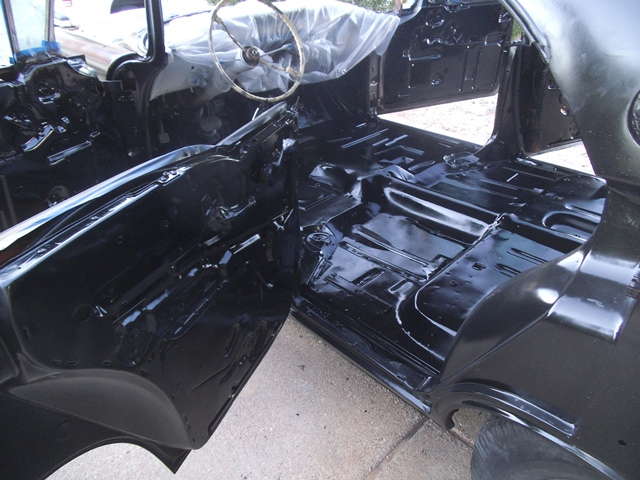

    el_bole

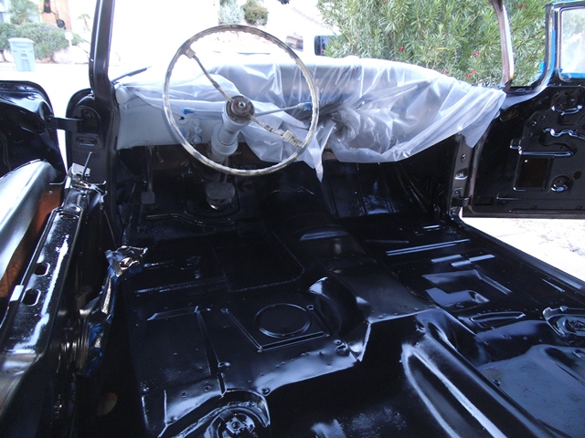

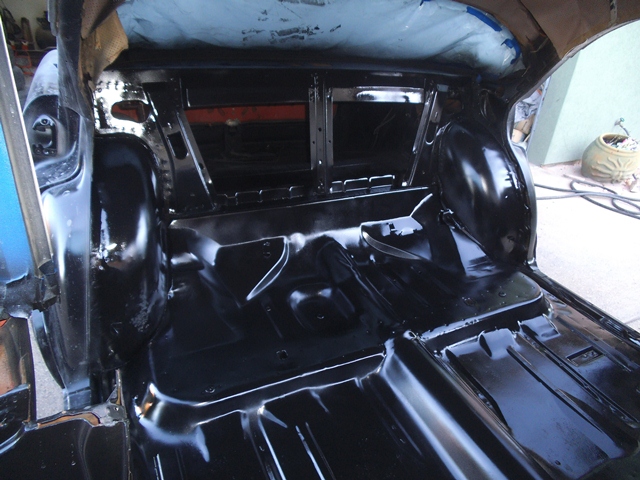

  4. Great job, I've been seeing cheaper alternatives to POR 15 on here lately...I need something for my floors. I already glued down the front rug, my main concern is the rear floors and my trunk...it's actually getting welded right now. As well as my door sills area.
  5. 56pontiacpiano...i have new welds i did on my floor boards and when i put this stuff on it just coated and sealed any possible pinholes that might be there..plus i could build up the layers to whatever thickness i wanted...i would like to see water penetrate that crap..its like my car has a skin tight wetsuit on..like i said i plan on using it on the inside floors to..then my metal will be sandwiched

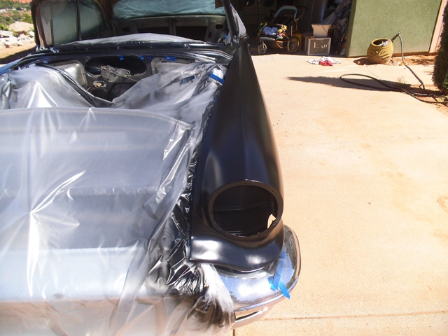

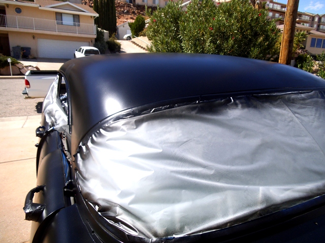

  7. 1st coat of SPI epoxy....i love the stuff....course this is my first time EVER...trust me i would like to say i sprayed it flawless but....good thing im still blocking ect...;) hose touched 1 time me 1 time plastic wrap 2 times:D doh....i will be better next time...
  8. Looks great! You should come by and paint mine too ;)
  9. trust me ya dont want me too....like a barber for the first time...ya might end up with a bowl cut...i did learn quite a few things though..but man does that stuff have a cool sheen to it....semi gloss...thats what i want the final look to be..now on to leveling things out to be perfect..you can see tiny imperfection with this stuff..oddly enough there isnt alot

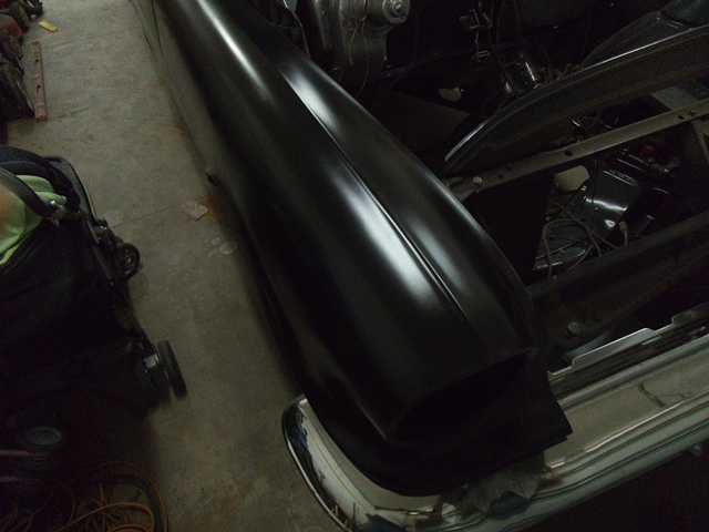

  11. thanks..im now block sanding and leaveling out the smallest imperfections in the body...and thinking ahead and trying to figure out what engine trans setup im going to do in a year from now...let just say there is alot of thinking while building them..not like a huge amount of info...so when you get ready i should know about 50% hahaha yep..

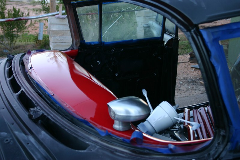

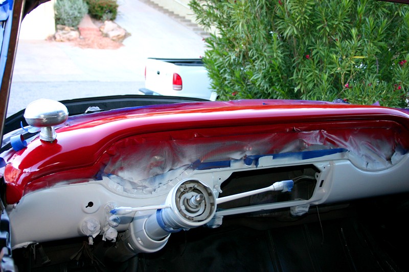

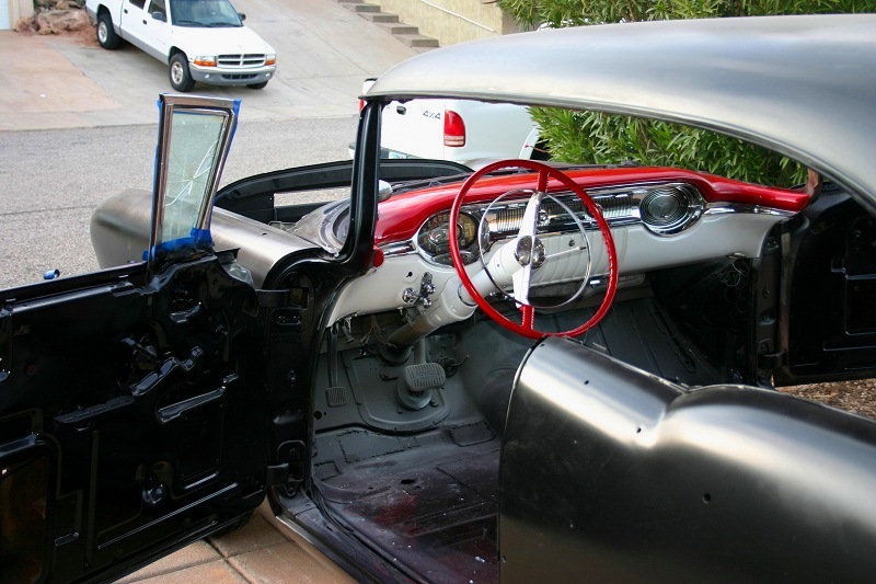

  13. working on the dash and trim today...i get soooo impatient and want to rip the tape off so i can see everything...but i must wait....i still have to sand the dash with super fine grit sand paper and shoot another coat and a clear coat..THEN...i can unwrap the chrome parts of the dash...:D

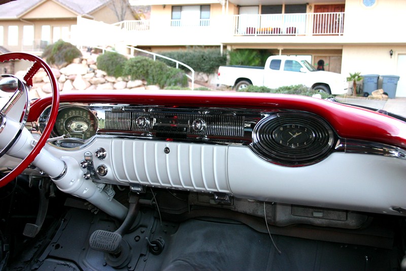

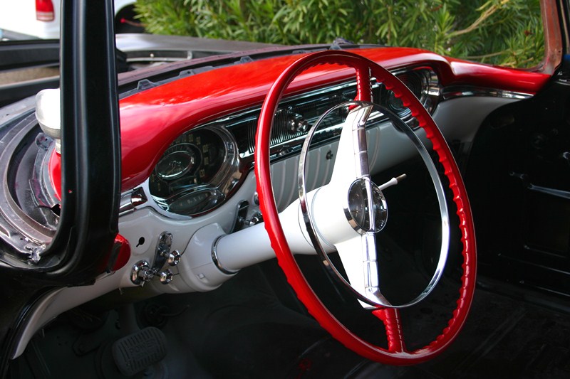

  28. FINALLY...got to untape the dash and repaint the black stripes and shine the chrome and stainless trim:D oh and put the glove box door back on...heres some befores and afters
