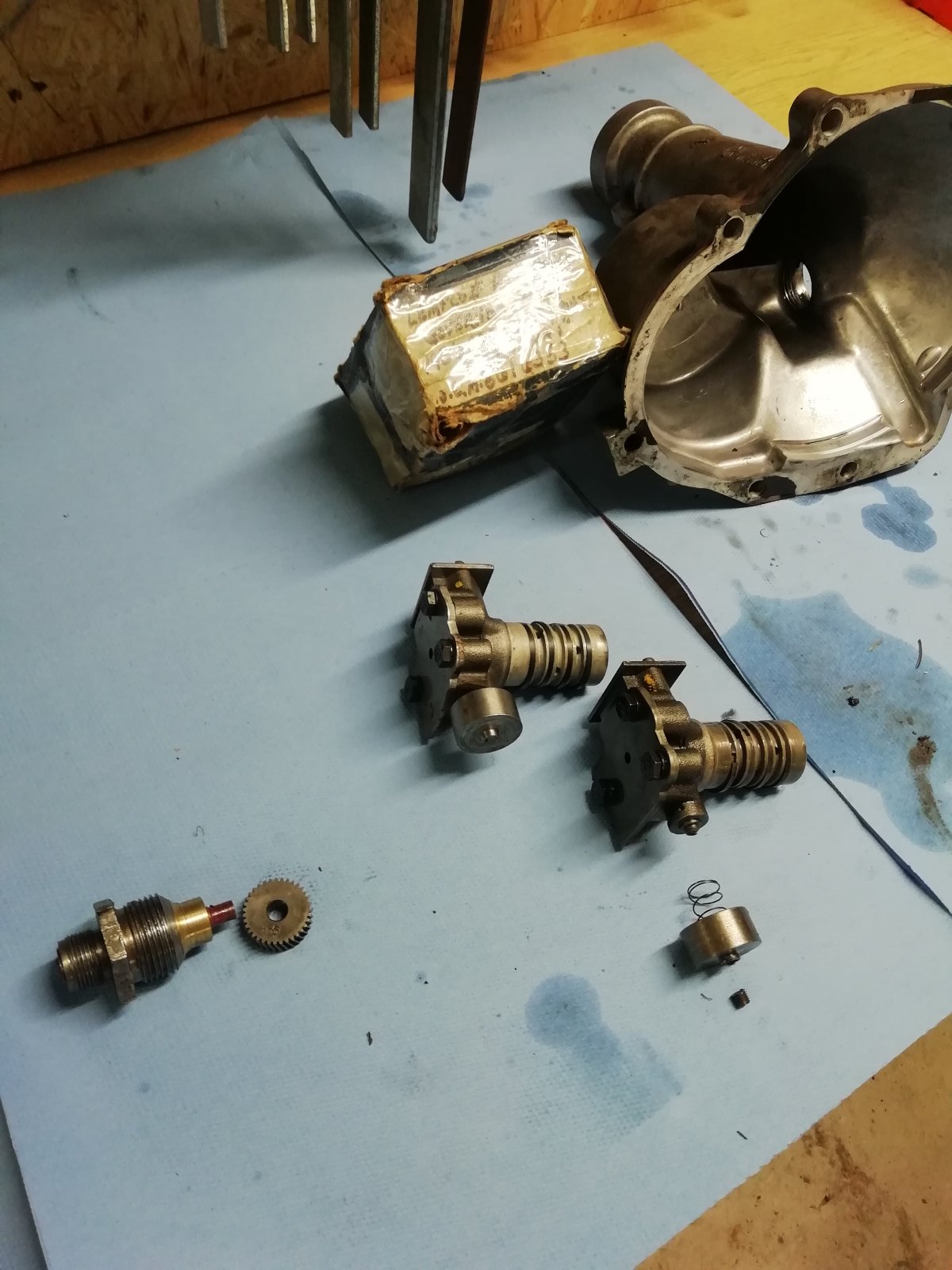

    When I opened the pan and found scraps I opted for a complete rebuild and found the issue being caused by the counter weight of the governor chopped off by a defective speedo gear that came loose.
    I got me a replacement NOS governor and a rebuild kit and started the task.

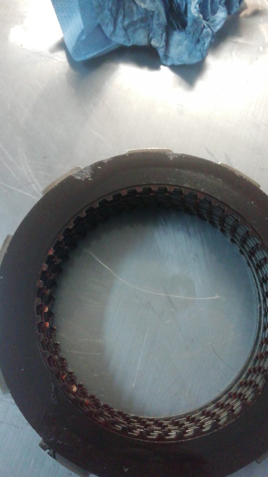

    I completely tore apart the tranny and found a few defects which I rectified as I put together the whole thing again.

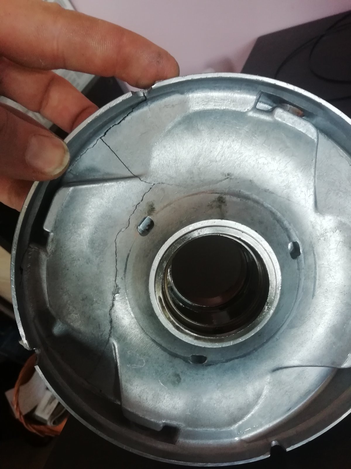

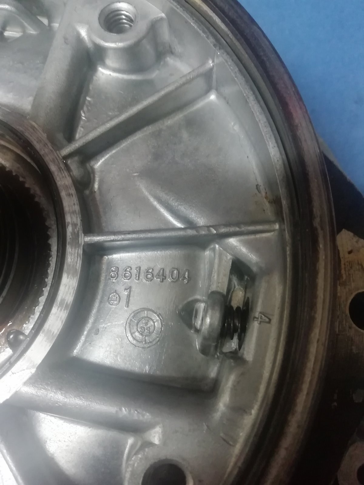

    Latest discovery is a cracked front unit cover...
    I did some research but could not find any replacement for my cover #8616404. There is similar ones #8618338 available but I am not sure those will fit...
    Anyone of you Techies knowing if I can risk spending money on the part or better save it for some (unknown) other time. Unfortunately it is still impossible finding any parts here in Germany...

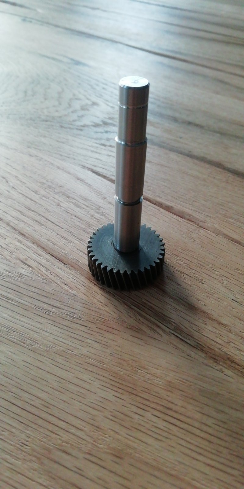

    One outstanding thing is still the speedo drive - someone had replaced the shaft with a later design plastic shaft that he melted into the gear... Didn't hold up well and finally killed my governor.
    Meanwhile - as I couldn't get a matching gear shaft I am working on making me one myself... Most interesting task is to fab up the square bore for the speedo cable. ;)

    I don't know anything about these trannies. Is there much pressure behind the cover? If not you can probably fix the crack with JB weld or a similar metal impregnated epoxy. I had good luck fixing an actual hole in an atv trans.

    Have you called Fatsco? They are THE authority on obsolete transmission including the Jetaway. I'm spoiled with them being right here in my backyard in NJ, and I know they stock a ton of obsolete parts and random stuff. It's worth a call to them to see if they have a replacement cover. And they ship internationally.

    Yeah, found a cover at Fatsco that I ordered. Got shipping confirmation and should be here early January.
    Fingers crossed not many more issues surfacing on the rebuild... Costs for part, international shipping, customs dues and fees plus waiting time just killing me...

    Since the frunt coupling is a flzid coupling witch driving/driven torusses there is quite some fluid motions in there and I once at it I really would not go down the route of gambling... On top the entire unit is supposed to be balanced so it doesnt wear the bushings messing up more of the components - so sticking jb weld on it won't do an acceptable job fixing the issue...
    bchctybob and Cutlas Fan like this.

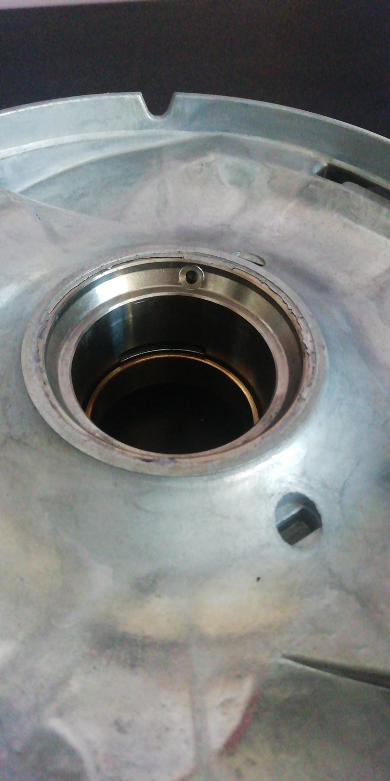

  19. Johnnyolds98
    Joined: Jul 6, 2009
    Posts: 123
    Johnnyolds98

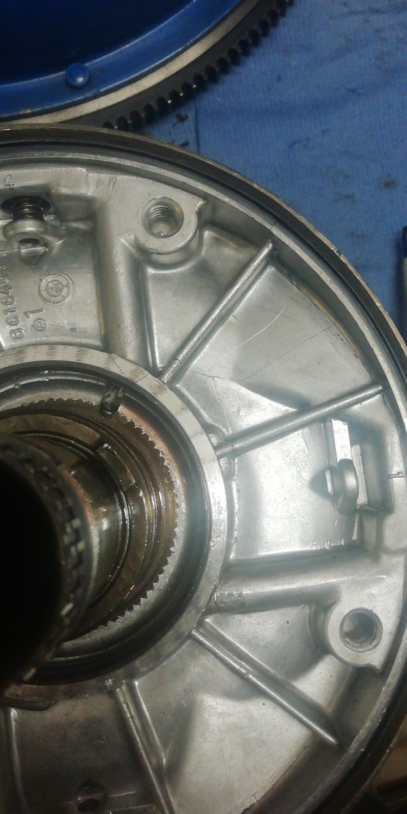

    Got a nice present from Fatsco in time for Christmas...
    Had some time to remove the old front unit cover and found it was about time that thing will be replaced. Barely holding together...completely cracked.
    'Don't downshift!'
    bchctybob likes this.
  20. Johnnyolds98
    Joined: Jul 6, 2009
    Posts: 123
    Johnnyolds98
    Next task is to remove the old shaft bushing ring from the old part without damage so I can re-install it on the new cover.
    Unfortunately not been able to locate a new replacement yet.
    Maybe heating up the old cover in the oven...?
    Would not like to start using force e.g. pullers or driving it out from the back as I fear damaging it.

    Not going to be much help but I remember the guy that rebuilt mine years ago telling me he had put parts into the freezer overnight to get them apart or reassembled.
  22. Johnnyolds98
    Joined: Jul 6, 2009
    Posts: 123
    Johnnyolds98
    Hmmm.
    Why not. Freezing makes metals contract. Worth a try

  25. Johnnyolds98
    Joined: Jul 6, 2009
    Posts: 123
    Johnnyolds98
    Didn't work out.
    According to Fatsco I should not worry. Will work without this. It's just a different design.
  26. saltflats
    Joined: Aug 14, 2007
    Posts: 12,592
    saltflats
    from Missouri
    Cut the old part apart, just don't nick the outside of what your after.
    Does this piece fit the replacement part you have?
