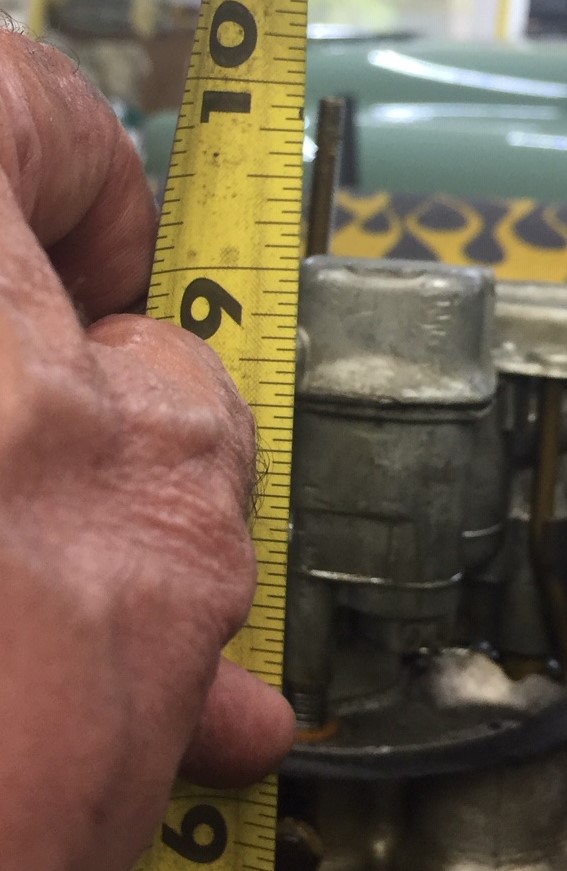

  6. jaracer
    Joined: Oct 4, 2008
    Posts: 1,142
    jaracer
    One thing to remember is that you don't have a lot of hood clearance. The cork strip on the breather is supposed to seal the area right in front of the hood scoop, so it touches the hood.
    loudbang, Thor1 and Hamtown Al like this.
  7. Hamtown Al
    Joined: Jan 17, 2007
    Posts: 2,546
    Hamtown Al
    1. Virginia HAMB(ers)
    I expect hood clearance to be another "opportunity";):D but I want it running fast and strong and reliably first!:)
    We'll figure something out... I hope!!:D

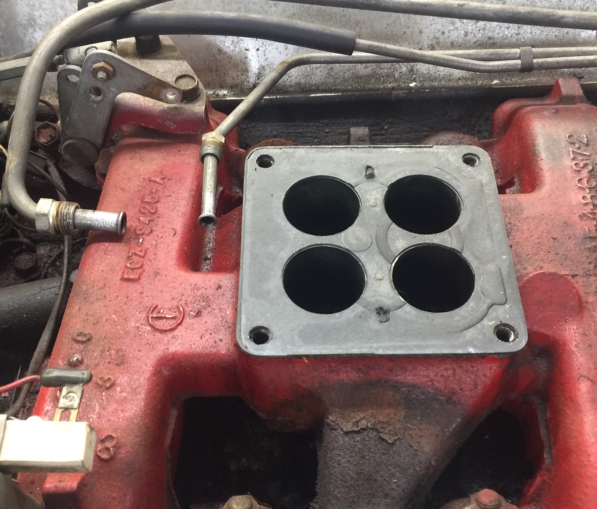

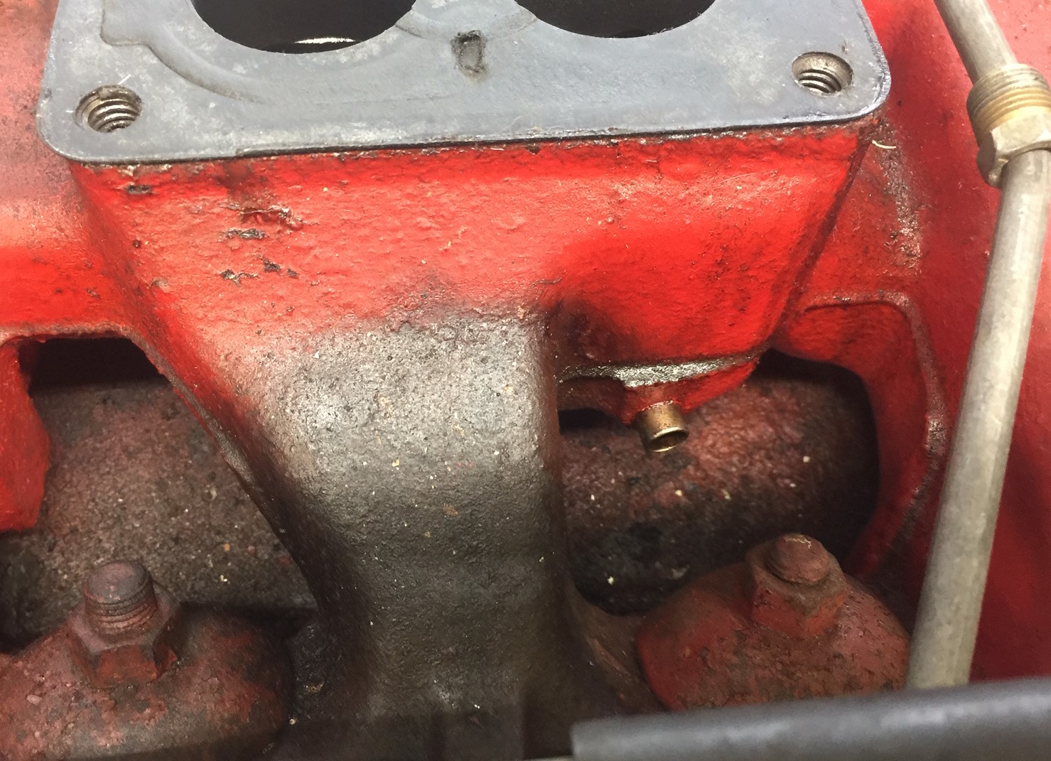

  14. Hamtown Al
    Posts: 2,546
    Hamtown Al
    One last measurement to the tip of the stud that holds the air cleaner on... pretty much 10" on the nose from the ref point on the manifold.
    After getting the carb off I discover that the present manifold gasket looks pretty new and in good shape. I was told the carb was rebuilt so the new gasket is consistent with the story which is a good thing. I'm thinking a coat of copper coat spray sealant should do the job.:)
    Question I have is what/how to plug two fittings coming out of the intake manifold that were hooked to tubing that both went to the carburetor? I was surprised to see that the ends attaching to the fittings on the carburetor both just slid right in the hole... no thread, no sealant, no nuthin'!! I'm guessing they are vacuum lines but sure didn't seem too air tight to me. I'll figure a way to plug them and see what happens. Somebody that speaks Y-block can tell me what it is and suggest a solution... I won't mind.;):D
    This one is on the driver's side and seems to bee just a little brass sleeve that the brass fitting on the end of the tubing just slid into. Baffles me.:)
    Learning Al
  15. Dennis D
    Joined: May 2, 2009
    Posts: 756
    Dennis D
    May have something to do with the choke if it is a hot air type. D
    loudbang and Hamtown Al like this.
  16. Hot air source for the choke; if the tube isn't rusted/burned out inside the manifold there's no real need to plug the ends.
    ottoman, Thor1, loudbang and 2 others like this.

  18. miker98038
    Joined: Jan 24, 2011
    Posts: 621
    miker98038
    Plug one side and see if you can blow thru the other with a short piece of vacumn hose. Those choke heat tubes often rust out, and just open give you an exhaust leak.
    This is an “ask me how I know” comment. If it’s an o/d car with the kick down switch working, you need to consider that when you adjust the new carb throttle linkage. On the 55’s they used a spring loaded on one side or the other of the bell crank. So you hit full throttle before you closed the kickdown switch. The spring loaded link let you push further and close the switch. They apparently didn’t use that in 56-57, no idea why. Money, probably. Just a minor item to keep in mind. The switch has a long thread mount to adjust it under the throttle pedal.

  21. tbirddragracer
    Joined: Jul 25, 2013
    Posts: 91
    tbirddragracer
    The tube in the intake manifold provides heat to operate the automatic choke
    for the carburetor. This tube does not connect to the exhaust system in any way,
    therefore cannot cause an exhaust leak.

  24. jaracer
    Joined: Oct 4, 2008
    Posts: 1,142
    jaracer
    Doesn't it go into the exhaust crossover in the intake? I see they make the replacement out of stainless to keep them from rotting out.
    ottoman, LWEL9226, warbird1 and 2 others like this.
  25. miker98038
    Posts: 621
    miker98038
    ^^^thats how I remembered it.
    LWEL9226, warbird1, Thor1 and 2 others like this.
  26. y'sguy
    Joined: Feb 25, 2008
    Posts: 465
    y'sguy
    from Tulsa, OK
    Yes, ^^^^you should plug both sides to be safe. It doesn't take much. a bolt or rivet with sealer.
    On the carb choice I also have the Eldy carb. But I have it on a BlueThunder aluminum manifold and no clearance issues. You will have to be way cautious on closing the hood with that setup. Great way to ruin an expensive hood. I would recommend removing the latches on both sides of the hood and carefully slowly lowering it down by hand. If it's going to touch you know it before ruining anything. Clearance is really tight and I never trust just measuring it, but it will get you in the ballparkThe Eldebrock carb is a decent choice, but I plan to change over to the Summit version of the FORD Autolite carb. It has been found to be more adjustable and efficient according to Ted Eaton. Mine tends to smell rich and I can't seem to ditch that annoyance. Otherwise it's fine and a no brainer.
    IMHO it's best to plug the intake by removing it and closing off the ports in the head with thin metal, this is what I have done for years as it keeps a little less heat out of the intake manifold in theory letting the fuel run cooler. Bonus is the intake runner paint doesn't get burnt off, which will eventually happen to yours the way it is. No big deal though that's the way Henry planned it anyway.
  27. y'sguy
    Posts: 465
    y'sguy
    from Tulsa, OK
    Forgot to say that you can replace the crossover tube IF you remove the intake with the stainless version. Then you don't need to plug it.
    As mention before by TBirdDragracer, the trouble comes I recall when the tube is rusted thru AND you are unplugging it. Then you have a manifold leak. At least that's how I remember it. It's been a while.
    loudbang, mctim64, Hamtown Al and 2 others like this.
