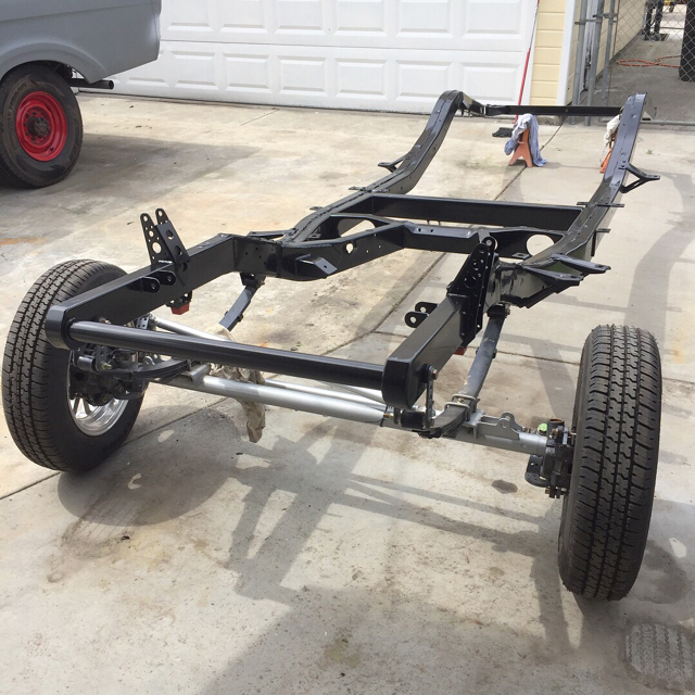

  5. Lancer
    Joined: Jan 11, 2004
    Posts: 1,247
    Lancer
    Body is off the frame. Now to prep and paint the frame and rear suspension. 28280041_10150957432724946_7485606395457121076_n.jpg 28379232_10150956980989946_7101853244299915437_n.jpg 28378916_10150956985984946_5301820609432647148_n.jpg

  6. Lancer
    Posts: 1,247
    Lancer
    The car is totally blown apart now and going out for powder coat next week. Yay!!

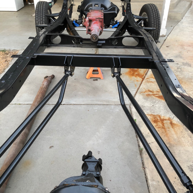

  13. Lancer
    Posts: 1,247
    Lancer
    Today’s fun, figuring out the driveline length so I can have one made. Also need a yoke for this early top loader. Anyone have one you’re not using?
    [​IMG][​IMG][​IMG][​IMG][​IMG][​IMG]

  14. OahuEli
    Joined: Dec 27, 2008
    Posts: 5,039
    OahuEli
    from Hawaii
    Maybe its just an optical illusion, but will your driveshaft clear the ladder bars' front crossmember?
  15. Lancer
    Posts: 1,247
    Lancer
    Nope, it will have to be notched and a drive shaft hoop added. Good eye.

  16. I was just about to ask about the driveshaft, looks like it going right through. Just pop in a safetly loop and pretend it was on purpose! :)
  17. Lancer
    Posts: 1,247
    Lancer
    This was planned for. We’ve just got it to the point now to make it happen.
