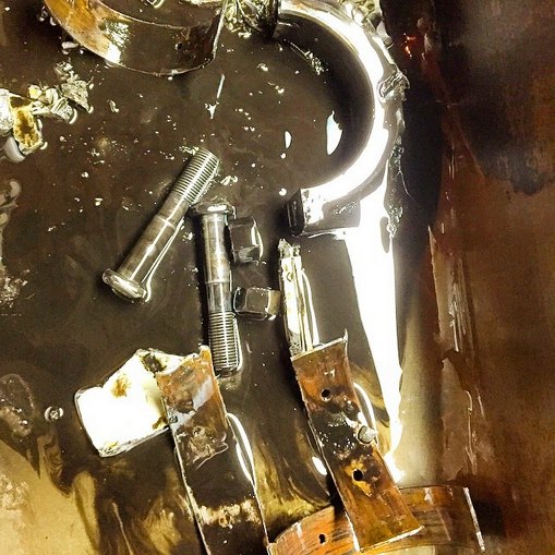

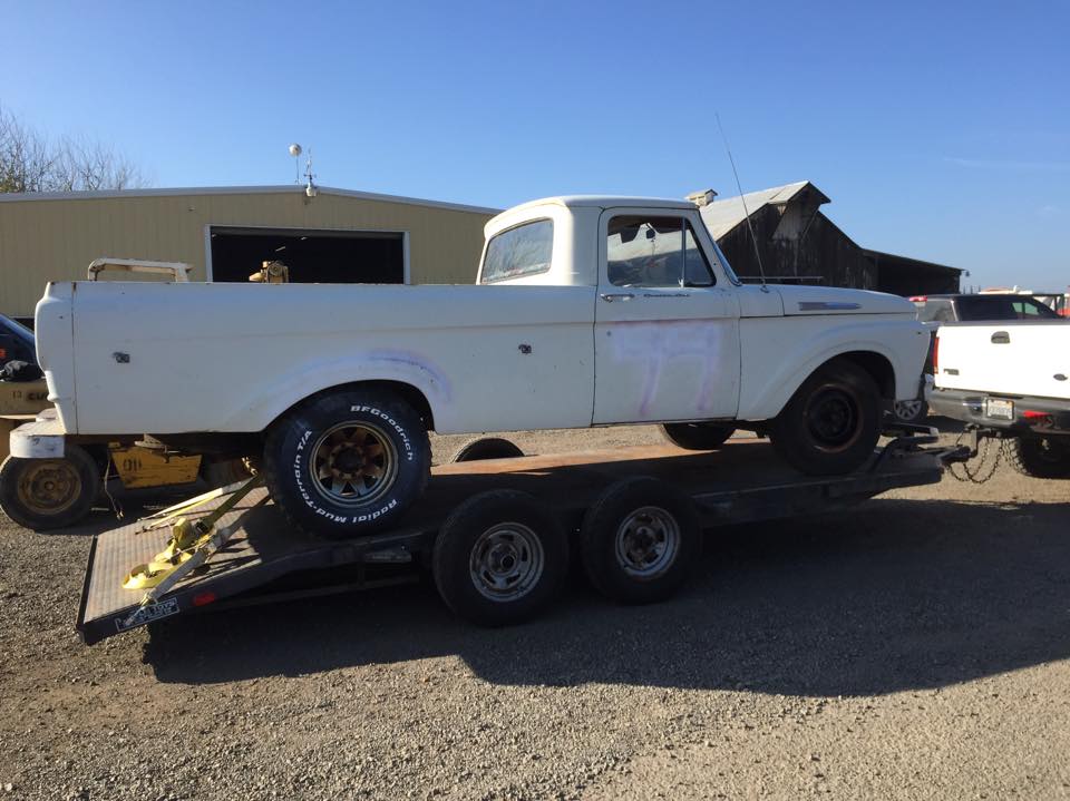

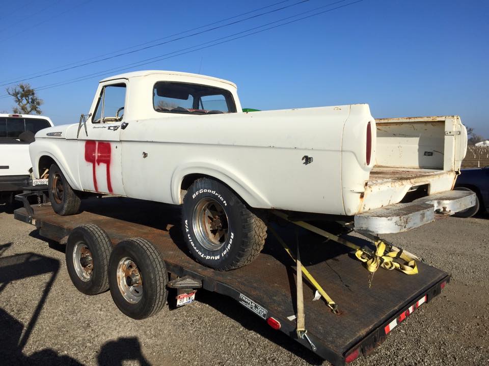

    Okay, update is not exactly on the Monster, but you will see the connection. Follow along. I have not had a truck for a few years and well, I need one to pull the Monster around with. So I've been wanting a Unibody Ford. After a half hearted search on Craiglist I can across this one. '62 Uni 3/4 ton, long beed, Yblock, four speed. Very solid and very straight. Been sitting for 12 years and they price was right. It has the tail gate too not shown. I had hoped to get it running on the cheap but after pulling the pan, (see photo) its going to need a bit more. So, I called @mctim64 also known as the Y-Block guy to help me out. The motor will be pulled tomorrow, weather permitting. Plans are to get it prepped for paint, replace the front window and sort out some other small issues. So, indulge me as I post on this from time to time as we also discuss the Canned Monster. Stay tuned.

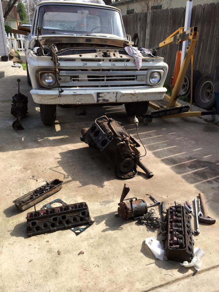

    Pulled the motor on the "Monster Hauler". I now have a couple of metal sculptures to display. Engine is heading down to @mctim64 next weekend to get some therapy.
    10425073_10205900838982630_6347848208786672484_n.jpg 10991372_10205900839222636_8946467970471627758_n.jpg

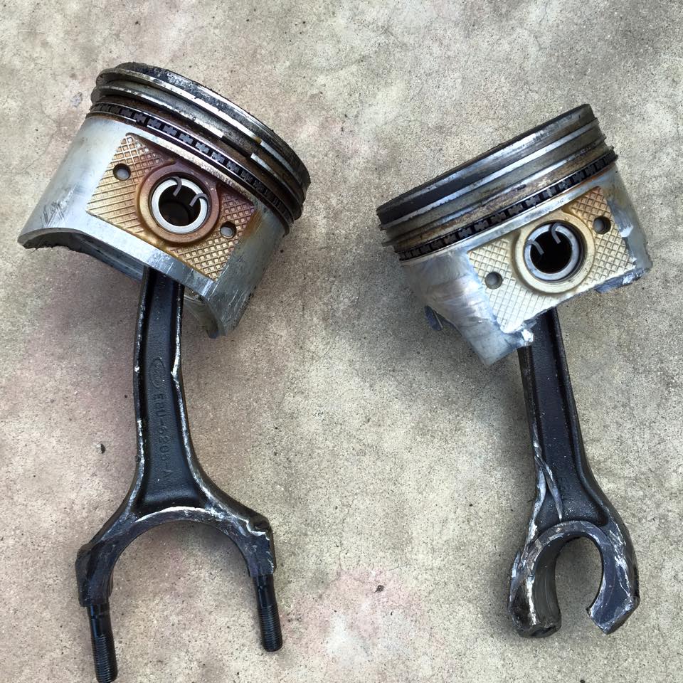

    From the Monster Hauler engine as it arrived at my house. .060 over and after market pistons. When you run it out of oil and the bearings come apart, bad things happen. After sitting for ten years the guy who had it told the guy I bought it from that it ran when parked. That has become a running joke now.

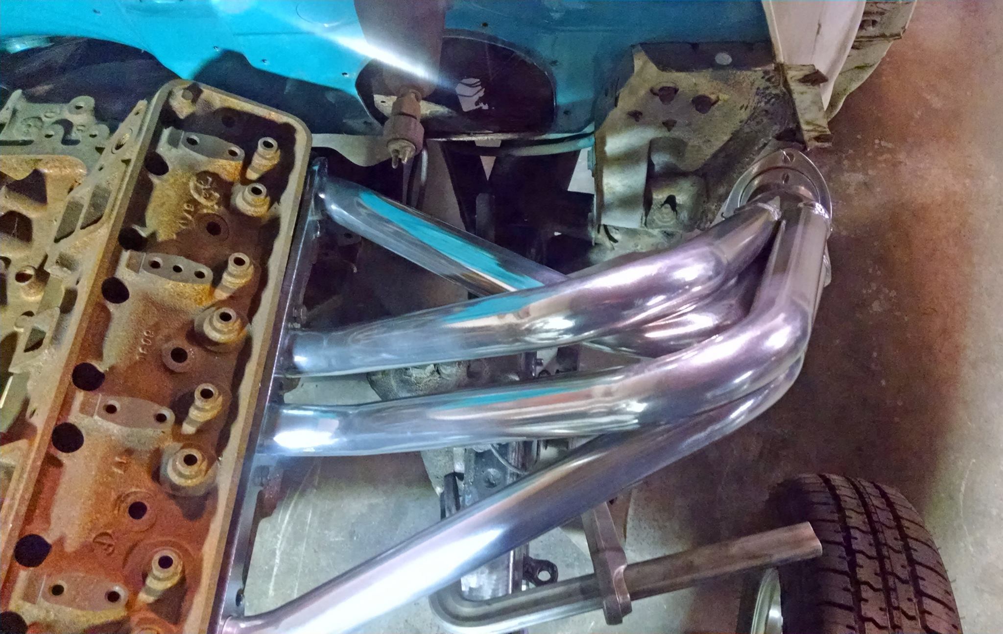

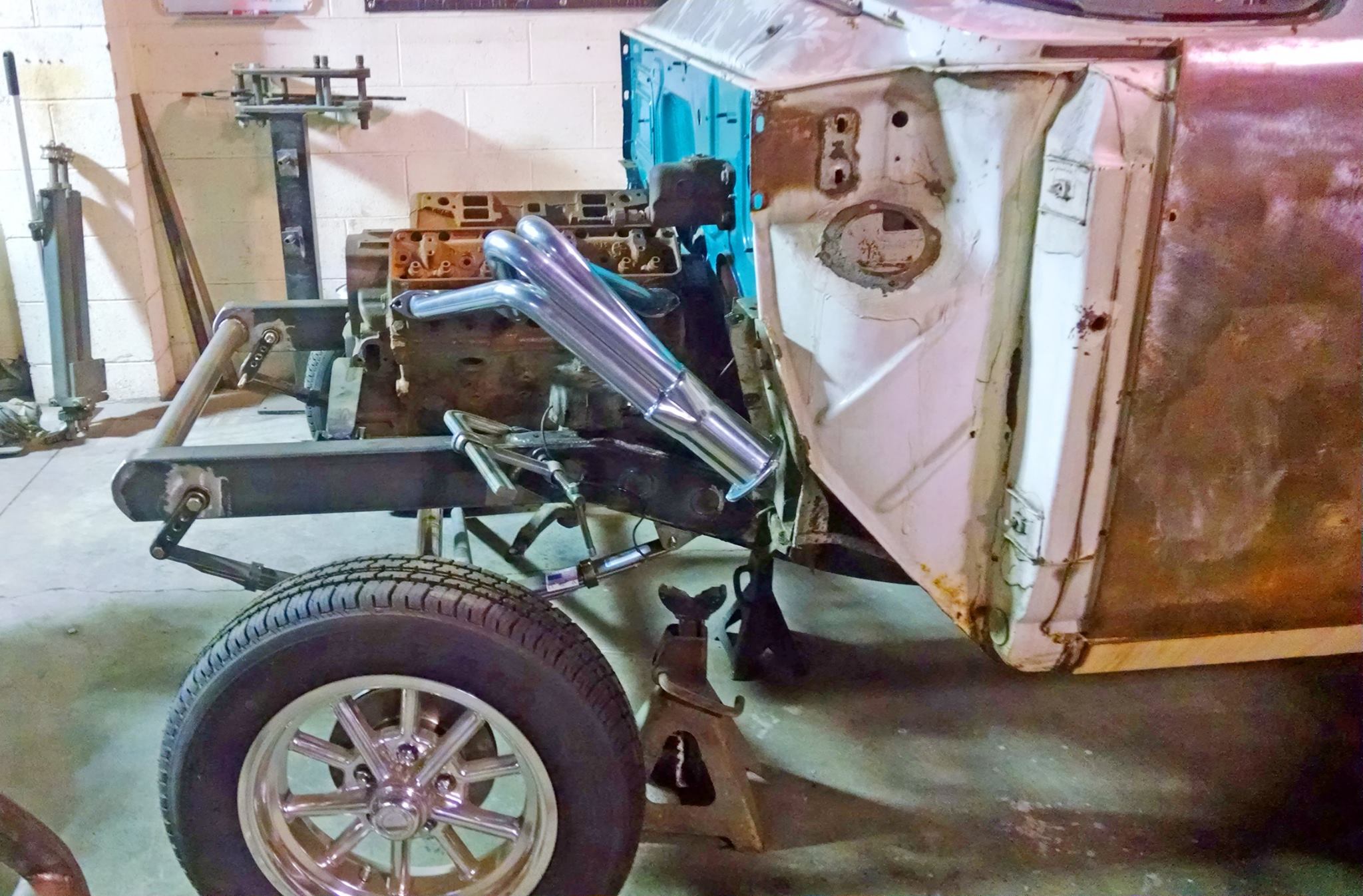

    JG Design & Fabrication has been busy. Front wheels are on and headers mocked up. Looking at making some tweaks to how the headers flow.
    1617167_414546662045104_7793216805197922819_o.jpg 10644539_414546658711771_8052933100851674613_o.jpg

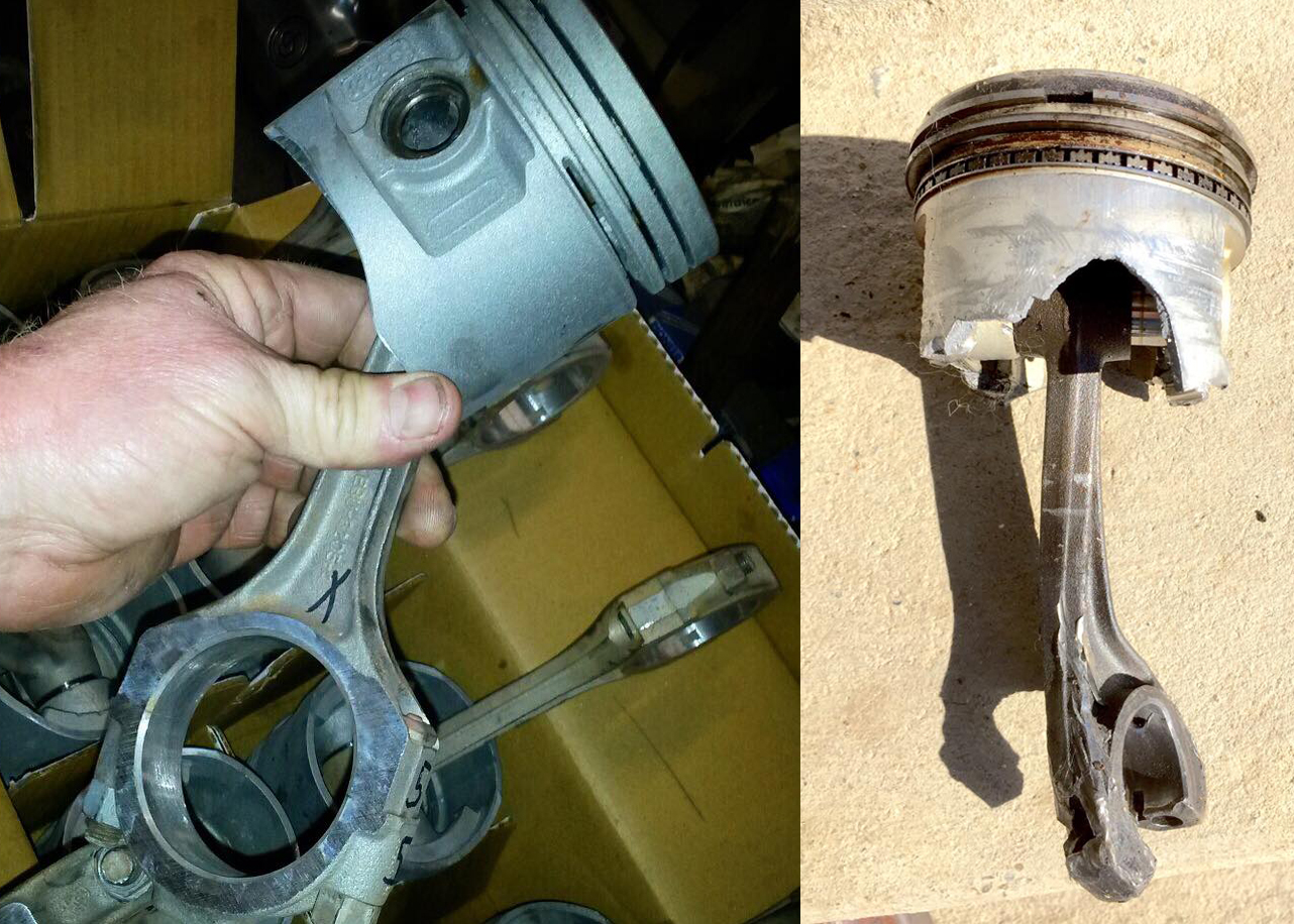

    A very nice set of clean used .060 over 292 pistons on a set of balanced reconditioned EBU connecting rods. For our Monster Hauler. One step closer. 11043154_415249755308128_788406230873670497_n.jpg Out with the old...
