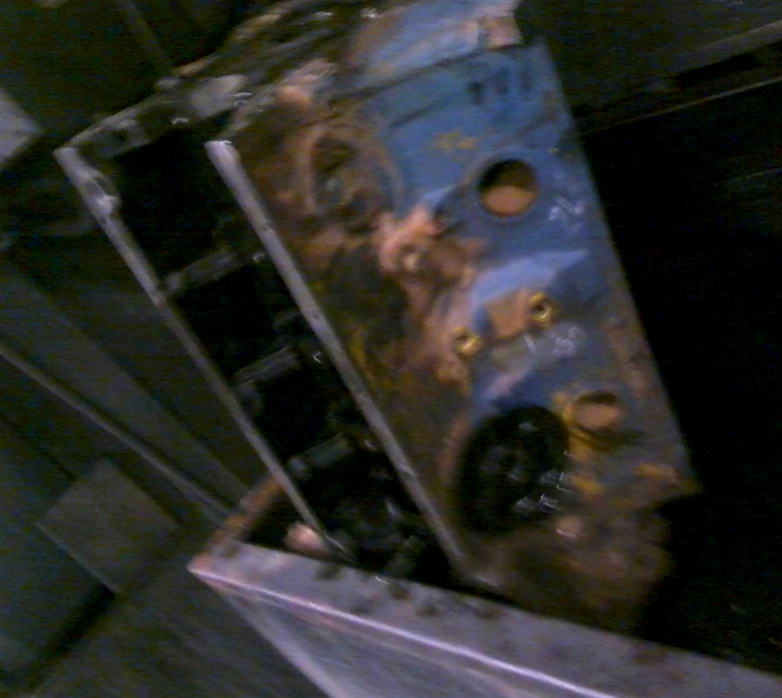

    Couple of pics from the machine shop. The engine is just going in for its steam bath. The rods are just out of the bath. Rods are C1TE HD truck rods that will hold up well for this buzz motor. The engine is a .125 over 272ci ECG casting.

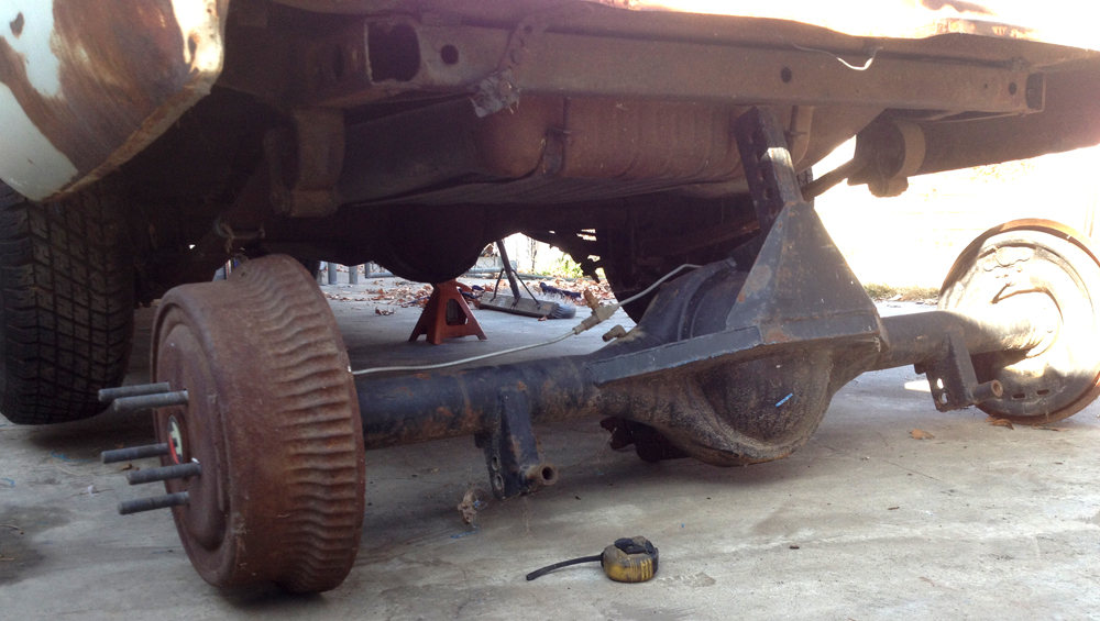

    This weekend we will be pulling some of the front end apart and getting measurements for the straight axle so I'll have a few pics to post up. If anyone is looking for 56 Ford parts, drop me a line, there will be a lot of stuff coming off the car that won't be used.

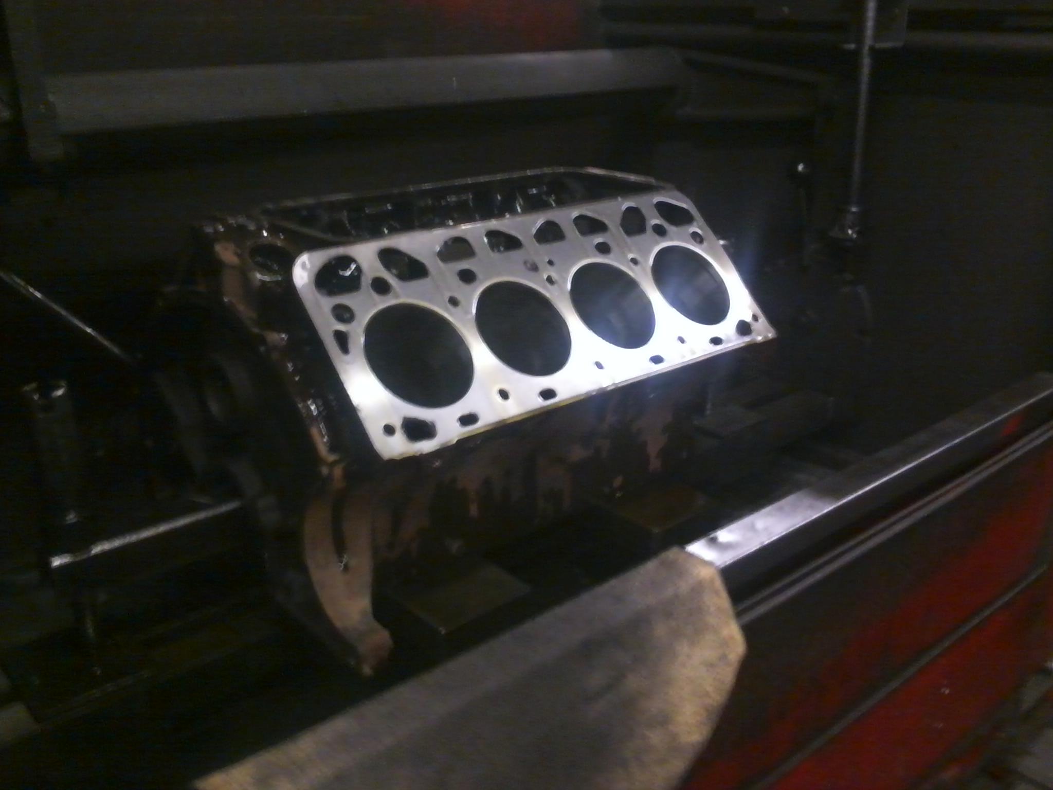

    Engine work is being done. Check out the block being decked & honed. So stoked about this.

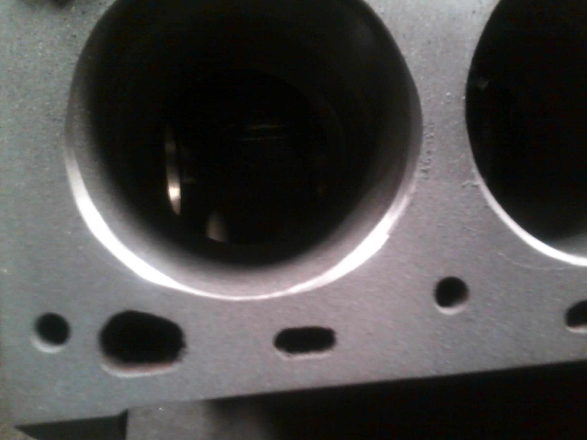

    Progress on the internals. Pistons are cleaned and balanced. The vintage pistons are .125 Jahns. and came from Pete Blakeley. Vintage parts in our vintage gasser. Should be darn near 12:1 compression when done. Nice and crispy.
    Block pic shows the relief on every cylinder to clear the 2.02" and 1.6" valves when running a .600 lift cam and rocker combo.
