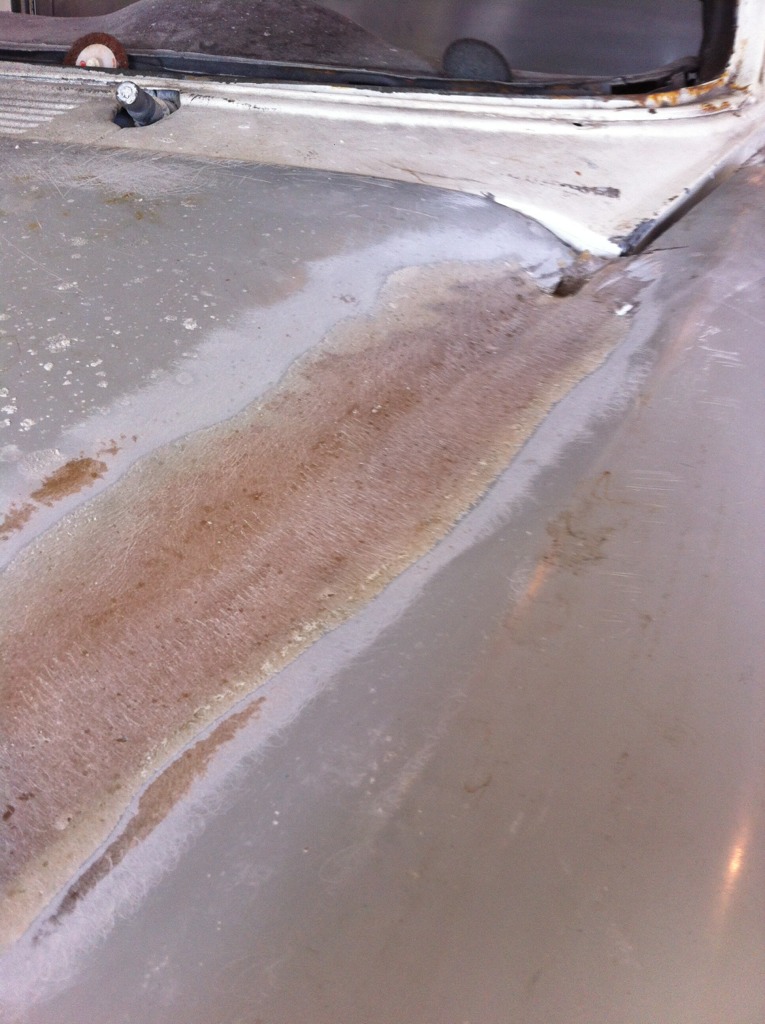

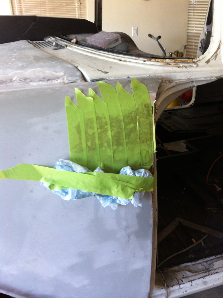

    Started glass work today. Just getting my feet wet since I have never done this before. Removed the lettering too..looks so much better.
    ...all for now. Headed out to watch some drag racing. I am going to start working more at night too. Lots of ideas I can't wait to try. Stay tuned..
  25. Bean Dip
    Joined: Dec 25, 2011
    Posts: 882
    Bean Dip

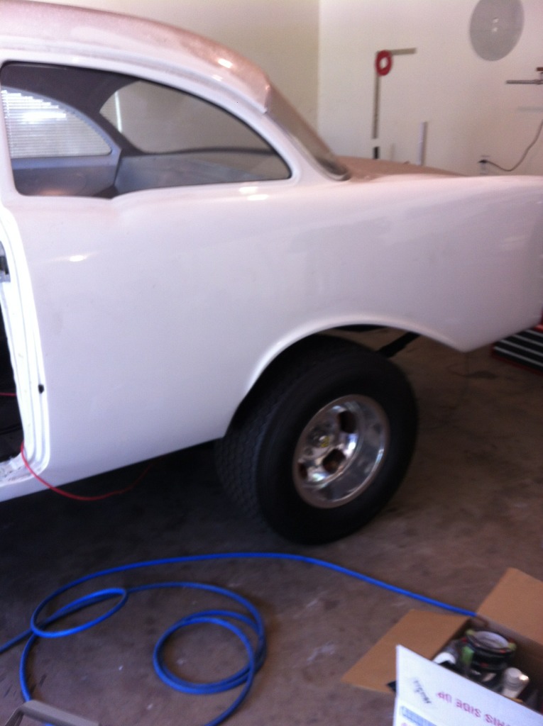

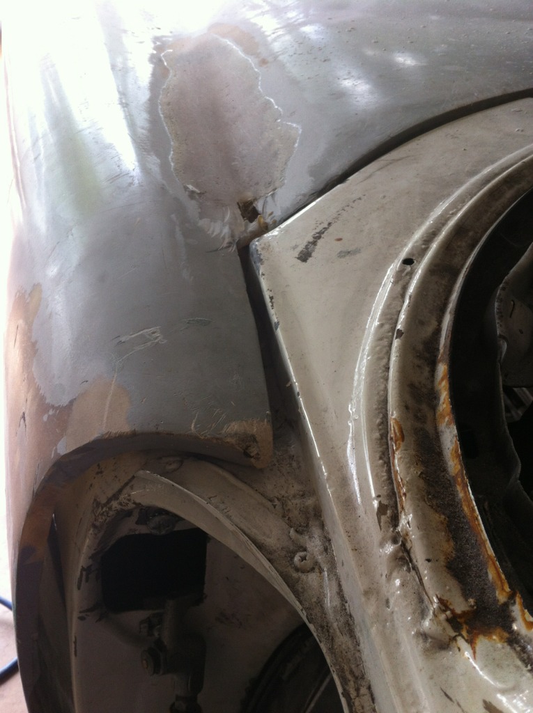

    Didn't use enough hardener on my first attempt and decided to try some bondo glass on it. Poppa like! Some people knock fiberglass ...so far I love the shit!
    I hope that if anybody takes anything from this thread it's that you can do anything if you put your mind to it. Don't let any of this stuff scare you guys that may be on the fence about doing it yourself. YouTube is you friend. Yes, there is some bad information there but there is also some awesome tech stuff on there as well. This shit ain't rocket surgery...get off yo azz!
    :D
    Still needs filler and sanding etc but I think it's satisfactory for now.
    Look at the misfitted fender my "body man" created for me. Nice! Gonna sand the valley back into it..recut it and hopefully make it purty..

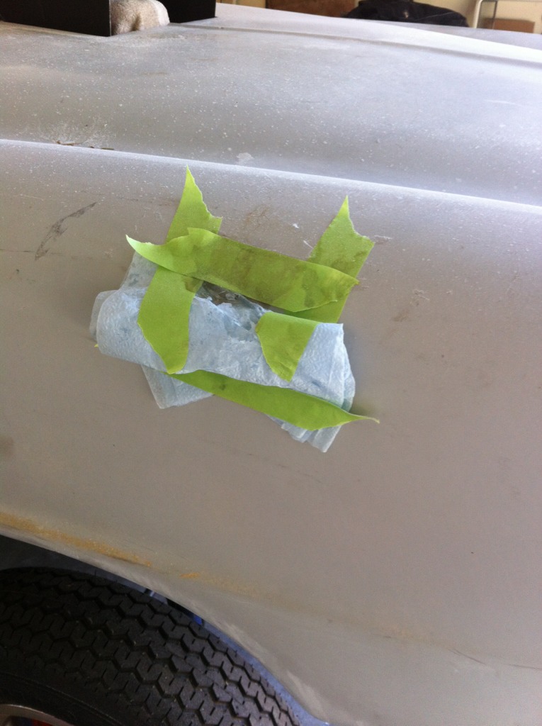

    Almost forgot patched hole on other side

    Doing this in real time today so if it blows up in my face you'll find out when I do! Haha! No mulligans.
    About 30 minutes from now we shall see..

    Hole on other side revisited with some
    Filler while liberty bell crack cures.
