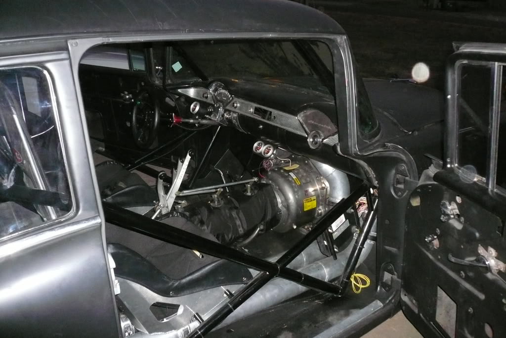

    No pics to post, but I'm back at it again. Solved my electricity outage (replaced cfgi outlet) and fortunately with the help of a very kind fellow at the local welding supply was able to fix my welder as well. For the past 6 years I have really used and abused my little Hobart Handler 140 mig. I'm not a pro by any stretch ,but for the money I think it's a nice little welder. Here is a nice tip for all you mig users out there that may not know this because I didn't. If you have a lot of metal dust in your shop it can collect inside your welder and really muck it up and short it out. Sometimes it can even totally fry it. I opened mine up and blew it out real well and it fired right back up. Welds a lot better now too.
    I should have the tunnel done by Saturday night, that is if I didn't cut it down too much since you saw it last. I didn't take the time to put the engine and tranny back in when I did this and fear it may not fit now. Getting pretty damn tired of taking the engine in and out, but I need to nip that. Not the end of world if I got overly enthusiastic with the cutoff wheel just more time involved. Hopefully my laziness won't bite me in the tookus. We shall see..
