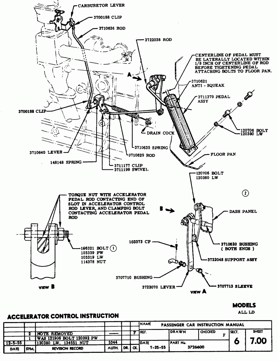

    I need a photo of the linkage etc for this carb.I bought a 56 wagon last weekend and parts are missing from the carb.Would be real helpful if anyone has a photo as I cant find any on the Web.
    Thanks Bob I think the carb is a rochester B or BV

    Does any one have a photo of complete linkage setup and where spring attaches on 56 chevy 235 6cyl. motor .Car has 3 speed stick.
    Thanks IN ADVANCE

    its in the pic i posted. it hooks to drain petcock. lower rear of engine.
