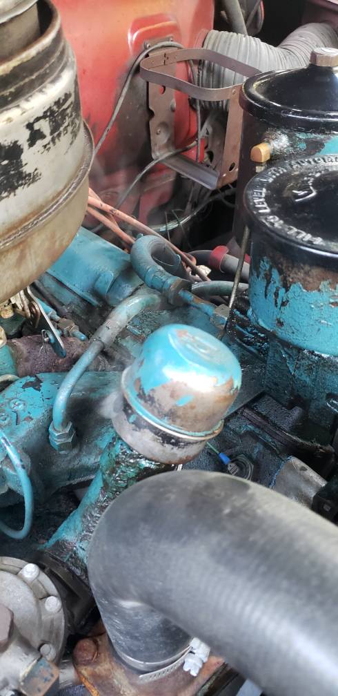

    I recently got my 56 cadillac back from the shop and they told me the engine was smoking a little. I didnt really think much of it as it often smokes a little when it starts then goes away but after driving it around for a few days the smoke has gotten really bad from the passenger side exhaust and from the crank case vent. I asume that it isnt makeing compression in one or more cylinders on that side and its causing smoke to leak into the crank case but I'm not the most experienced with cars so if anyone has ideas of what it is I'm open to it. It was in the shop cause after I rebuilt the carburetor it wouldnt run for more than 30 seconds and very badly I thought I did the carb wrong but they said it looked like 3 of the spark plugs had been dropped which I thought was strange cause I really dont think I did could this have anything to do with the smoke? Again if any of this seems stupid it's my first car and I dont know much about working on engines. Here are some pictures of the smoke from driving a few minutes ago. These pictures are at idle except for the one out the back window, the smoke is worse when driving. 20190707_185755.jpeg 20190707_190404.jpeg 20190707_190418.jpeg 20190707_190428.jpeg 20190707_190825.jpeg

    @56cadillackid ......What color is the smoke? Looks grayish in the pics, but that is not reliable on computer screens. If it is white or light gray, it could a coolant leak into the combustion chamber. If you are running ethylene glycol antifreeze, the smoke would likely have a 'sweet' smell to it.
    If the smoke has a blue coloration it is most likely engine oil. I don;t know if those old HydraMatics had a vacuum connection to the engine, as do many later mode;s, but if so, trans fluid could be getting into the intake system. These are just possibilities to look into. The compression test recommended is a greta place to start with your trouble shooting.
    If compression is low on most of the cylinders it is likely due to long term wear. The important thing there is how much variation between cylinders overall. If you have low(er) compression on two adjacent cylinders, that is an indication of a blown head gasket.
