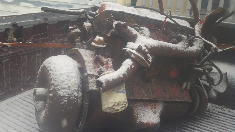

  7. Cub8556
    Joined: May 22, 2011
    Posts: 146
    Cub8556
    Pic reminds me to find a 3 bolt oil filter unit so I don't have to deal with the canister filters. Good luck Sbin, can't wait to see what you find on the tear down
  8. sbin
    Joined: Mar 30, 2011
    Posts: 100
    sbin
    Thank god for youtube.
    Was trying to tear down the 425 wife was adding to the honeydo list and crabbing about the "the ugly old rusty car I wasted money on"
    Put some videos of old Buicks on and after about 30 minutes she changed her tune and was asking how long till it was ready and making suggestions on color combinations.
    Was able to get the motor torn down today.Not as good as I would like but definitely buildable.
    The motor had water in a couple cylinders and will probably need bored.
    Will strip the heads and drop the block, crank and heads at the machine shop.

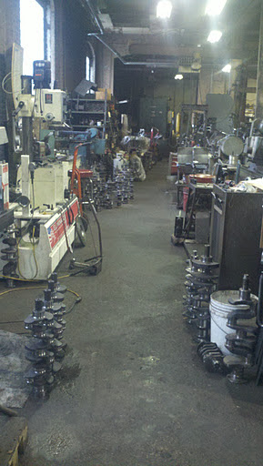

  11. sbin
    Posts: 100
    sbin
    Dropped the block and crank at the machine shop today.Spent a few hours standing around bullshiting with some old motorheads and the owner.
    Lots if cool stuff there everything from flatheads to a stroker crank for a +600 inch big block chevy drag motor.
    Hanging around a machine shop is a good way to spend a few hours on a snowy winter Saturday morning.
    The Nailhead crank is forged it will get straightened, ground and balanced.The block will be burned in an oven then hot tanked bored cam bearings and plugs installed.
    Tore down the heads will be cleaning up the ports with a die grinder today.
    Will post some pictures later.
  12. sbin
    Posts: 100
    sbin
    Metal Crankshaft Grinding is a great shop!
    The owner has been doing this since he got back from Vietnam in the 60's
    Really fortunate to have a guy like Pat to bring old American steel back to spec!
