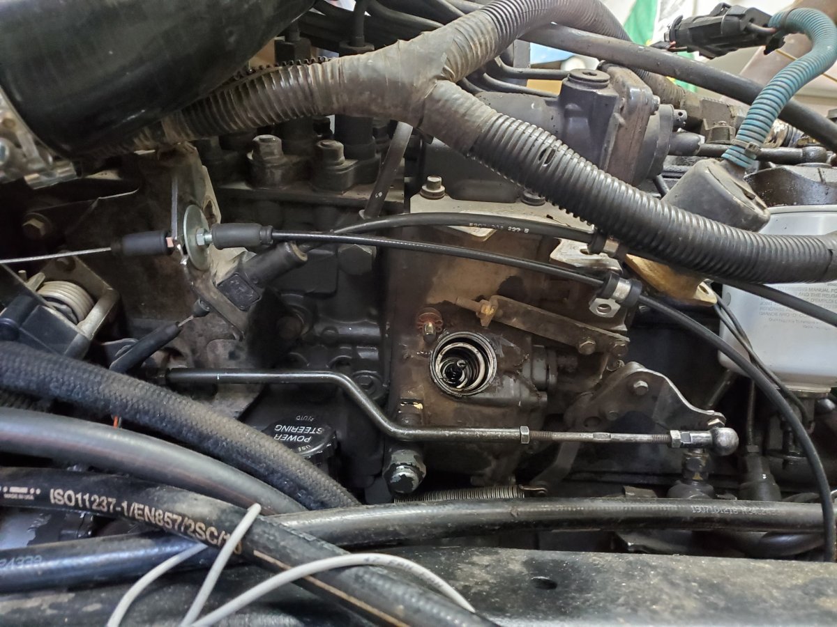

    Got the governor springs in to boost the fuel cut closer to 4000 rpms.
    They go in the little hole in the fuel pump at the center of the picture. A normal cummins de-fuels around 2800 rpm.

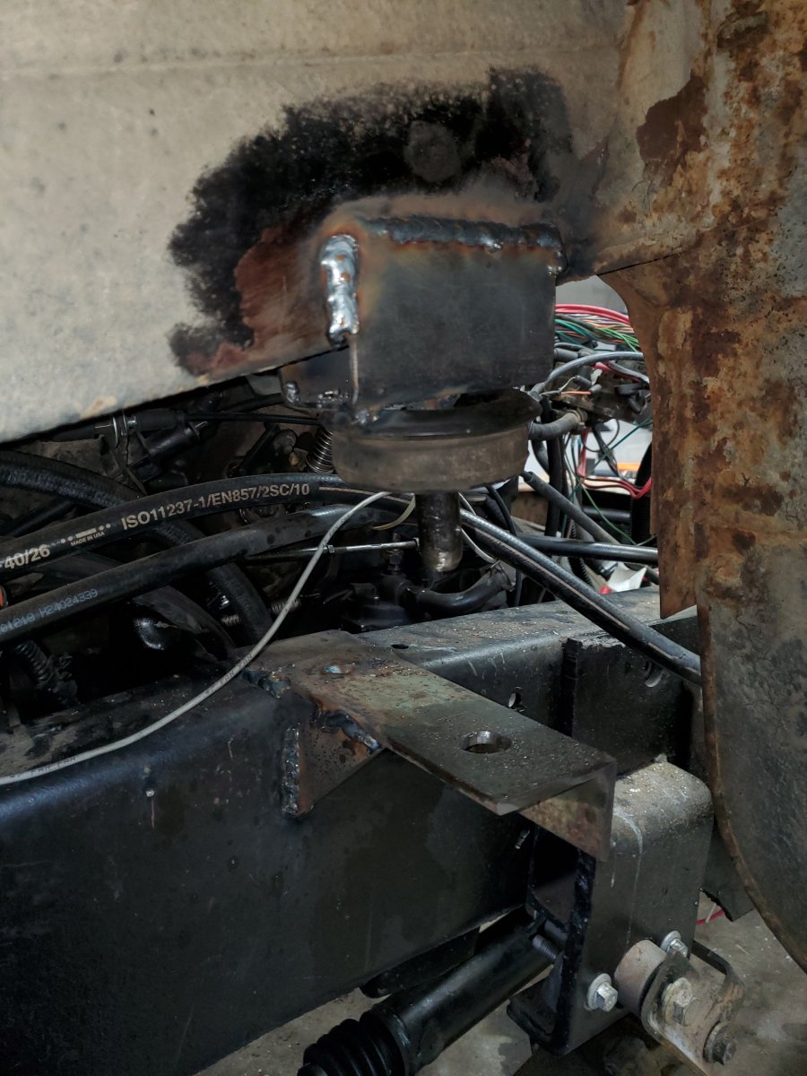

    Finally got the rear cab mounts done. Used a concrete form stake as a pin for alignment. Welded a Dodge body mount that's bonded to a washer as the rubber isolater.
    A hitch pin clip secures it to the mount. I will drill out the hole to handle a more robust keeper pin and add another rubber disc to the underside of the mount for additional cushioning. This is all accessed in the wheel well so it isn't out in the open. Pull two pins and start jacking to tilt the cab.
