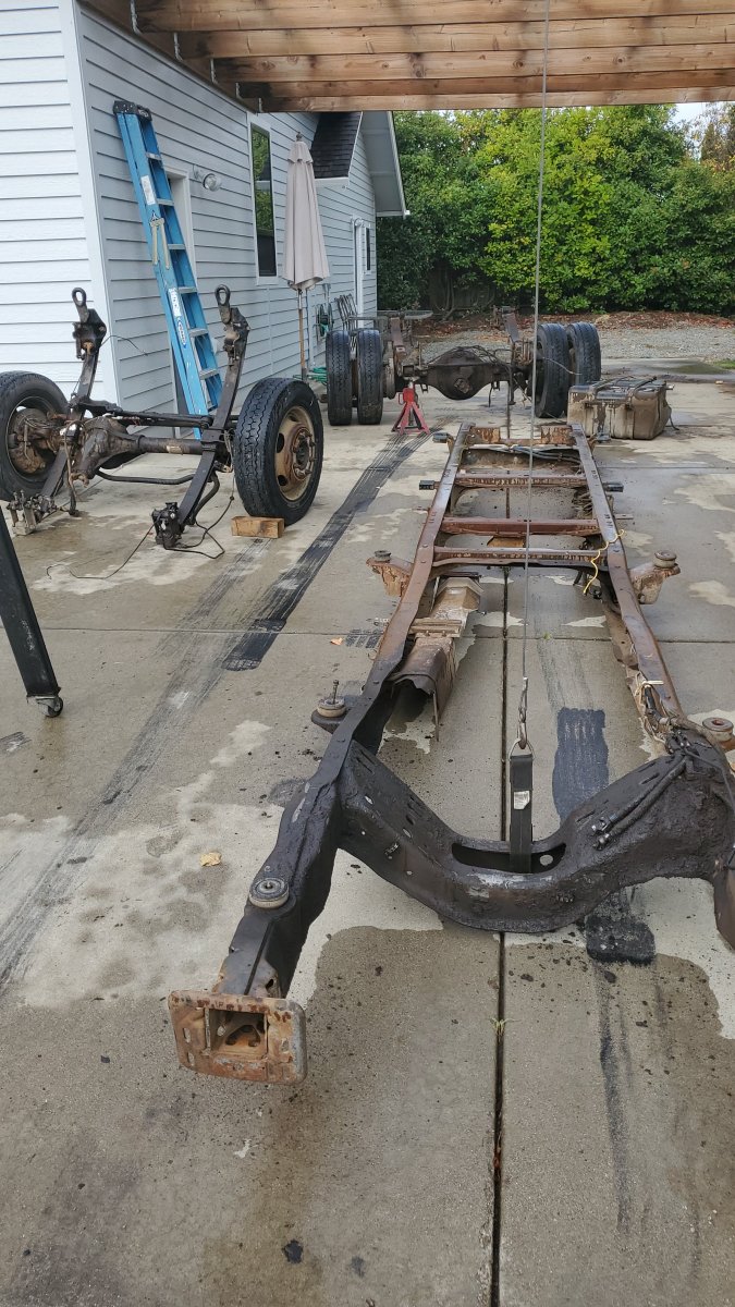

    I intend to drive the piss outta this thing up and down the west coast. That means totally modern drivetrain... found a 99 f550 4wd for a donor for $500. Not what you think... not doing a chassis swap.
    Removed the important parts. Did I mention I'm a 4wd kinda guy? I live in the heart of the Cascades, barn finds and vehicle purchases often involve mud, dirt, snow and lots of fun!
    The cool thing about the f550 is all of the mounts for the axles unbolt... another cool thing is that the rear frame width is IDENTICAL to the White frame. Who da thunk?
    By swapping to these axles we gain: 19.5" medium duty tires and rims, 4 wheel disc brakes, freeway gears, reasonable leaf spring pack, limited slip, 4wd obviously and easily replaced parts.
    Out with the old in with the new.
    Did I mention it was the EXACT SAME WIDTH! Used one of the old hanger bolt holes for each side for the front mount so no measuring or guessing involved.

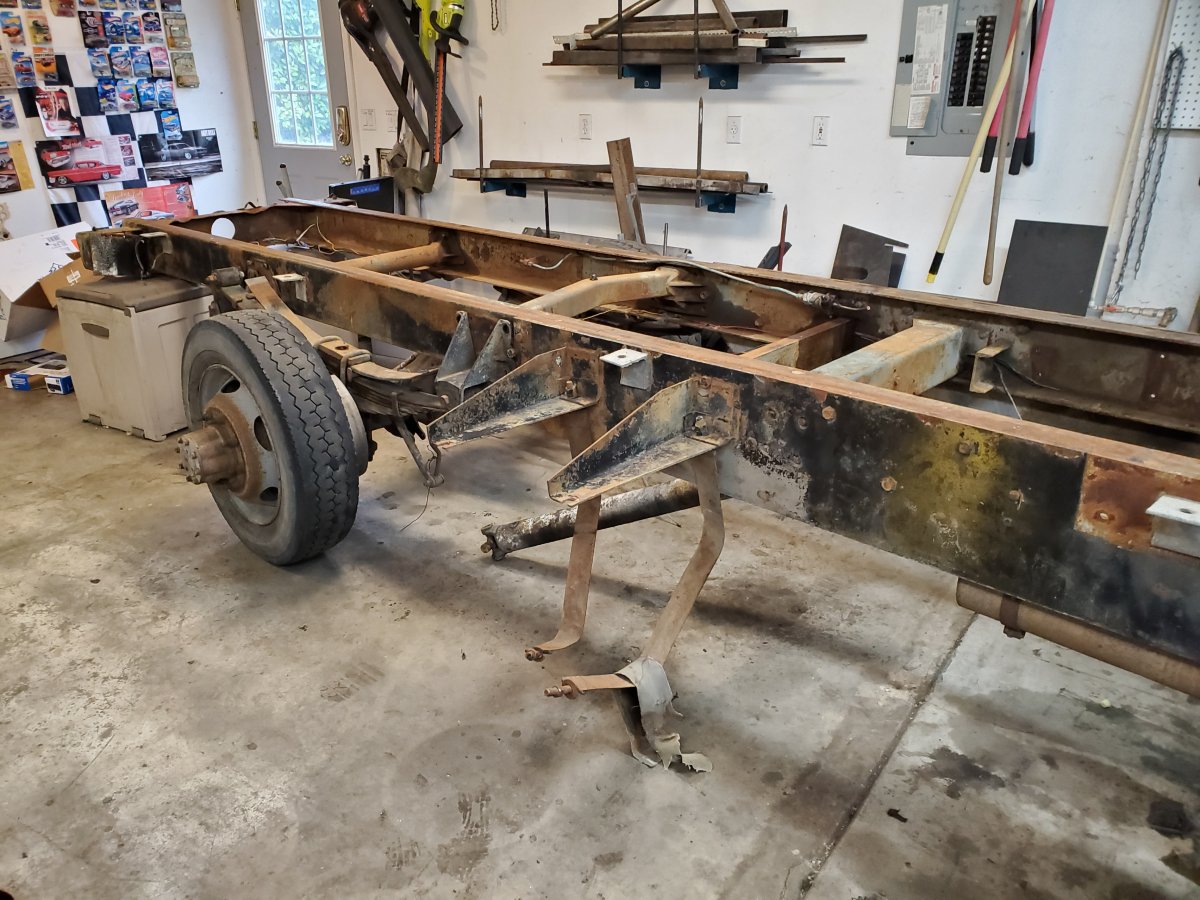

    Decided to yank the old flathead 6 before tackling the front axle. Cool old engine but 125 hp and no overdrive ain't gonna cut it. Pulled the trans first so I didnt break my cherry picker in half.
    Then out with the old lump. Did I mention this thing weighs 2 crap tons! That's a lot of crap!

    Not sure why but I don't have any pictures of the front axle going under. It was SUPER sketchy. Used two high lift jacks and the chain hoist dangling from the ceiling. The mounts for the axle aren't completely done but the main components are done and intact enough to hold the weight of the truck. Gonna have to add a few add a leafs to the front. It's way too soft.
    One bummer is how inset the front tires are. Lost about 3" of height compared to the old 20" rims and tires. May need to get some custom rims with no offset. Unfortunately the early years of super duty are a super oddball 8 lug pattern. Bigger than a f350 and only used for 4 years or so. Probably need to get some bigger 19.5 tires too. These are a 225 I believe, would love to move up to a 265.

    Donor truck died yesterday! Believe it or not the Cummins doesn't weigh nearly as much as the flathead 6 we took out of the white.
    Engine in foreground, trans and transfer case by the front wheel of the truck, warn 12k getting a rebuild for the flat deck sitting on a stand by the garage door.
    Pile of parts to reuse. Trans mounts, exhaust, brake master cylinder and booster, front and read driveshafts... this thing was a gold mine!
    And in the dumb redneck department
    .... I had to steer the donor dodge around the butt of the White while pulling it with my buddy's truck. All of a sudden it picked up a bunch of speed and took off down the driveway passing me by. It narrowly missed the bed of my buddy's truck, missed grandmas fence and crashed into the bushes while I ran after it. I went from "oh $hit!!!!" to laughing hysterically. Time to get the White back in the shop!
