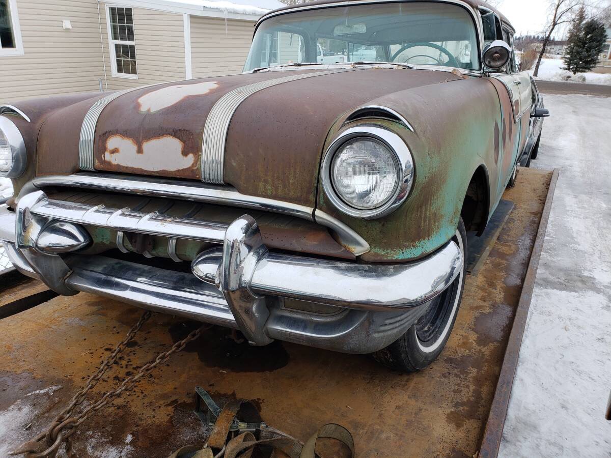

    1955 Pontiac Safari- I purchased it from a guy in Idaho & has it shipped to me. It came with the original numbers matching motor that was torn apart into a million pieces & no trans. Here are some pics. [​IMG][​IMG][​IMG][​IMG][​IMG][​IMG][​IMG][​IMG]www.jalopyjournal.com/mobile-gallery/65ba4e7157495543ecdc1f33408d1a7b.jpg[/IMG][​IMG][​IMG]

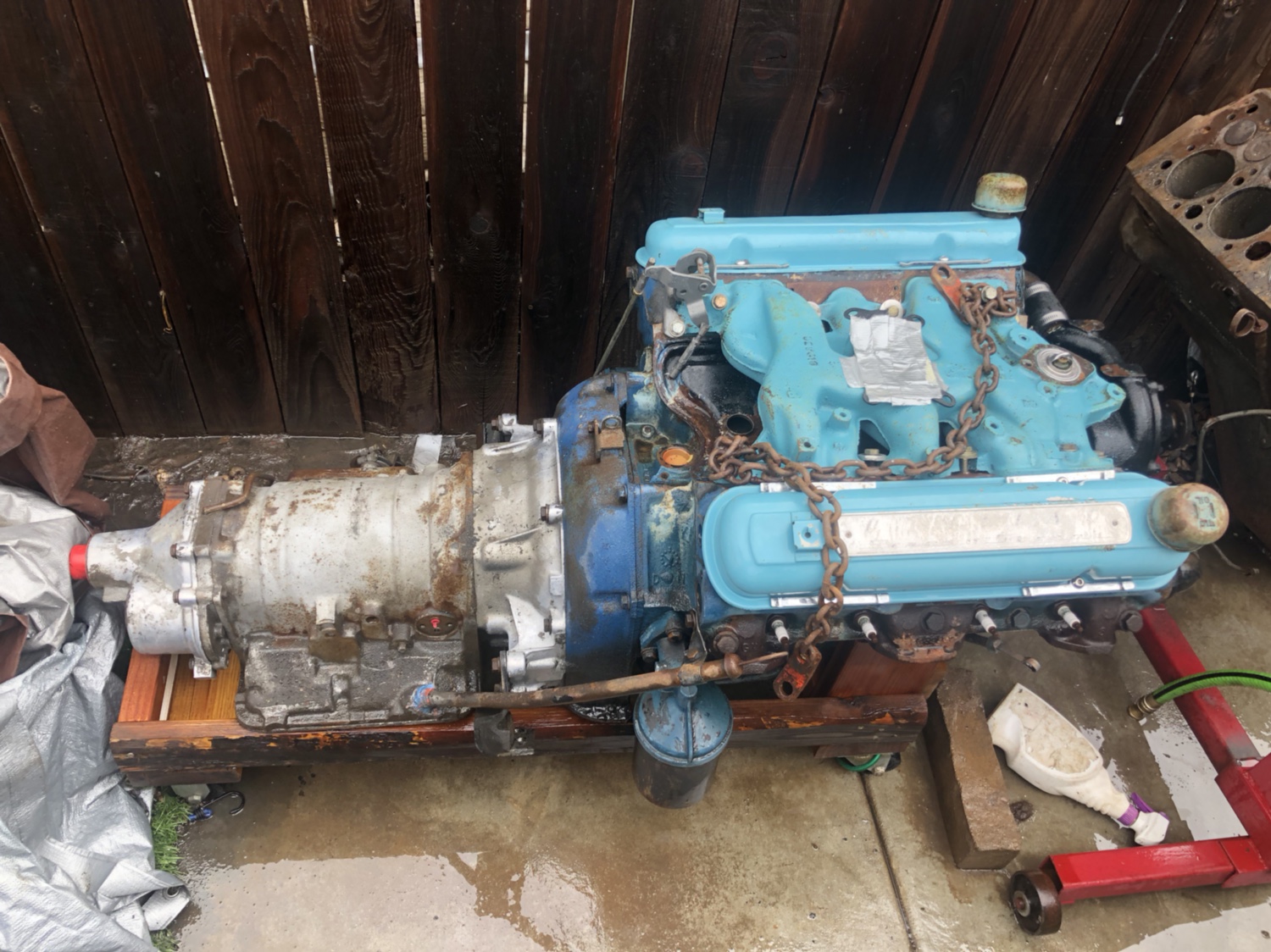

    “The Motor& Trans” I have a running/working 1957 Pontiac 347 with Hydramatic attached.

    -My first question. I know this motor should more or less bolt right in, but I don’t have any original motor mounts that came with the car or motor. Does the front mount require 1 or 2 mounts & what does it/they look like. Also what rear trans/motor mounts should I get & what do they look like. Pics would be great. I’ve looked all over the internet & there’s a lot of different styles that pop up when I look for them & I’d like to get the right ones.

    The front mounts are on the bottom of the timing cover. 2 bolts. I have attached a photo of a 55 cross member. If you use the 57 motor and trans you will use the same mounts however the drive shaft won't fit. Also, just an opinion but this sight is much better than Ames for older stuff.
