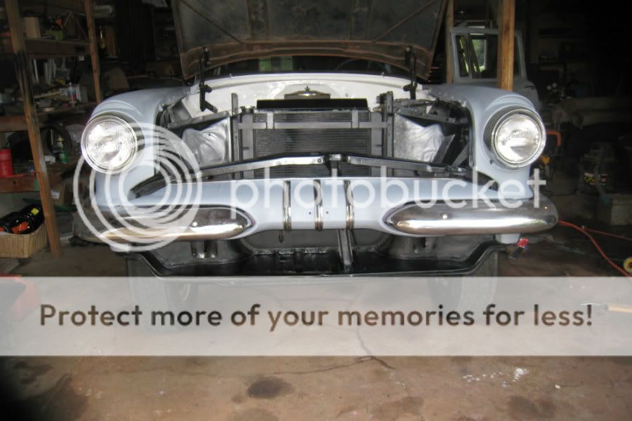

    I got the front end finished up and primed for now to match the rest of the car, what do you guys think of the bumper treatment? I made a shield for the top of the radiator also, caught my finger a little one time I tried putting the cap on.
    I finally got the brakes straightened out, the old factory proportioning valve for the dodge mc I was using wouldn't let me bleed it properly. I picked the dodge mc because it was similar to the Wilwood but 1/4 the price and all new. I added in residual valves for front and rear and an adjustable proportioning valve.
