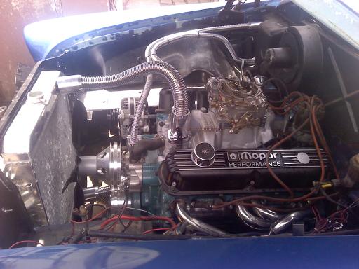

    Finally got to get to this project. So far have installed a 318 automatic and 8 3/4 rear from a 67 Satellite. The engine was rebuilt prior to install and we found a pair of headers from a dakota pickup that cleared all the steering mechanisms and fit well. Exhaust is being mocked up. Twin pipes out the back look great and will get some chrome pencil tips down the road.
    Next will be the wiring conversion to 12 volt along with all new fuel and brake lines.

  4. Those are nice cars and the '67 318 practically falls right in place. Looks like a very good project.

    Anyone looking to build a 55-56 Mopar project should definitely look for a 67 Mopar B body because as said above the 318 is a great drop in and the 8 3/4 rear almost bolts in - just move the spring perch. Thanks all!!!

    The header find is really the good news. Can you post a few detail pics of them ??
  11. Munster Motors
    Joined: Jan 23, 2012
    Posts: 457
    Munster Motors
    i put a set on my 56 ply. has a 76 318/904 in it.
    dodge dakota durango headers fit better than block huggers

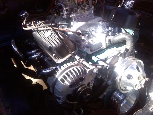

    No pictures but - WE HAVE IGNITION!!!!!
    Satred her up for the first time and she took a short maiden voyage around the block (no plates, no brake lights, no hood, no....) Sure felt good to hear her run and this is the first time since 1970 that this car drove on a road. Very cool. Still sorting out all the little electrical details for the 6 volt to 12 volt conversion but should be on the road driving by the 4th of July if not sooner. Car runs great and sounds great with full dual exhaust with glass pack mufflers in the stock muffler location. Nice mellow tone. After the electric is sorted I will start cleanin the interior and looking at seat options/upholstery as well as doing some rust prevention on the underside and frame rails. More to come.

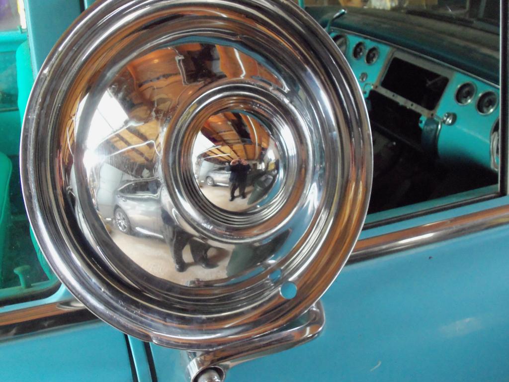

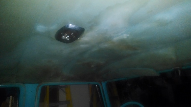

    I just recently got some new mirrors for the doors and am waiting for material samples to start the seats.
