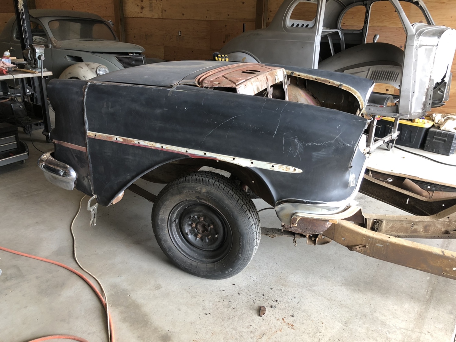

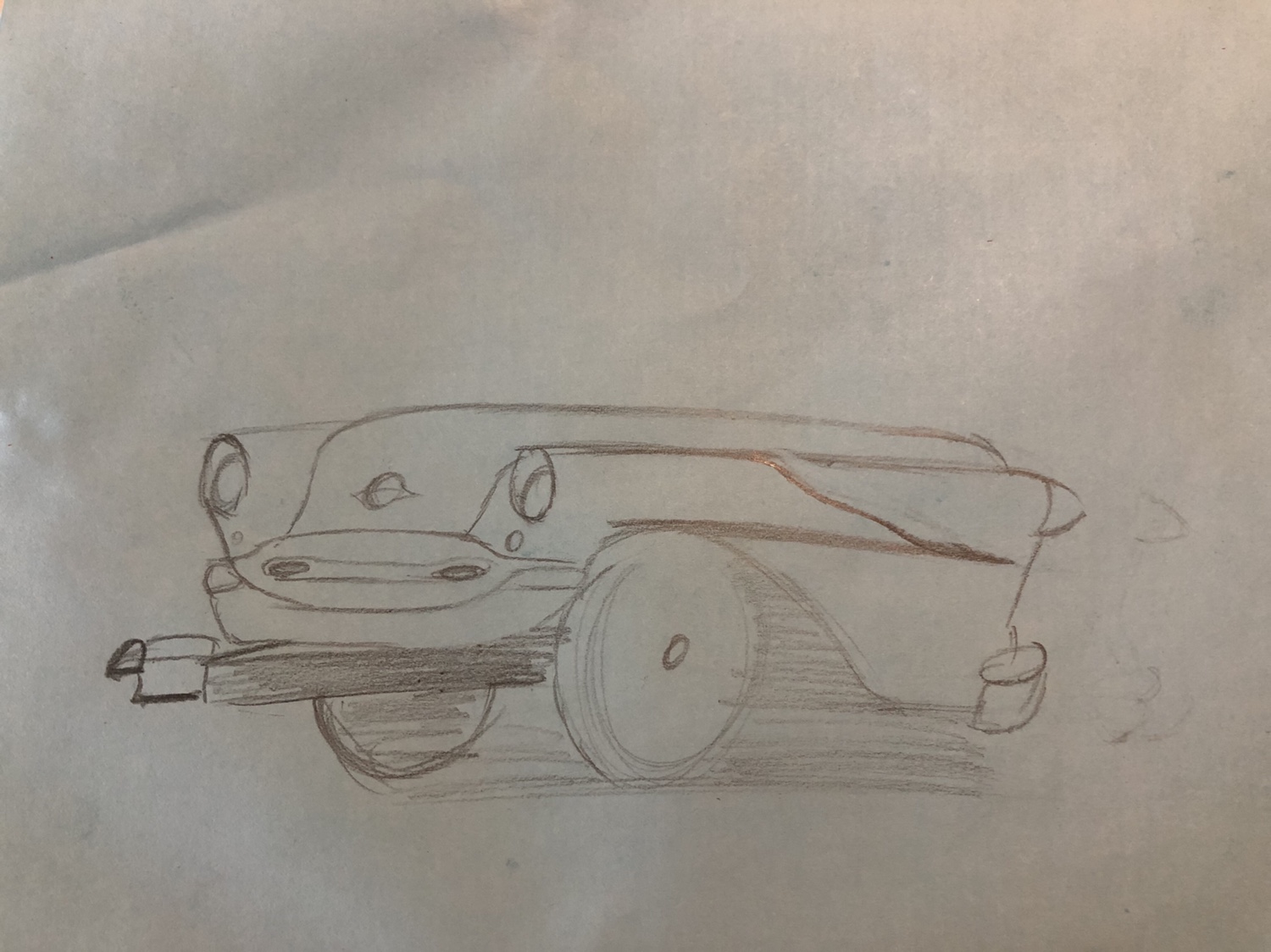

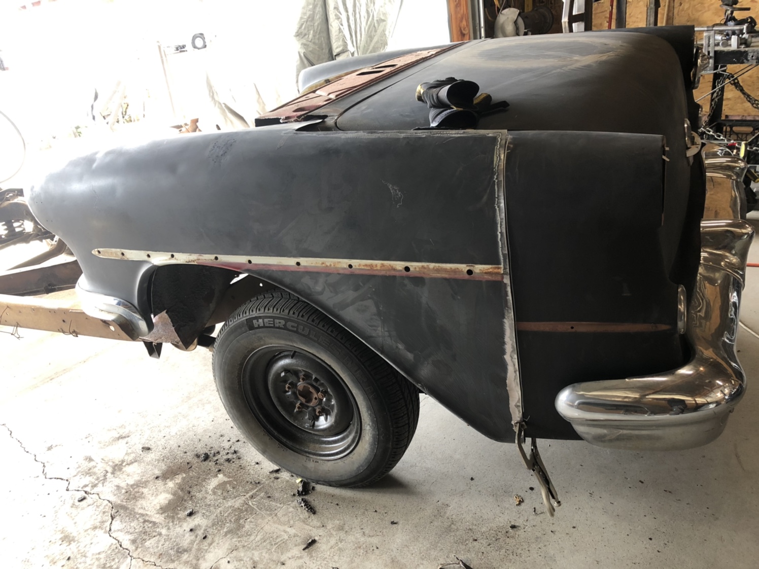

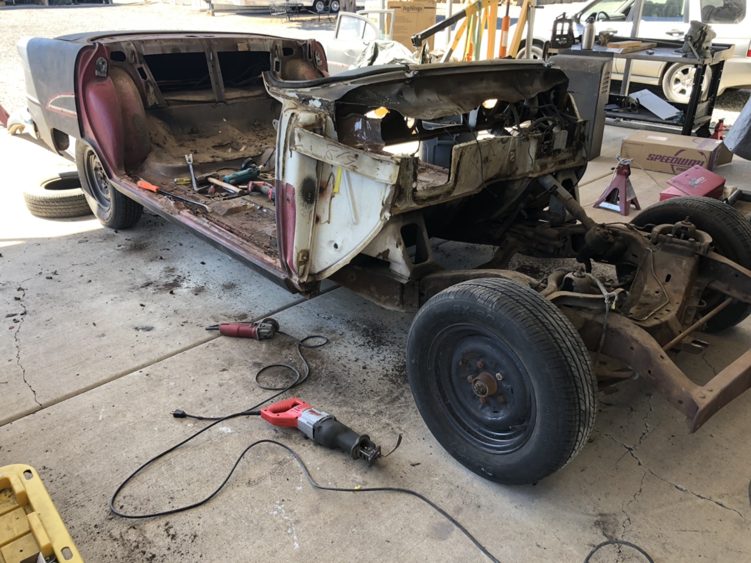

    So I’ll keep it quick and simple. I have a customer come to me that has a two door 55 olds and a parts car 4 door and he wanted to do something silly and cool to be different at local gather ups. So we came up with this. Kind of a silly trailer hover car looking thing. Basically two identical cars just one is a trailer, the plus side for me is I’m in the middle of starting my 48 olds futuramic 98 and a lot of the parts are interchangeable or an upgrade so that’s a huge plus! Basically cut up and car and made something kinda cool. I honestly hated the idea until it came to life and then I was pleasantly surprised with how it all mapped out. The X member will be perfect for the hitch too once it’s dropped 6”. I plan on adding a big 1/4 x 3 square tube to the front in a T to add strength and tongue weigh. Hope y’all dig it.

    Lots of work ,looks cool.Dig the fastback.
  5. BuckeyeBuicks
    Joined: Jan 4, 2010
    Posts: 2,498
    BuckeyeBuicks
    from ohio
    I find it interesting, it will look great with the matching 55 Olds 2 door pulling it down the road.
    VANDENPLAS likes this.
  6. wulf powis
    Joined: Jun 19, 2017
    Posts: 64
    wulf powis
    Pretty cool, are you considering reversing the trunk lid hinges to give a full box for the trailer?
    Thats a great idea, look forward to seeing the finished product.
    mouse action likes this.
  7. pigIRON63
    Joined: Nov 25, 2019
    Posts: 434
    pigIRON63
    Gonna make an awesome trailer, would look good with a suicide hood and trunk,
