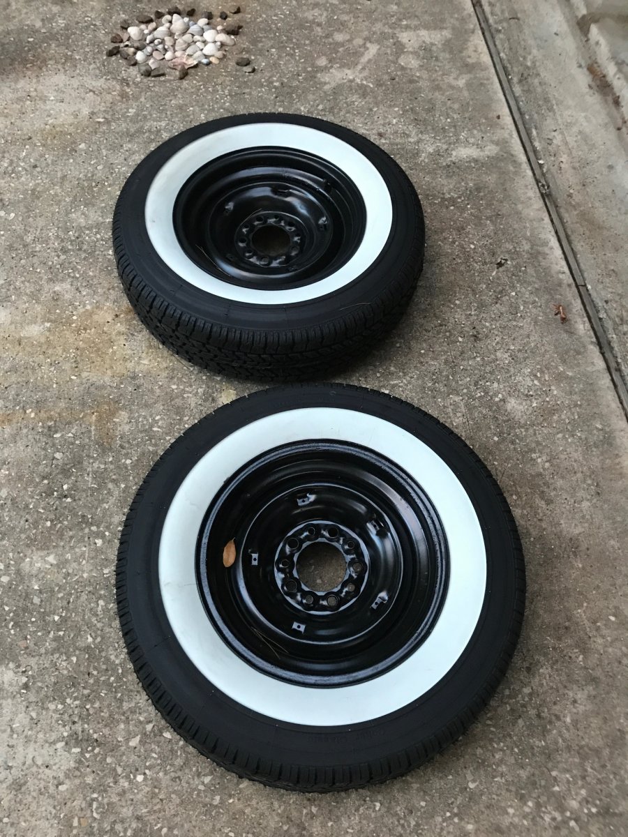

    sand blasted the rims, fresh coat of spray paint, and picked up some coker white walls
  11. OK, now put 'em on and lets see a pic of them installed! :)
    hans mercman likes this.

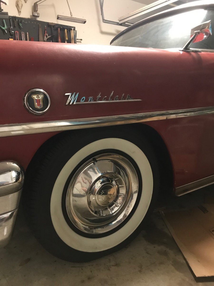

    I was getting there! ;)
    Best shots i could pull off in the garage, will get some more soon.
  14. Yea man! That looks sweet. :)
