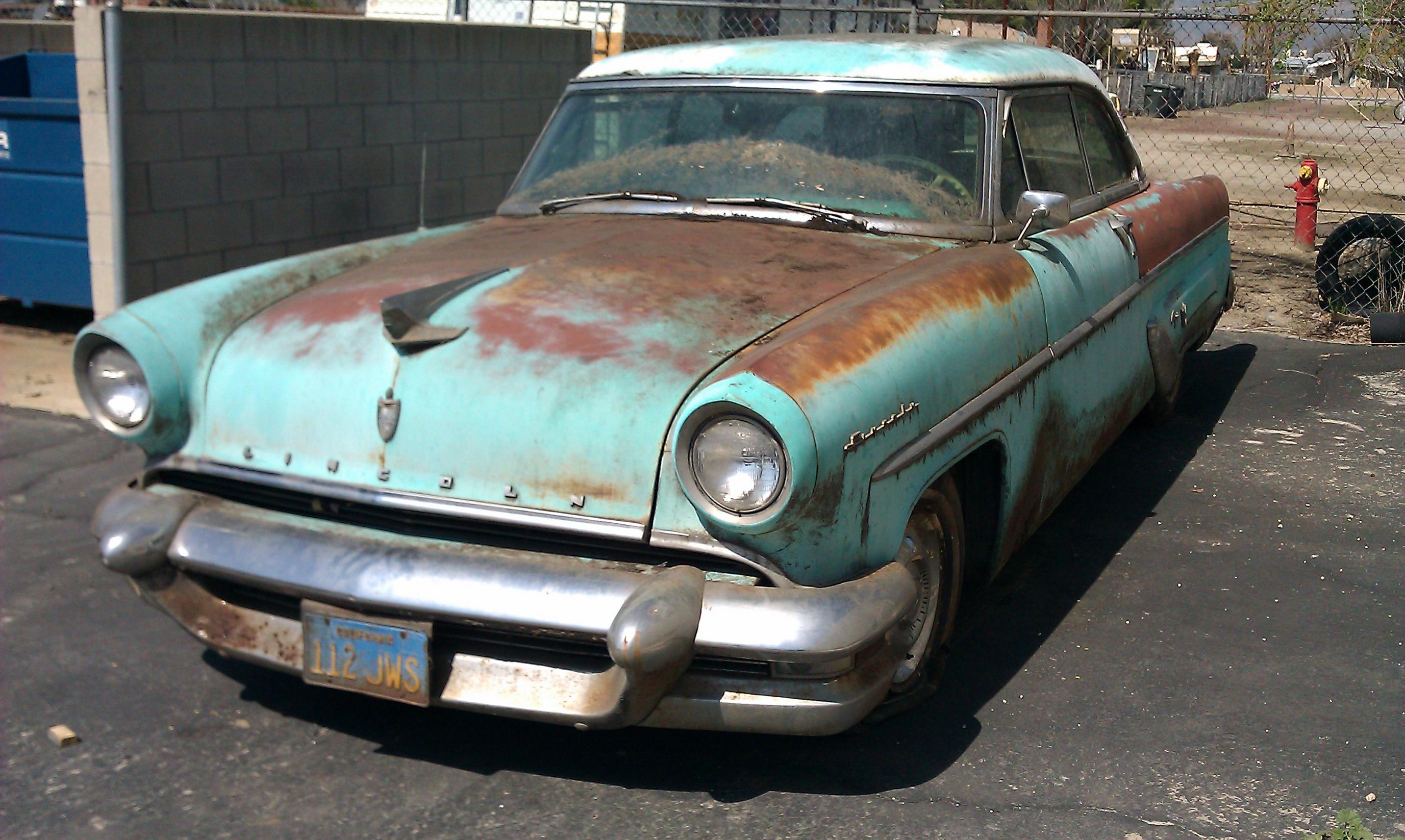

A friend has this i might want it but its a big job any pics of 55 lincolns done up? I only now of one the pink one and it rules. I would also chop it and put a contenintal kit on it. Should i go for it? I miss my 55 pontiac this would be a great cruiser. Billy
close if not the same year not sure but it is a lincoln a lot like that one i love them and would say go for it
These are great looking cars in my opinion. Looks like a nice project, but like a few have said before, lose the ck........

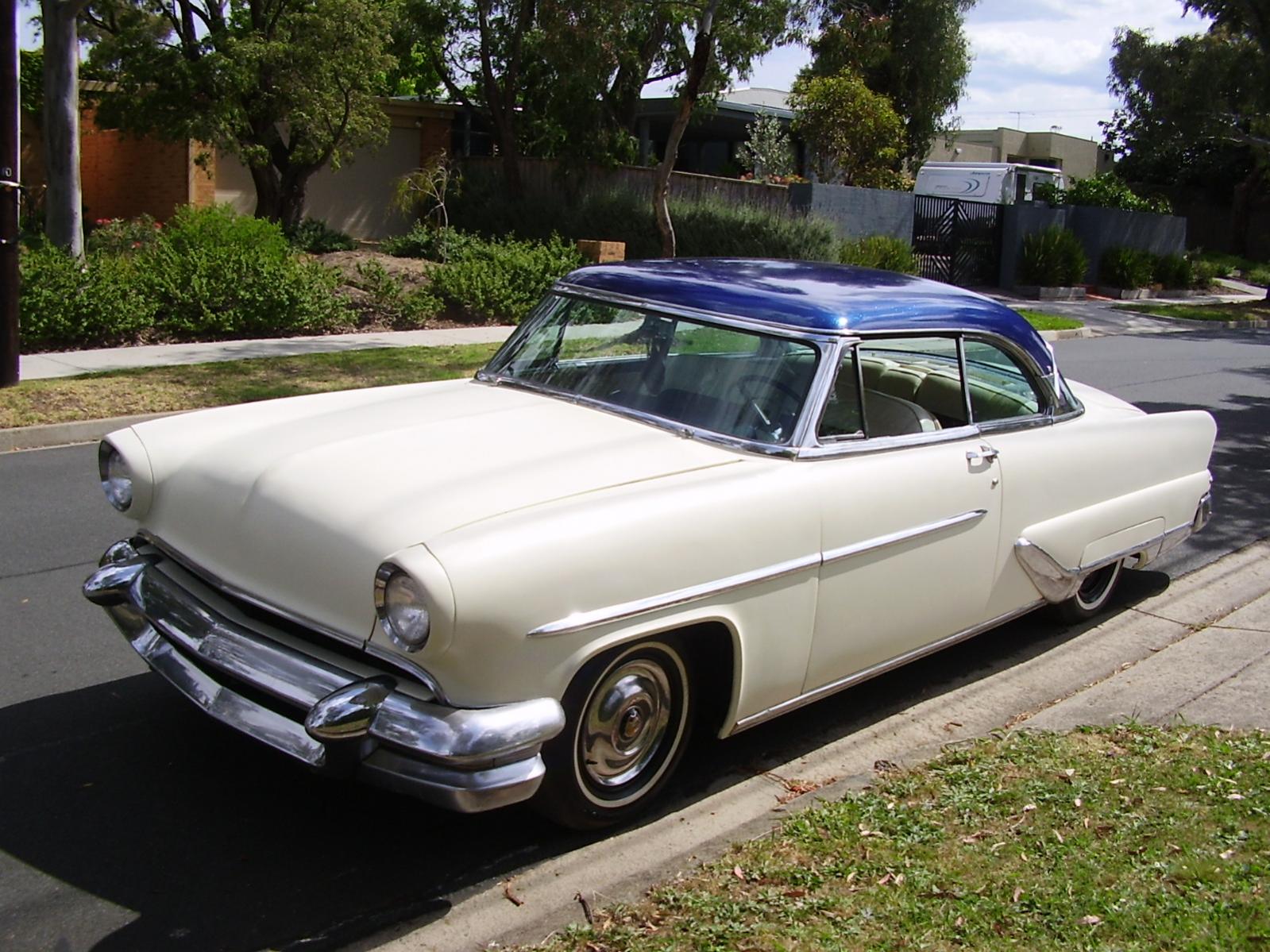

'55 Lincoln's make great customs...they were luxury cars, so lots of factory options, beautiful lines, long as hell, and tons of chrome and stainless. This is my buddy's old one......he misses the shit out of it... Bryan

now do i it keep the stock motor or swap it out? it jumped time in 86 and parked and it was a beatiful car when parked and then got negleted and is what you see now. sad. any thoughts on fixing the stock motor i think it can be brought back from the dead. billy

Here is a very mild one I did a few years ago. Just took all the crap off it and made the side trim stop at the door, makes the back look a little stronger IMO. They are really long, make sure you have room before you get it. I put a 351C in it, it was a real squeeze around the steering box. The steering box's are monsters! The C piller is about the only thing to really think about if your going to chop it!
