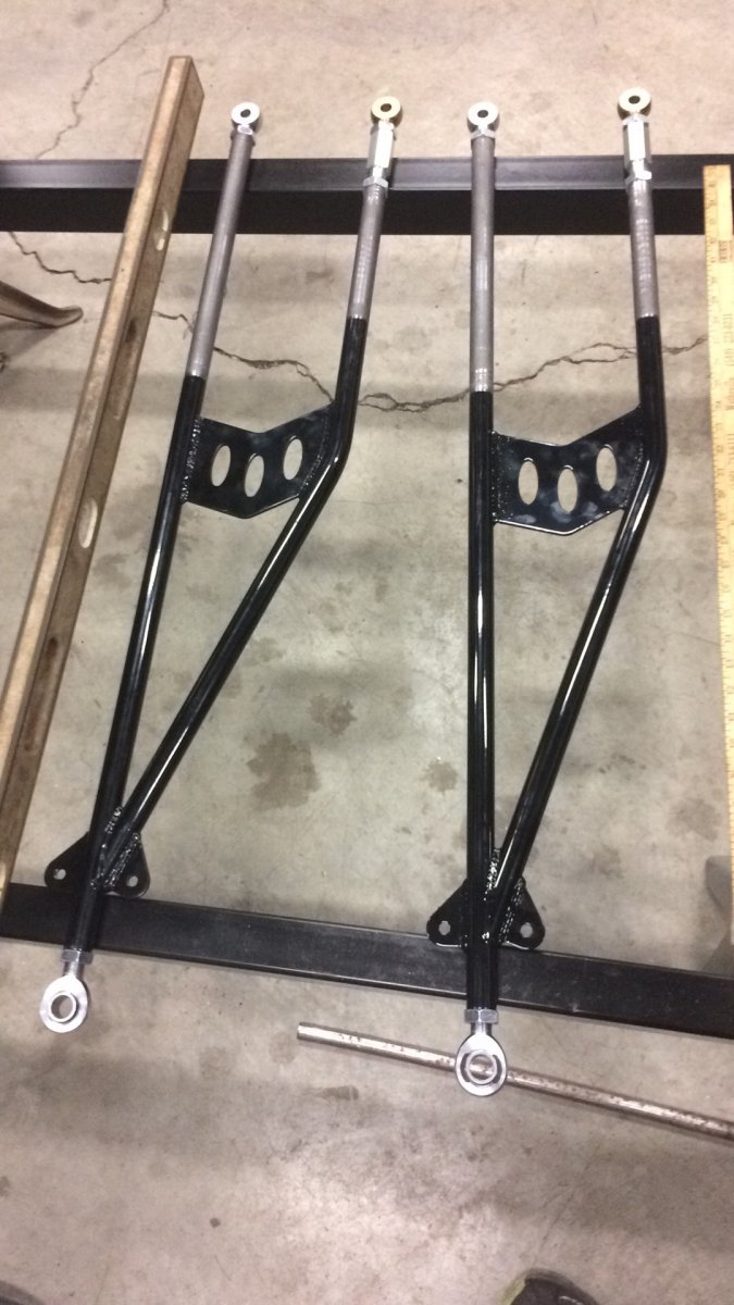

    IMG_1268.JPG IMG_1281.JPG IMG_1267.JPG IMG_1264.JPG Dad machined the ladder bar extensions and got them done, yesterday. And we got pretty far tonight. Gonna cut the ladder bar crossmember tomorrow and get it tacked in, and get the ladder bars tacked on. Dad had to mill the ladder bar mounts for the rear end housing where it's a bigger axle tube truck housing. Nothing ever just sticks on.
  3. How long are your bars?
  4. Zak Hall
    Joined: May 11, 2015
    Posts: 390
    Zak Hall
    43" in honor of The King.
  5. I guess I'll have to do at least 44!
  6. Zak Hall
    Posts: 390
    Zak Hall
    Haha! 42" is the minimum.
  7. Why would you want the minimum? I thought the longer was better for bite? Mine are 48 on the Cuda.
  8. Zak Hall
    Posts: 390
    Zak Hall
    There's a lot of different theories, Quain's are 50" I think.
  9. If you add the brackets, mine are 50 from the center of the rod end to the center of the axle housing. I'm sure it has something to do with horsepower. I'd think the lower the power, the shorter the bars. Takes more power to lift with a long arm compared to a short arm. What do you think?
  10. Zak Hall
    Posts: 390
    Zak Hall
    That's my theory too. Light car or high power, long bars. Heavy car or low power, shorter bars

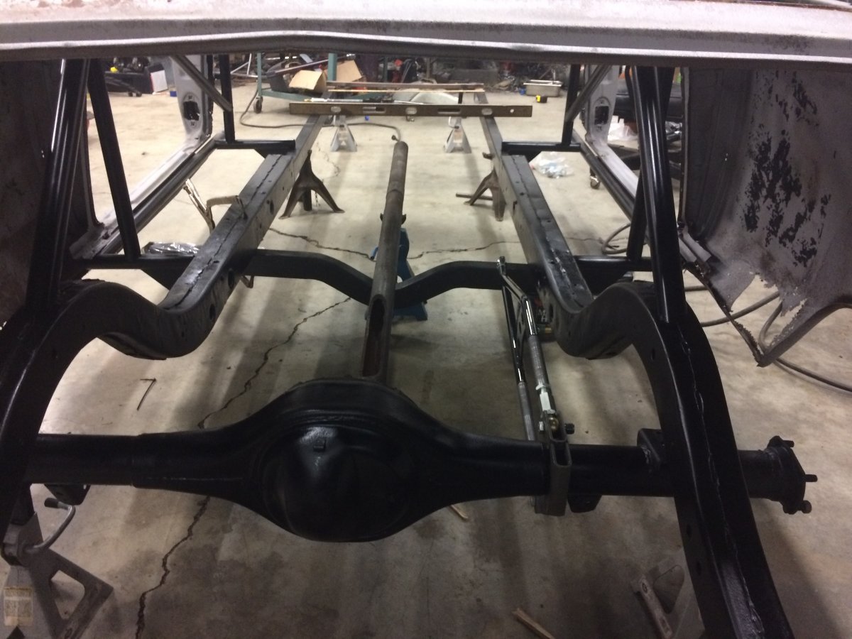

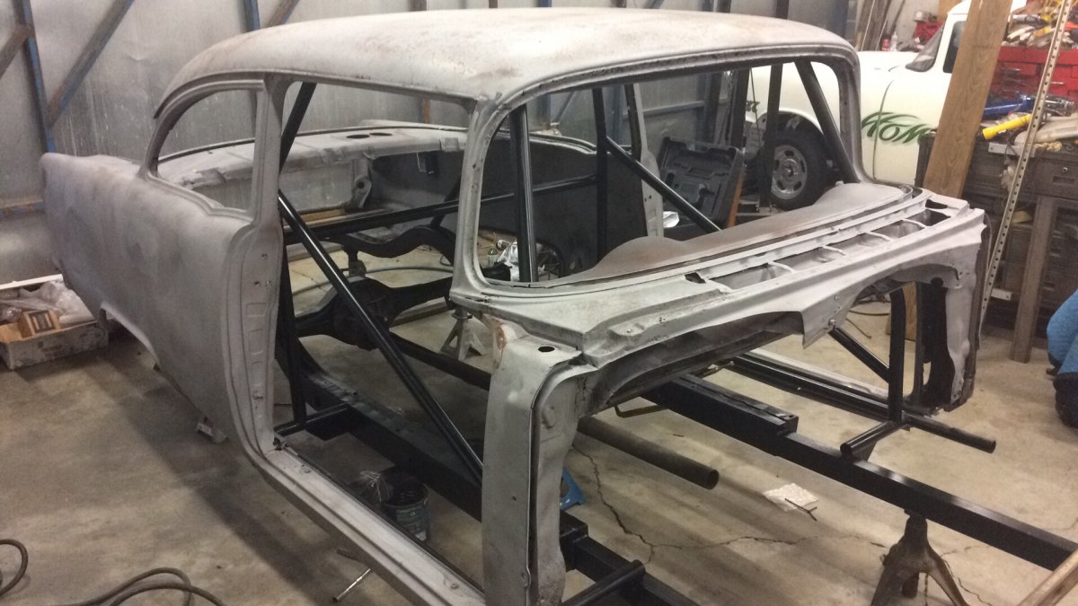

    IMG_1464.JPG IMG_1466.JPG IMG_1467.JPG IMG_1468.JPG Well the ladder bar crossmember is in, the ladderbar brackets are welded, and the housing brackets are on. It's fighting every step of the way but we're making progress.
