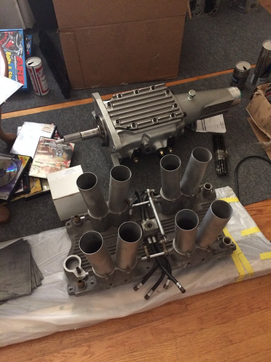

    IMG_8738.JPG Jerico dr4, he's already got the transmission from Bob Treadway.

    I see 200 lbs off the car setting on the bench beside the transmission.

    That's in the living room, gotta keep the good parts inside. Lol
  15. Zak Hall
    Joined: May 11, 2015
    Posts: 550
    Zak Hall
    That's the overflow!

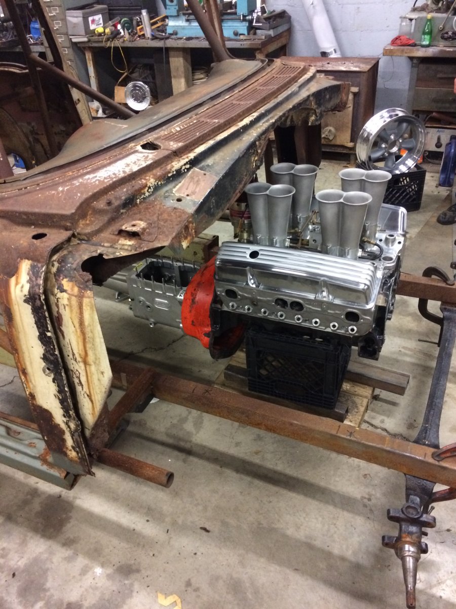

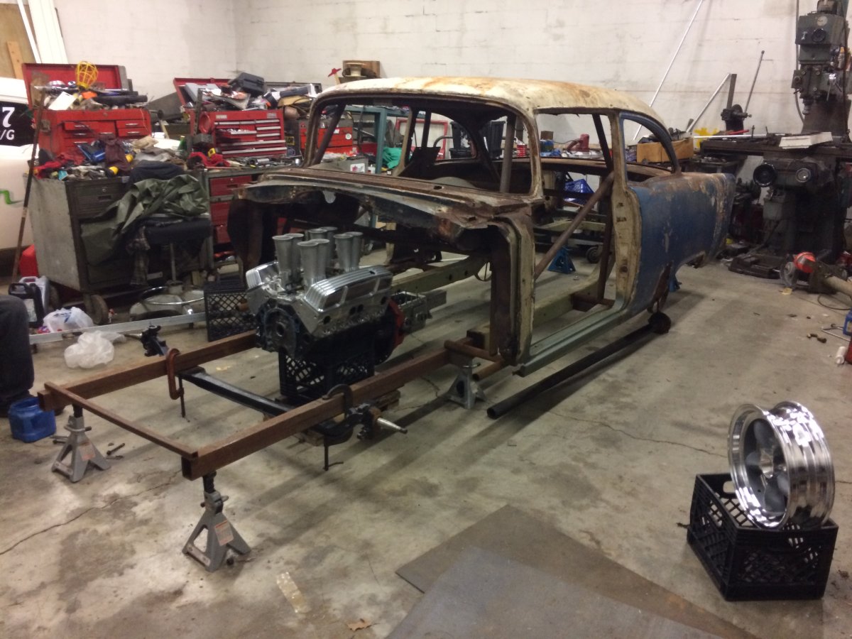

    Mocking up dads car. 10% engine setback, enderle injection, magneto, and 301ci of SBC. I think this is gonna be a killer car for him. Excited to start on it.

    IMG_0843.JPG Got the front tires mounted today. Gotta pick up some parts from Ron Pope Thursday so we can start putting the front axle under it
