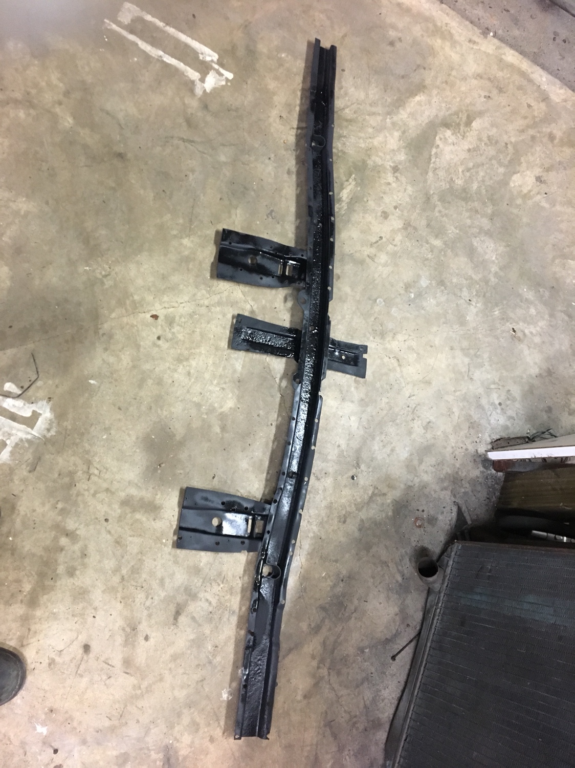

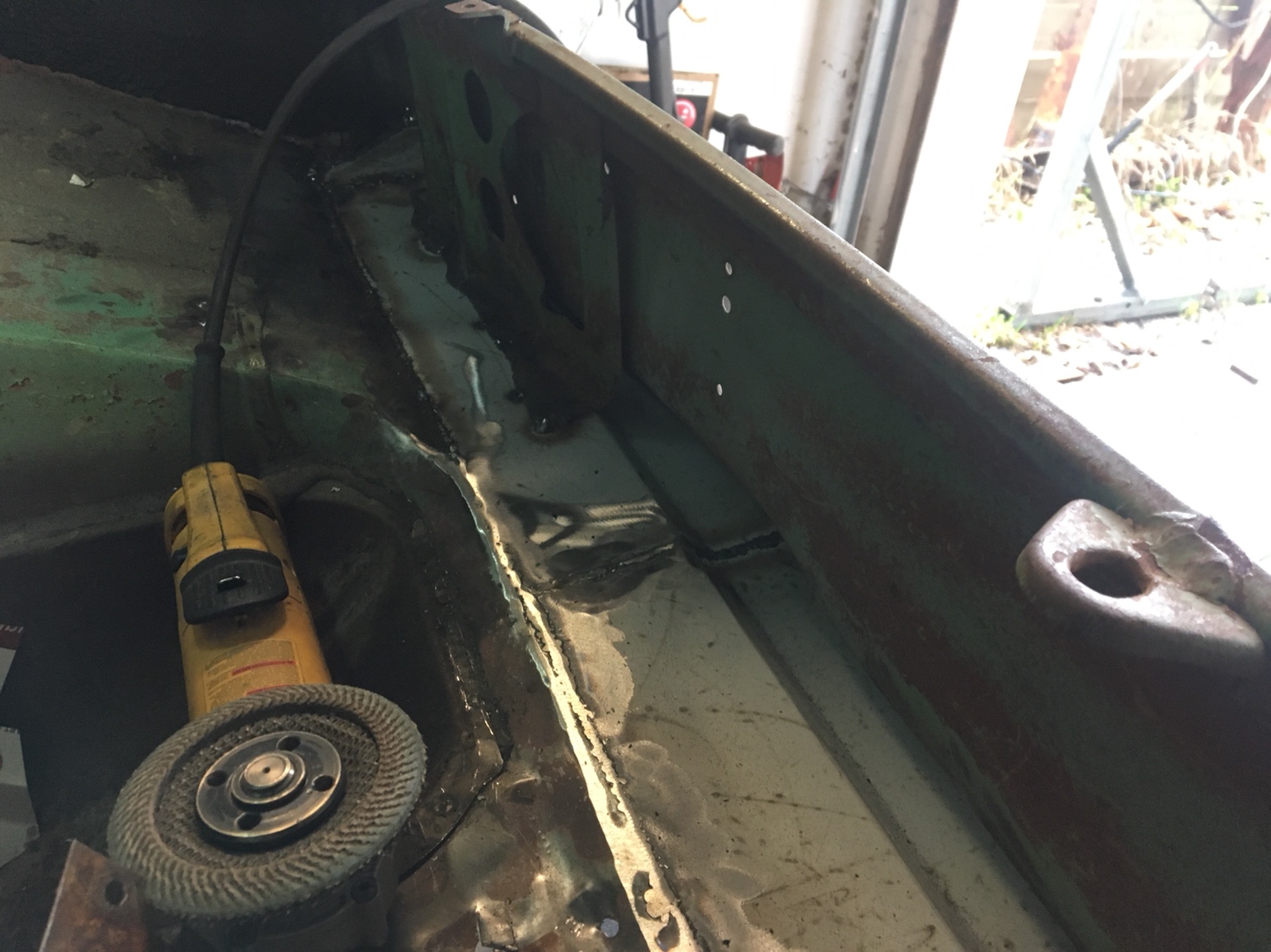

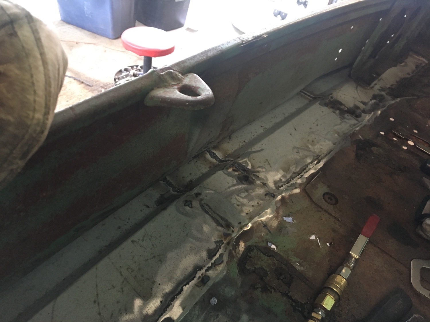

    I've finally finished the patch in the trunk area and put the rear channel support back on. Once I cover this all with undercoating I think it'll look pretty good.

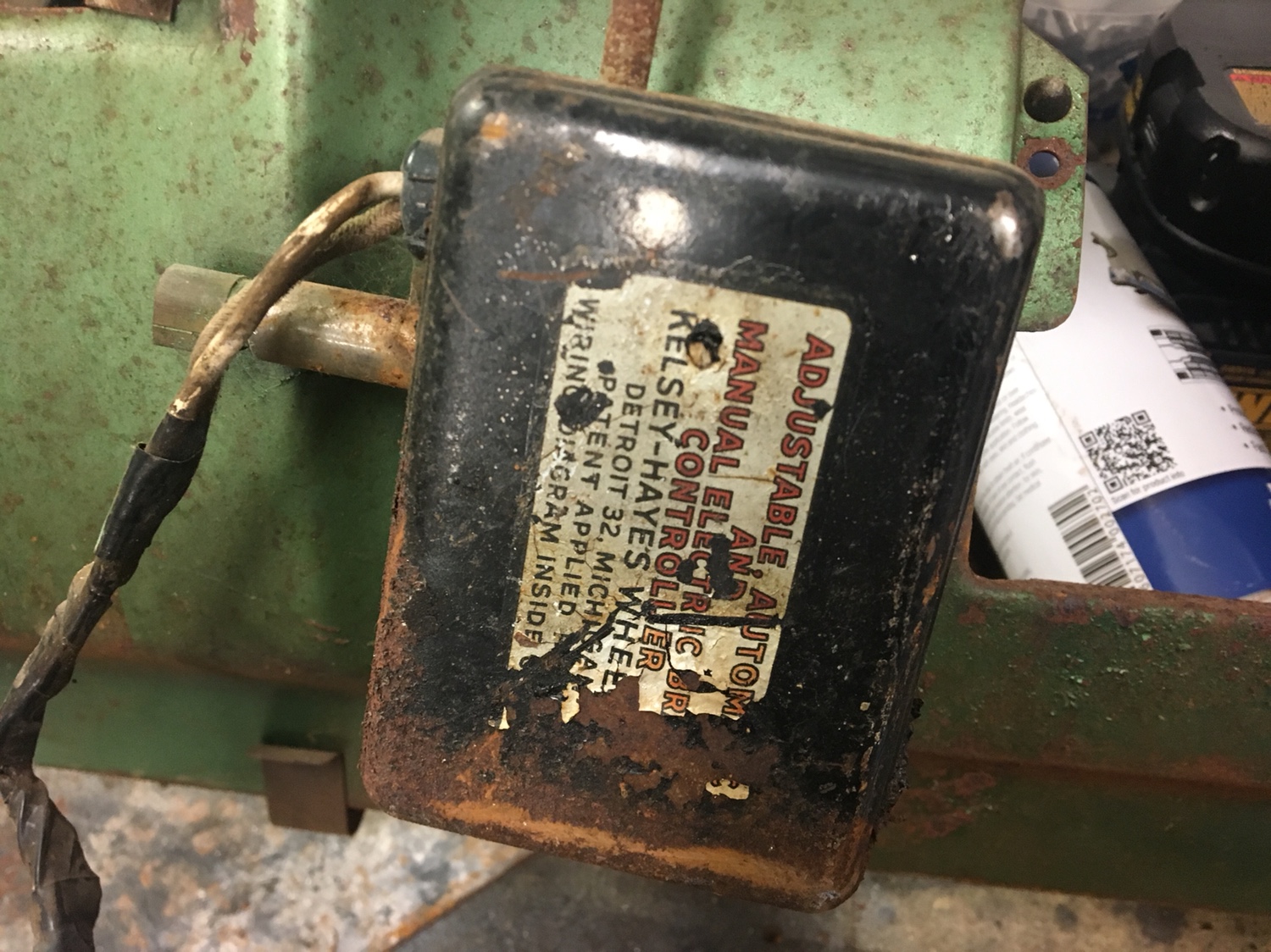

    Thanks! You know what the cool thing is? After we bought that 1956 Shasta trailer while I was dissasembling the dash I found this [​IMG][​IMG][​IMG]
    It's an old trailer brake controller! And as it turns out, the Shasta we bought came optioned with trailer brakes! Not sure if I'll reuse it since the thing only weighs about 1200lbs, but still cool to know this Caddy used to tow something, back in the day

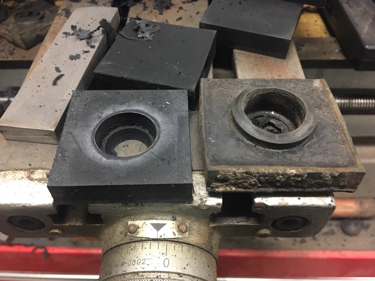

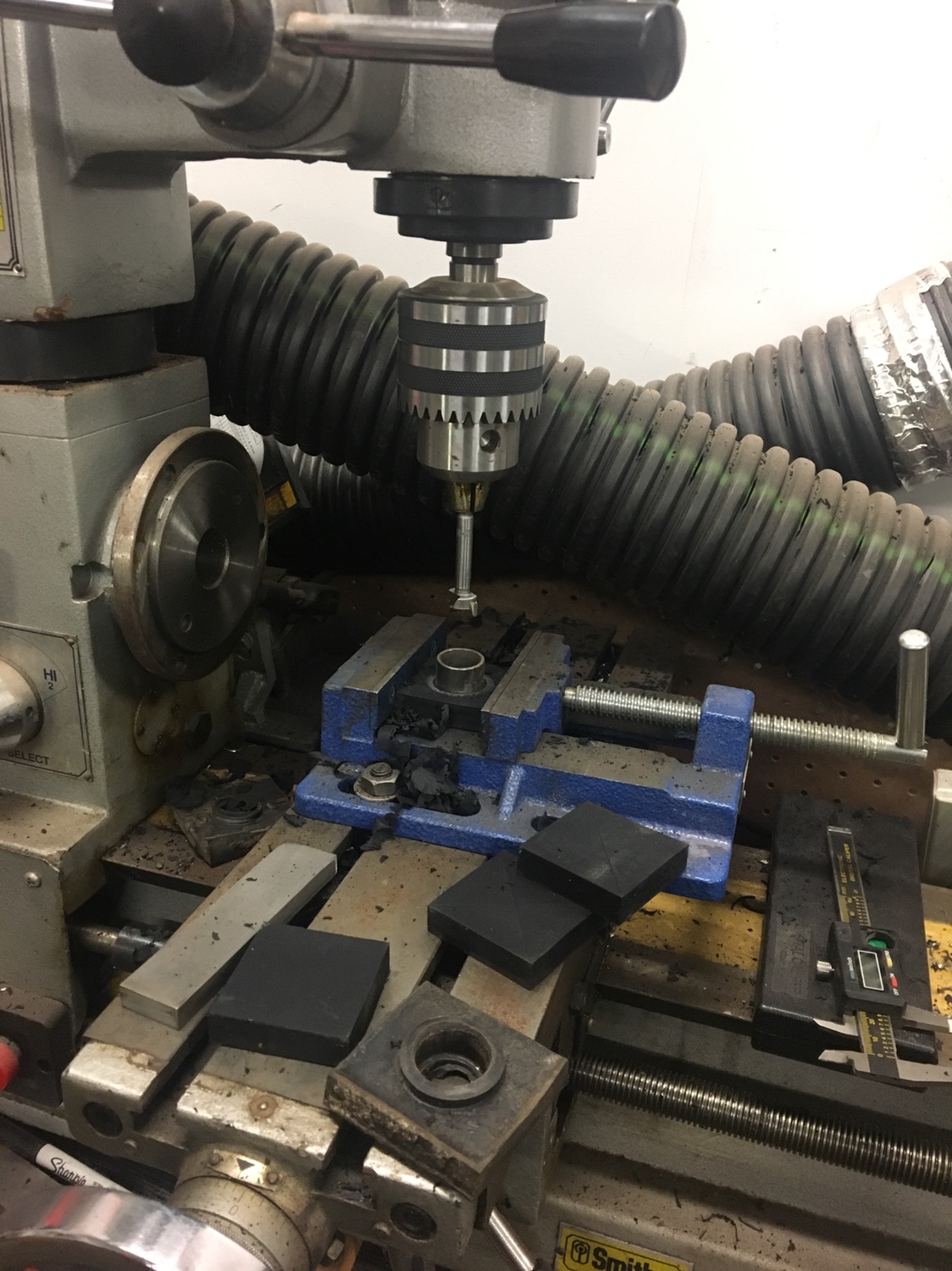

    I wanted to replace the body to frame rubber mounts but places like caddy daddy wants $620 for a set! So I just bought a strip of similar dimension rubber from McMaster and drilled the holes my self.[​IMG][​IMG][​IMG]
    Now I've finally got the body mounted and centered (which was pretty hard to do on the ground with two floor jacks) and I've established my ride height using a strap on the leaf springs

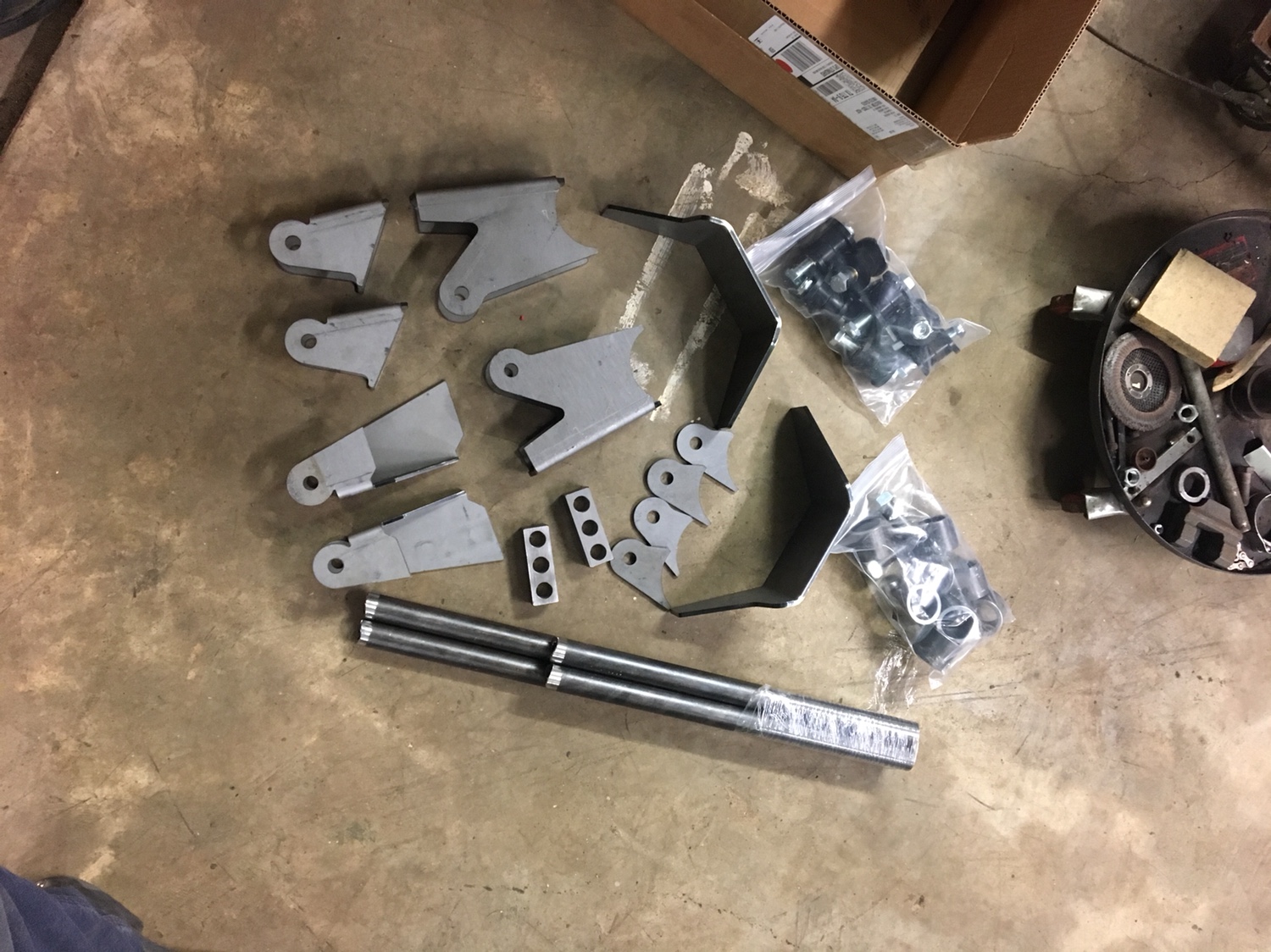

    My universal triangulated 4 link kit came in from Welder series. They're an alliance member, extremely personal and easy to work with, and the parts look great. Comes with everything you need, but requires welding (hence the company name). It keeps the price super affordable though and lets me do all the fun stuff. I'll be cutting an access hole in the trunk soon to start installing this.

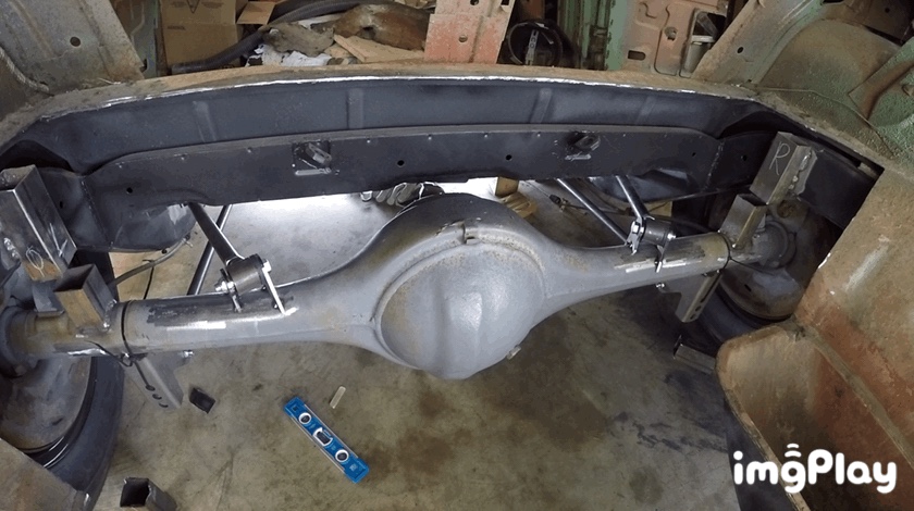

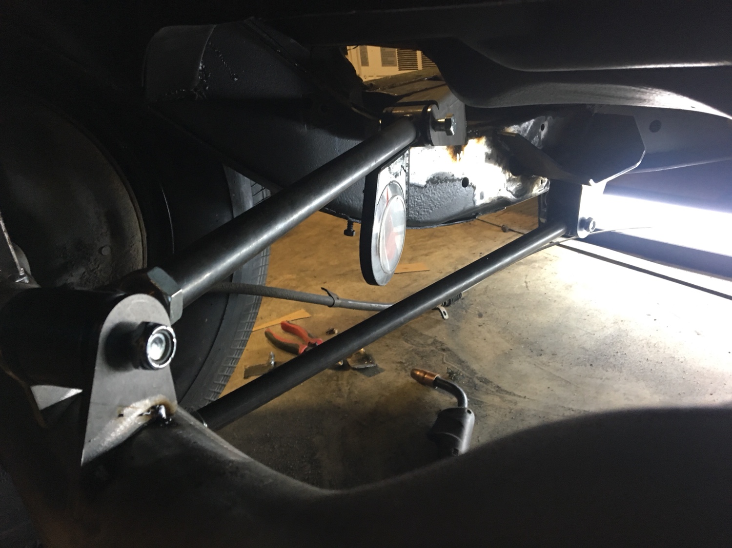

    Starting to mock up the upper and lower links. I made a box on top of the frame to support the upper link. Everything is just tacked for now until I get it all assembled
    [​IMG][​IMG][​IMG]

    Looks good!How do you make sure that the welds will not crack or break upon rapid acceleration?
  16. HermanMunster
    Joined: Jun 11, 2012
    Posts: 55
    HermanMunster
    Thanks! Well I guess there are a few factors that play into it, but I would say the two main ones are equipment capability and weld experience. I feel comfortable enough in my ability to tackle a project like this, and my welder is capable of working with this thickness material. I also test welded a few pieces to ensure I had adequate penetration

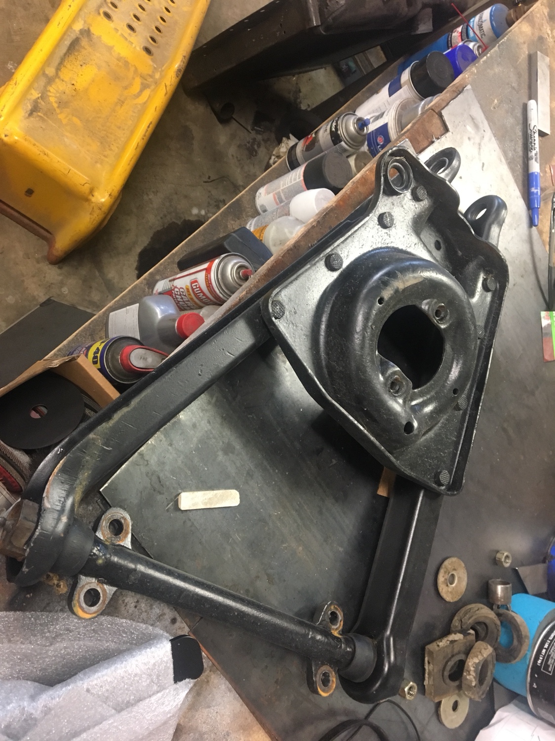

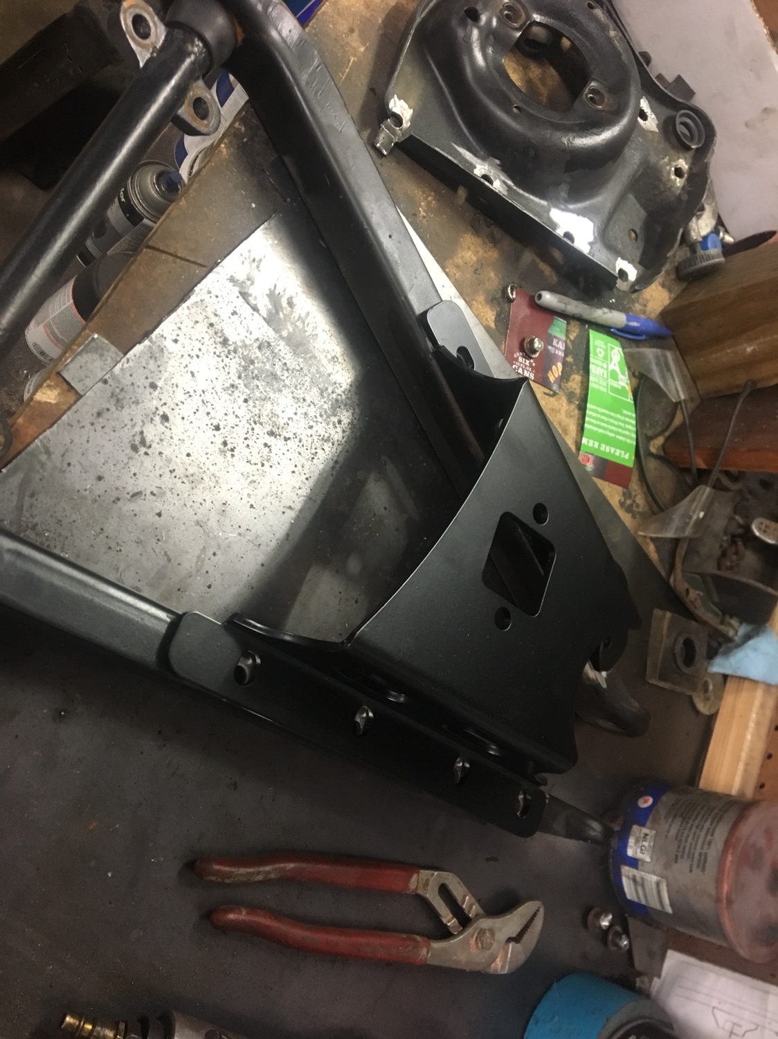

    For the front, I’m using Ridetech shockwaves. I liked the idea of not having to mount a shock somewhere else. They only sell one advertised for a 1956, but a 55 and 56 shared the same front suspension components involved so it worked for me. It requires opening up the coil pocket and installing a new lower control arm bracket that comes With the kit. It was very straight forward and looks great!
    [​IMG][​IMG][​IMG]
    This is how much I had to notch out
    I cut a vacuum hose in half and glued it to the edge, just in case
    And here she is laid out. Still have about 5” of ground clearance which is perfect for me.
    [​IMG][​IMG]

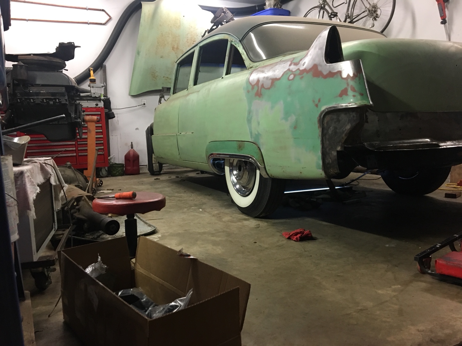

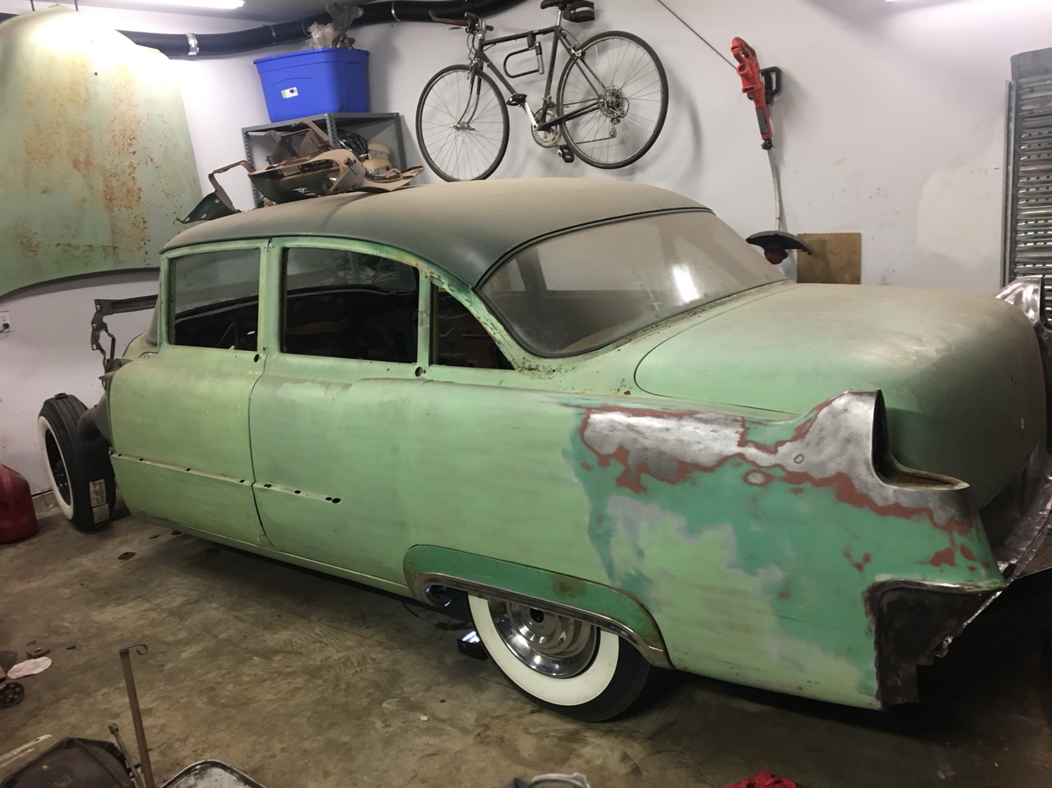

    Posts: 55
    HermanMunster

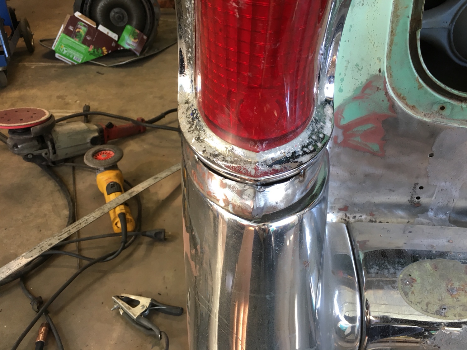

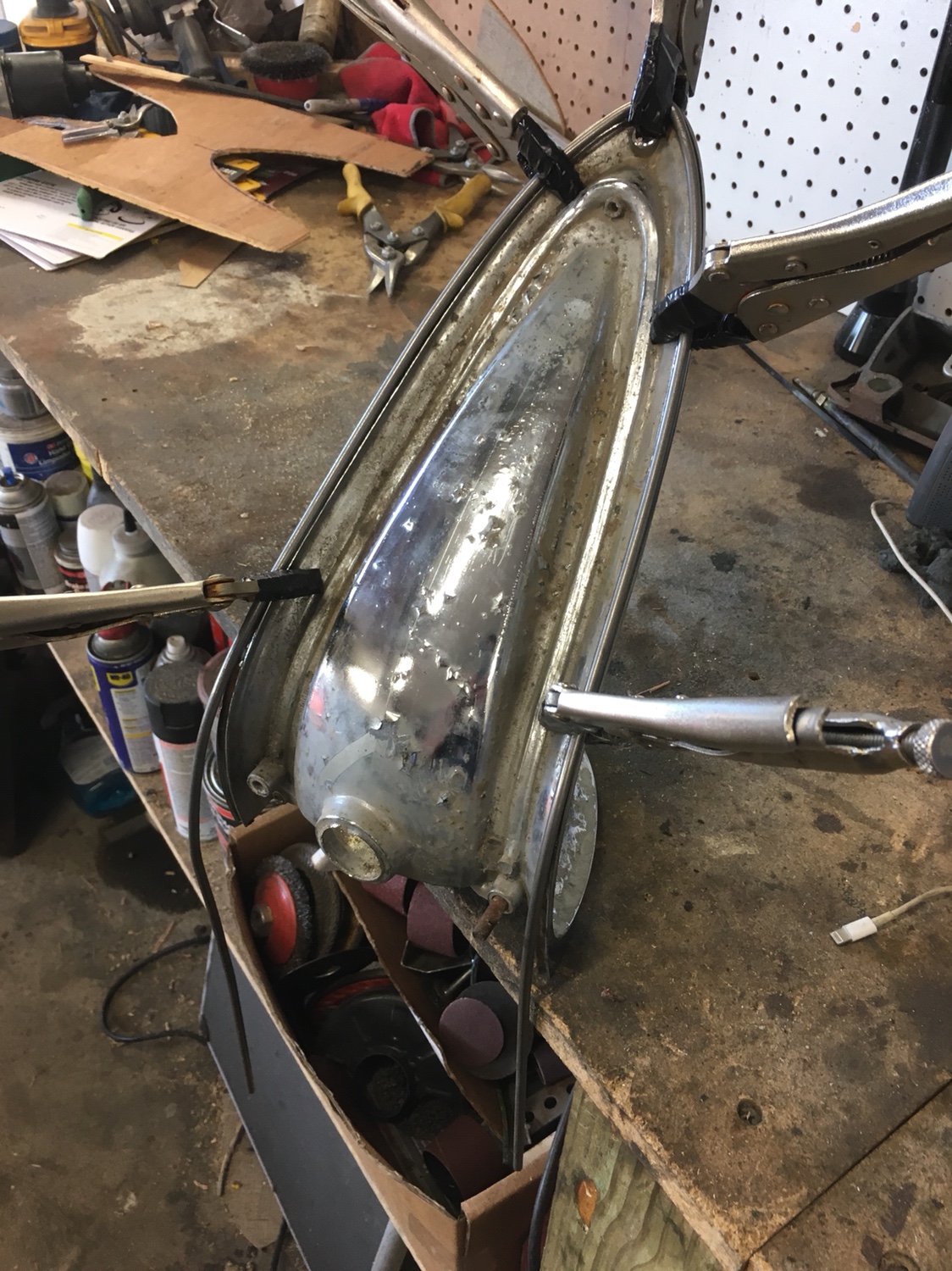

    I had a pair of Packard tail lights I felt would fit the car very well. The bottom shape of the light is almost perfect, and the height is perfectly level with the body across the car. I love the arc shape that the bumper end and light make!
    [​IMG][​IMG][​IMG][​IMG]
  22. BJR
    Joined: Mar 11, 2005
    Posts: 6,797
    BJR
    Save the parts you cut off as someone building a custom on another make body will want them with the original tail lights.

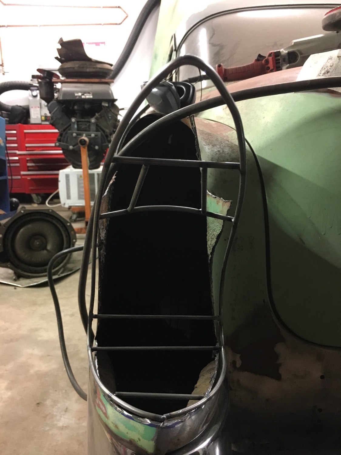

  24. HermanMunster
    Posts: 55
    HermanMunster

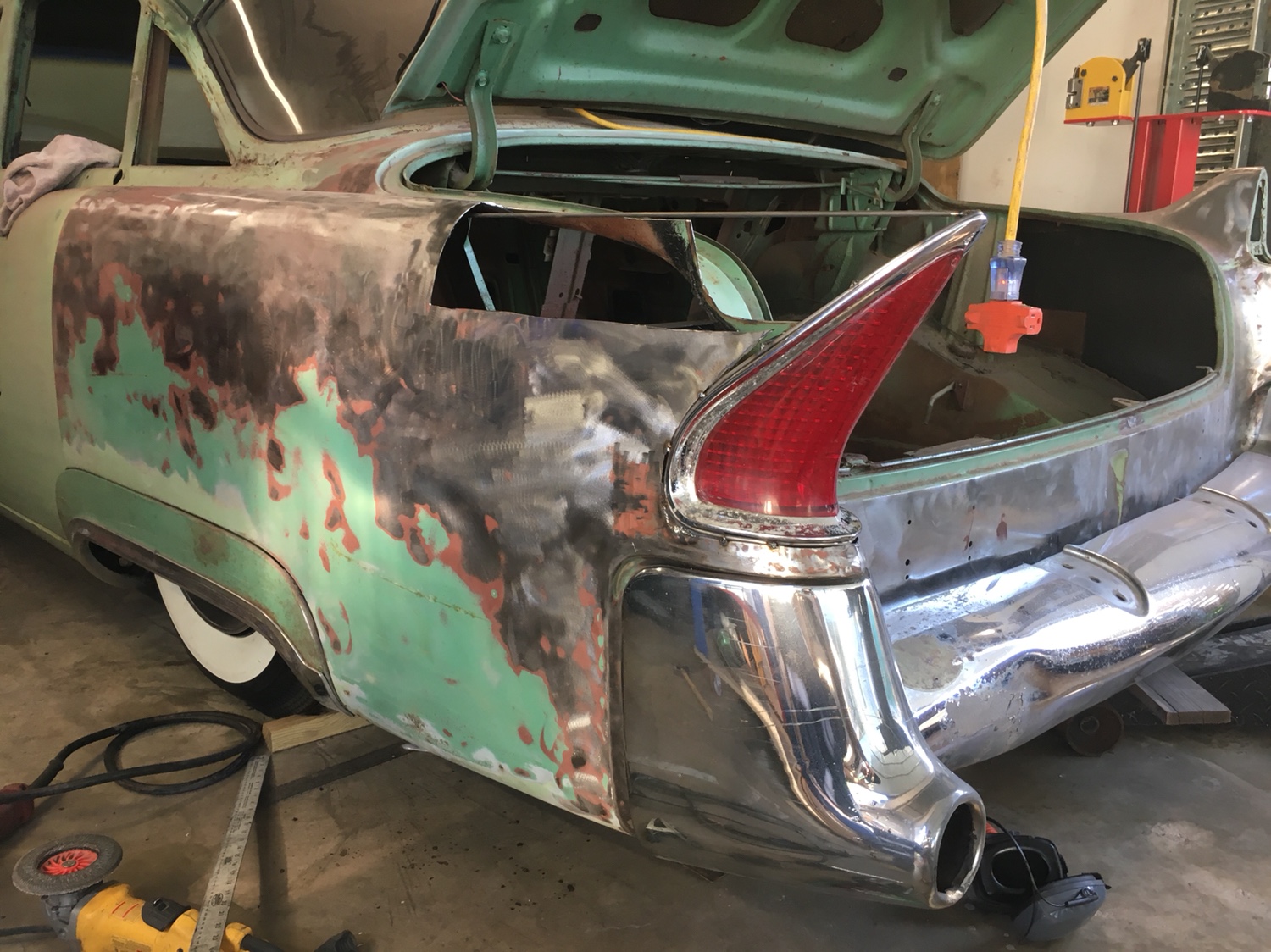

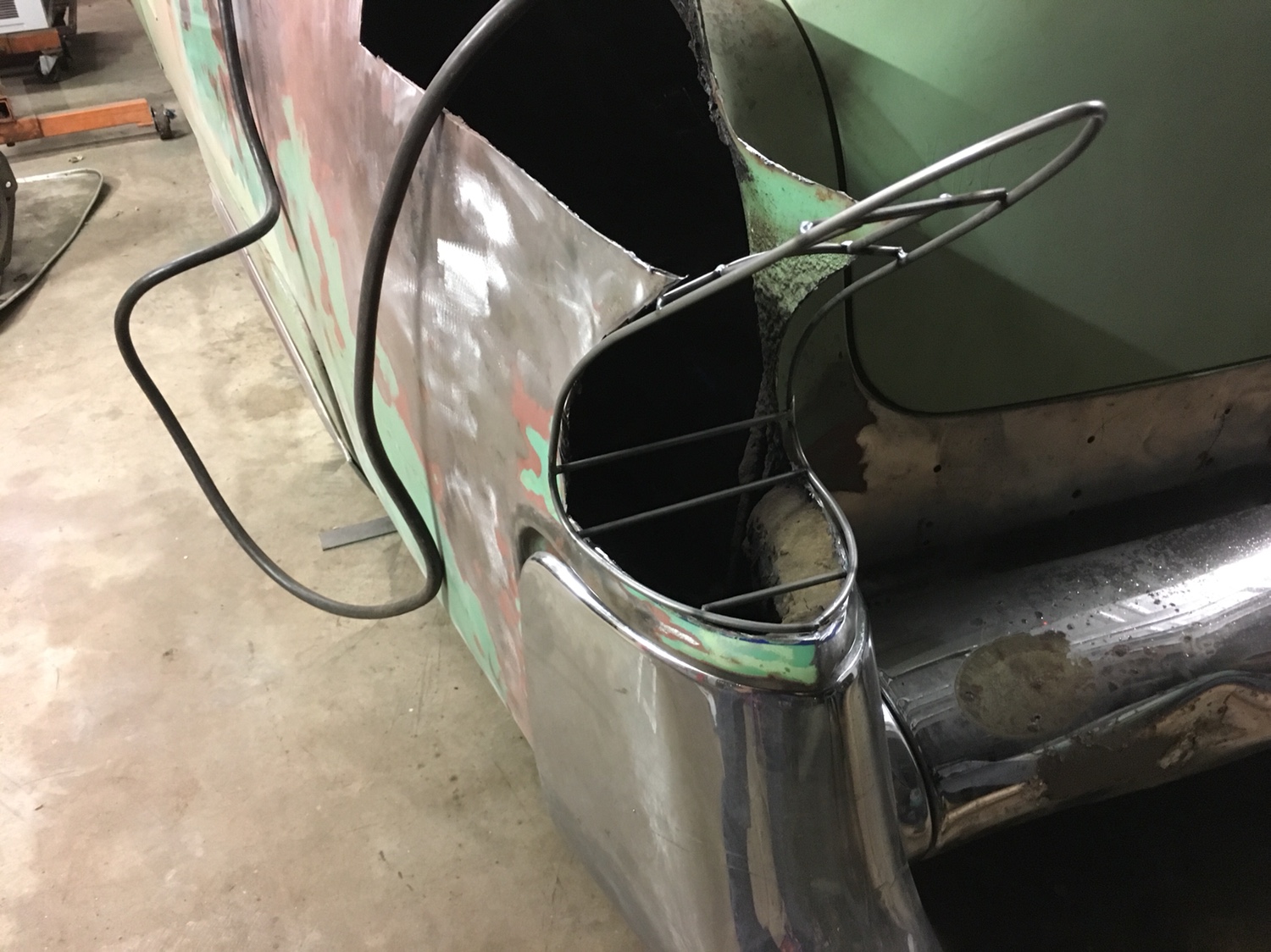

    I took this idea from someone else here on the H.A.M.B. used 3/16” steel rod and framed the tail light around the groove originally meant for the o-ring seal, then I’ll build the body around it. You can see how close to perfect this light fits on this car, but it’s slightly wider at the base, I’ll have to figure out a smooth transition or possibly massage it into place[​IMG][​IMG][​IMG][​IMG]
  25. japchris
    Joined: Apr 21, 2001
    Posts: 326
    japchris
    from England
    Those lights were meant to be there. - Really enjoying this thread!
  26. philo426
    Joined: Sep 20, 2007
    Posts: 2,035
    philo426
    Very smart building an armature.Gives you a solid base when you graft in the new sheet metal.
    Bowtie Coupe and chryslerfan55 like this.
  27. HermanMunster
    Posts: 55
    HermanMunster
    Thanks to all for the input! I was able to hammer/dolly the bottom metal closer to true, and I used a clamp with a reversed arm to spread the body open a bit. This allowed me to get the outer edge pretty much flush with the wire frame, and will only require a small flare out on the inside edge. I’m learning a lot from this first one to hopefully help with the second one [​IMG][​IMG][​IMG]
