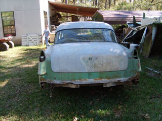

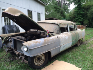

    I've always wanted a 1955 Cadillac, finally came across a sedan on craiglist that looked decent. A coupe would've been awesome, but any I found were out of my price range. After looking at this car in person I still felt like she was sexy and I wanted her, so after some negotiating and a hand shake she was mine. Her name is Nadine.
    [​IMG][​IMG]
    Her story's actually kinda cool. Original owner decided to take her apart to restore, but then passed away. His family donated her to a church, the guy I bought it from got it from the church 10 years ago, parked it behind his shop and never did anything. He said he wanted to put a Northstar drivetrain and interior in it, I'm glad he never did.
    Here it was after pulling it out from behind the Shop after sitting for 10 years. I was so obsessed with owning this Cadillac I didn't even think to question whether he had any other parts. Much to my surprise (and now that I've had a chance to see how much chrome is on this thing I'm really glad) he had bins full of parts. Bunch of chrome, bunch of interior, even the original seats. (Which were sitting out on a pallet the whole time collecting mice) Then just when I thought I had it all, he called me inside the Shop where he had all the door window rails and glass. I was renting a house at the time and did have a place for her so into a storage unit she went.[​IMG]

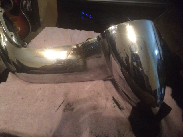

    According to the guy I bought it from it ran when he got it, so I threw a battery in, sprayed some starter fluid in the cab and much to my surprise she turned over. I ended up replacing the points, wires, and rotor, and running a fuel line into a gas can. Had her idling within a week. I also was curious of the disposition of my chrome, so I took a bin home and took some steel wool to it. It's not perfect, but it's pretty damn nice considering its age.[​IMG][​IMG][​IMG]

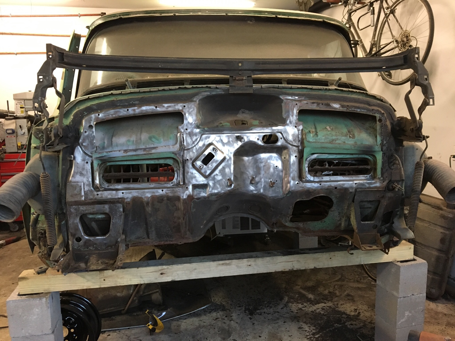

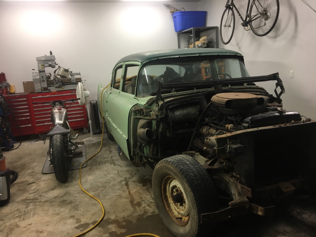

    Fast forward a year to today, and having to move between 3 houses later, I'm finally able to get her apart for cleaning and paint. [​IMG]
    This cars a boat, and all the parts are huge, having to get creative with dissasembly.
    [​IMG]Seperated the body from the frame.[​IMG]Had to take the rear wheels off and compress leaf springs[​IMG][​IMG][​IMG]
    It's the original drivetrain, but I think I might put a 700R4 behind the 331 to make it a little more drivable. I'm also thinking of bagging it

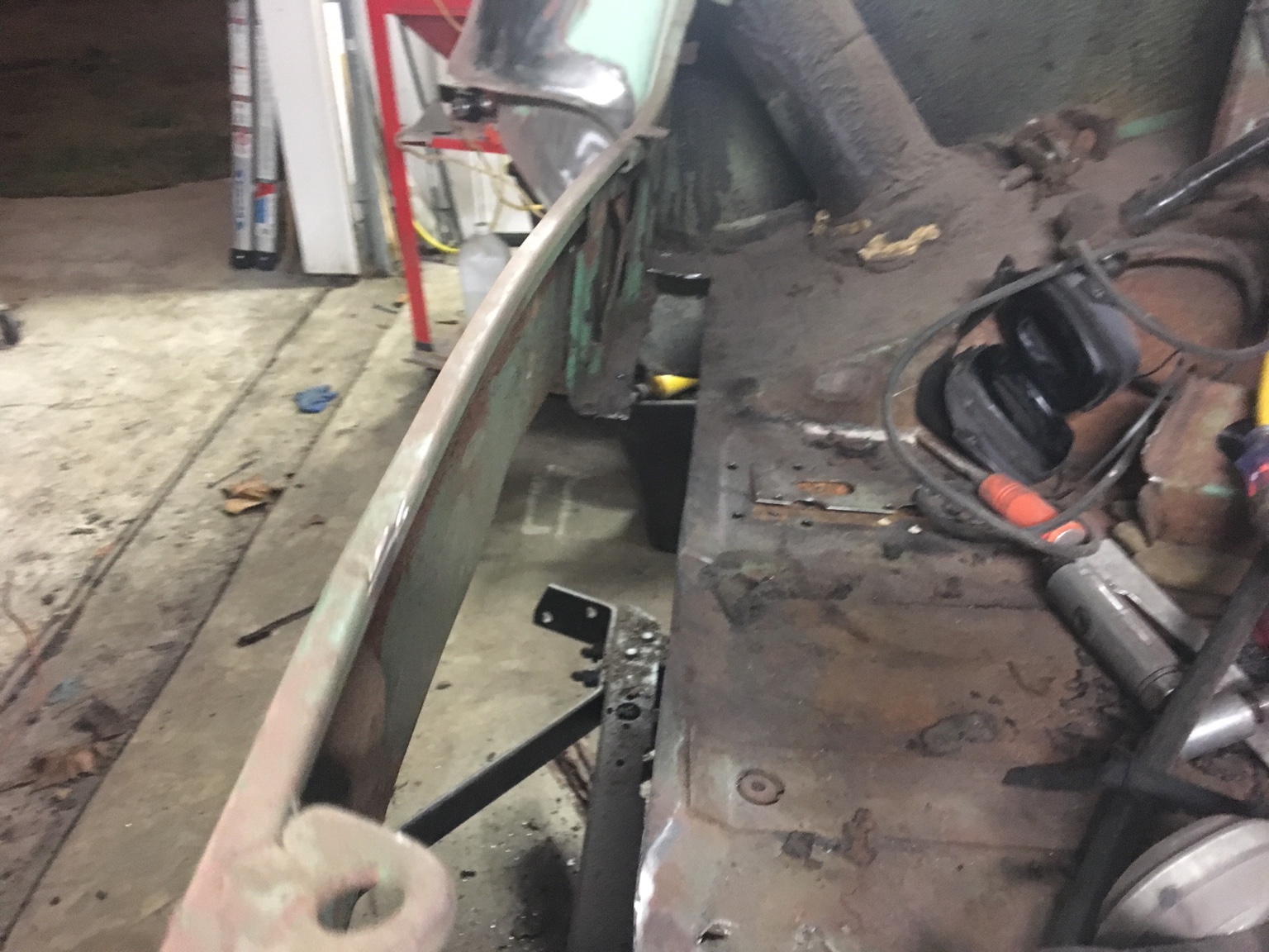

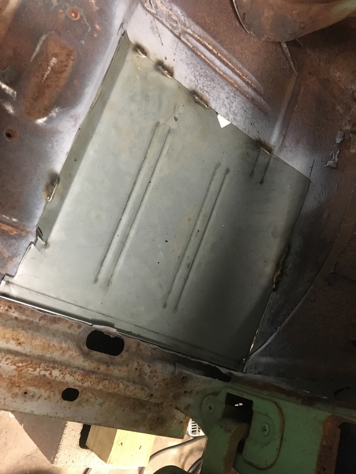

    It’s been awhile since I’ve posted an update but mainly because it's been all boring stuff. I've taken all the undercoating off and used some Eastwood undercoating. Patched a rusty spot in the floor, and now I'm working on some rusty sections in the trunk
