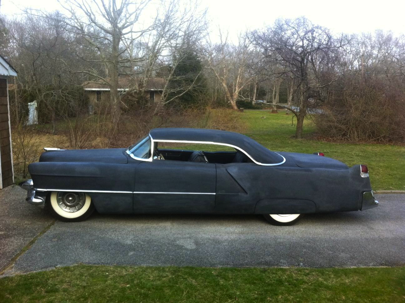

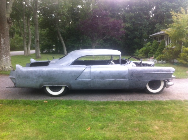

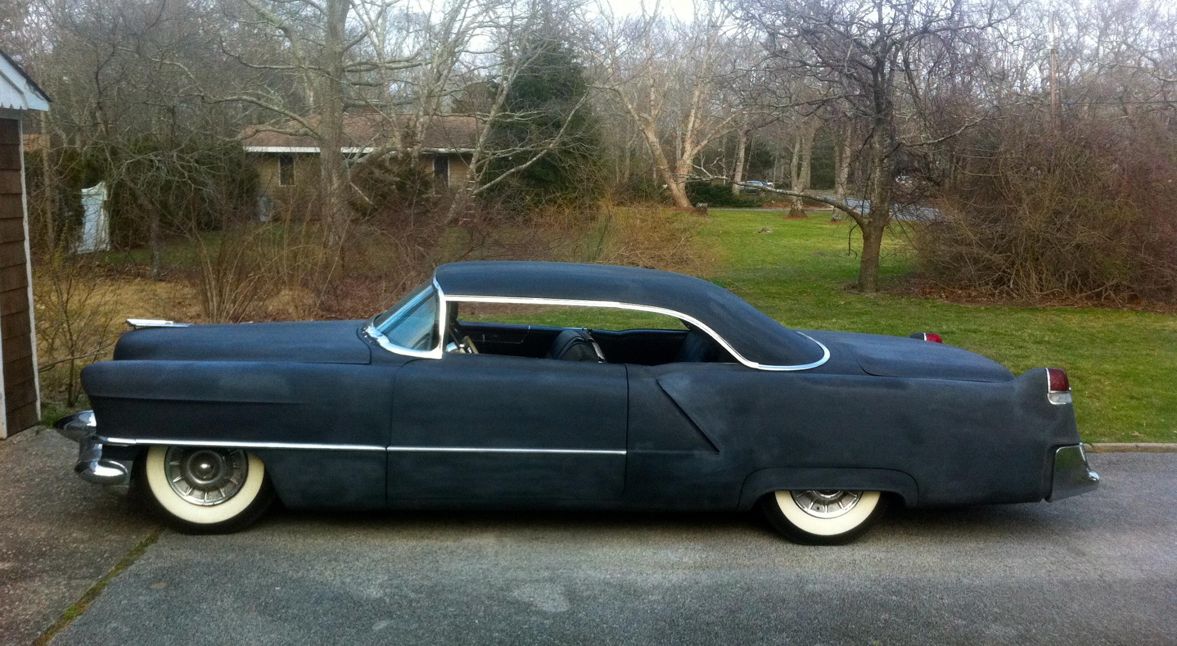

    no major updates until the summer. But had the car out in the sunshine today and decided on two last little changes. Then the customizing is done and i can start on the restoration.
    I decided to put the hood ornament back on. i'll fabricate a strip down the center of the hood that will continue the line on the ornament and taper it to a point. I'm going to move the hood ornament forward about 2 inches and angle it up slightly. Gives it alittle more attitude.
    The last change i decided on was to lower the skirts a bit. Maybe about 2 inches. I may remove the small lip on the skirts. Not sure. Here's some photoshop pics.
    The first step in the restoration is to get it running reliably. It's my daily driver. Full motor and trans rebuild and new wiring harness. Then removable hardtop. Then paint.
    PS - I need a piece of body trim. The chrome body trim piece that goes on the door. Either side. I'm going to chop it to fit the continuation of the body trim to the new vent opening. Same as Roger did. If anyone has a spare to sell, I'm a buyer. Thanks.
