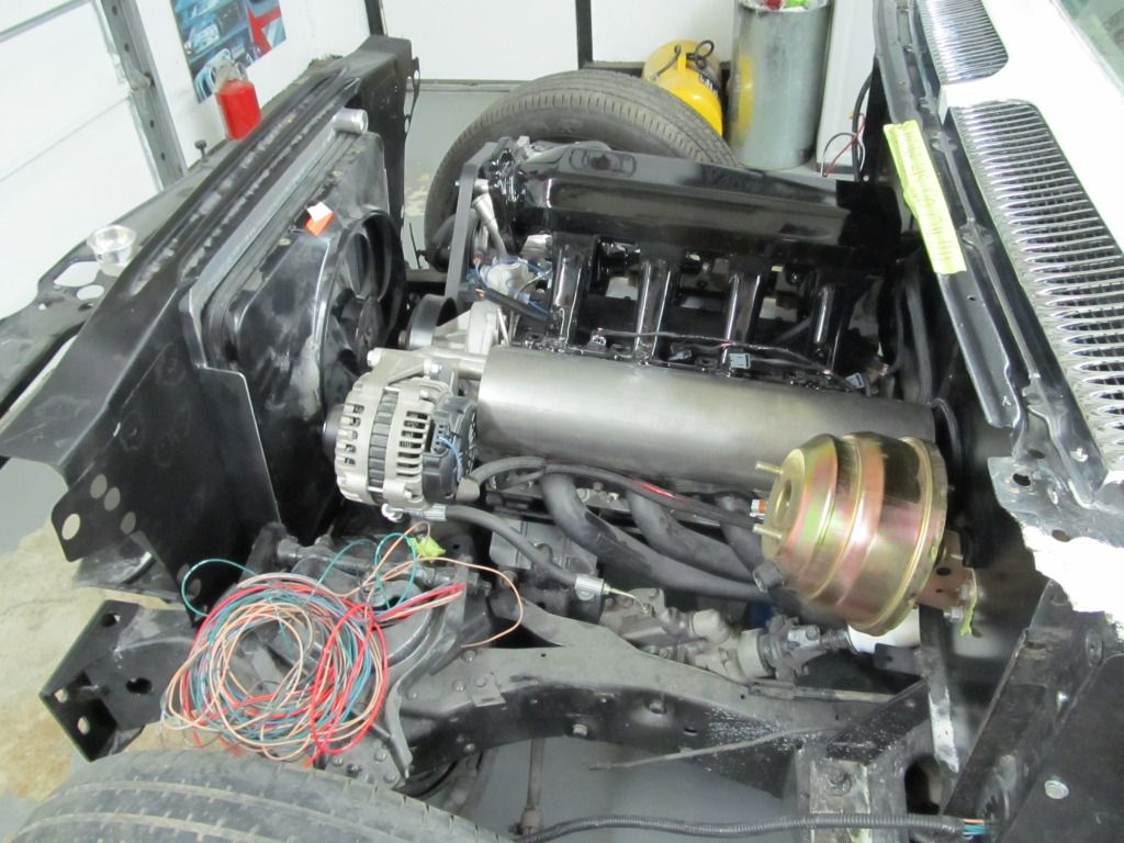

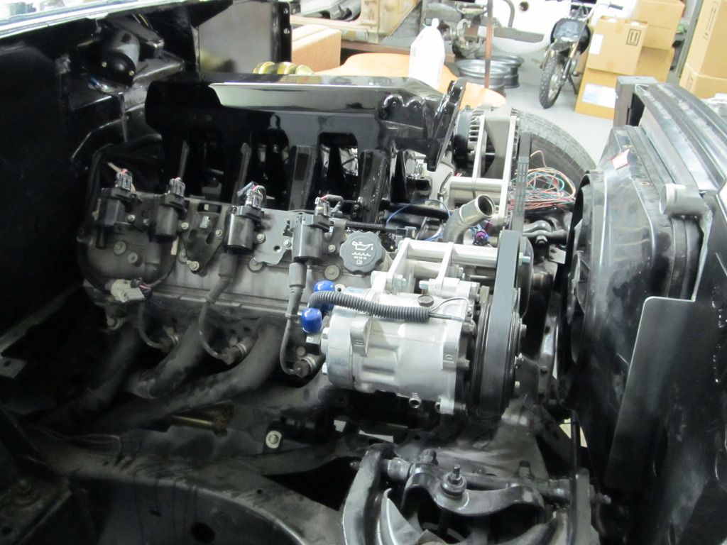

    Also got the engine mounted but may either need to cut into the trans well in the floor or cut and lower the mounts, or both. Going to take some serious time to get it perfect but here's the start. The headers look awesome but left them off for the pic so you can see the mounts.

    Coming along nicely...are you going to remove the half round air boxes on the firewall...??? Looks like it might give you a bit more room.
    Sure would llike to see a shot of the whole engine compartment with the new engine sitting in it...

    Yeah I noticed that you did that on yours and it turned out nice! I have plans to modify the engine compartment pretty extensively, but step one is to remove those air boxes. I have already unbolted them and noticed they are glued/sealed on as well. Funny you mention that. I actually PM'd you a few days ago about any issues I should be ready to anticipate. Check your inbox, I left my number!

    So after I mounted my motor last, I realized quickly that due to a large seam I would need to cut my floor and then fab up a new trans tunnel... So here we go!

    Sorry for the poor quality pic. Anyways, I now feel a lot better knowing that with some adjustments to the motor mounts height and position, my drive line should be a good angle at the end of the day. I was a little nervous after seeing how huge this trans is! I also removed ALL of my steering components and sent the steering box out to Ron at RPM so he could use as a template for the custom rack and pinion he is building me. I am happy that I can now see the light at the end of this tunnel and hope to have this thing firing up sooner than later.
