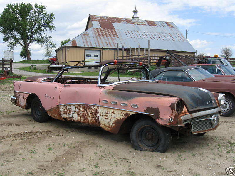

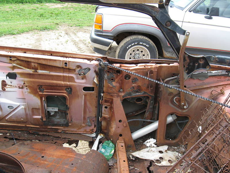

    I found a donor car (1956 Buick Custom Convertible on eBay) I got it for a great price before thinking how much it would cost to ship the thing back here. Next idea...rent a truck? Still too expensive. Last idea... Fly to Nebraska where the donor car was with a sawzall and a socket kit and buy a truck off Craigslist for as little as possible and sell it when I got home. Below is the donor, From this I was able to get the stainless trim for the from windshield frame, the frame itself, the folding top, the rear bench seat and its bucket, as well as the rear windows. Also the truck that I bought for 1500 drove across the US and sold for 1350. Not too bad...
