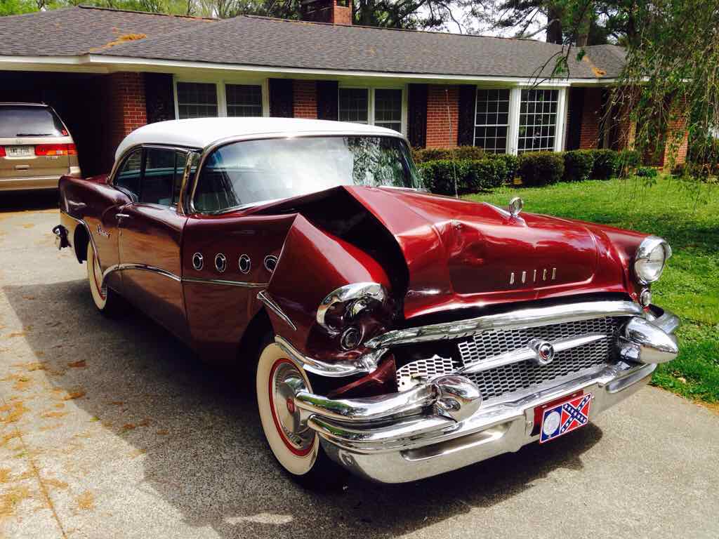

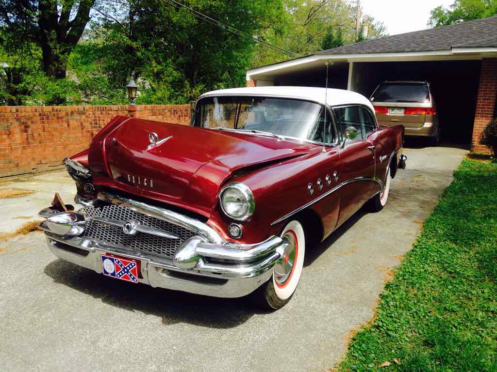

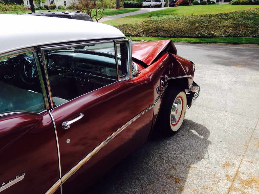

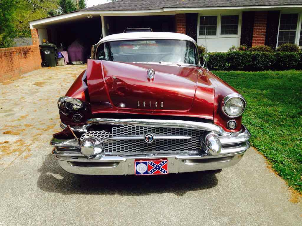

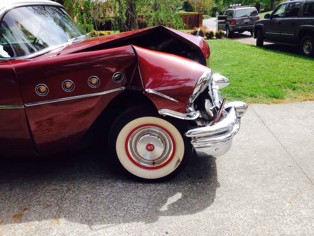

    I wrecked Miss Molly yesterday on I 75, and never made it to the Coker Tire Cruise-in in Chattanooga. I need some help on which direction to go. Beyond the damage to the grill, bumper, hood, and fender, it has damage to the radiator, core support, and passenger door mounts at the cowl. The motor and rest of the drivetrain is OK. Also, the frame rails were not damaged. I either need to build it back(need parts car?) or sell it to someone who can. Or am I better off parting it out at this point. Please see pics and feel free to make suggestions. Thanks ImageUploadedByH.A.M.B.1428853624.536049.jpg ImageUploadedByH.A.M.B.1428853636.536699.jpg ImageUploadedByH.A.M.B.1428853649.086489.jpg ImageUploadedByH.A.M.B.1428853662.052777.jpg ImageUploadedByH.A.M.B.1428853676.453192.jpg ImageUploadedByH.A.M.B.1428853688.402896.jpg

    Looks like a relatively easy fix to me...as long as the passenger cowl hasn't been pushed back. (door to quarter gap is a little tight so it might require a light pull on the cowl. but more likely it's the hinges/door frame that's tweaked) You got lucky. Door, fender, inner fender, core support, hood, grille, headlight, and small parts should get it up and going again. All but the door could be obtained from any Special or Century. The door of course would have to come from a 2-door hardtop model Special or Century. Super and Roadmaster stuff won't fit. Good luck...and count your blessings. It could have been much, much worse.

    Fixing what you have would be way easier then starting over. If you have insurance they should pay to fix it. If not, pay a good body frame shop to pull the cowl if needed and start rounding up bolt on parts. Look at the crap other Hambers have started with and ended up with beautiful cars. You are way ahead of them to start with. Go for it!

    Outside of what may have to be pulled into place by a body shop on the cowl it's an unbolt the old stuff bolt on the new stuff project.
    Way back in 1967 I did almost the same damage to my 55 Special when a guy ran out in front of me and I broadsided him. Took my little brother with me to a wrecking yard and unbolted the nose off another Buick and took it back and put it on mine in about a day.
    After you get done dealing with the insurance I'd pull the nose off and see where I was at and go from there but to me that is far too nice a car to part out.
