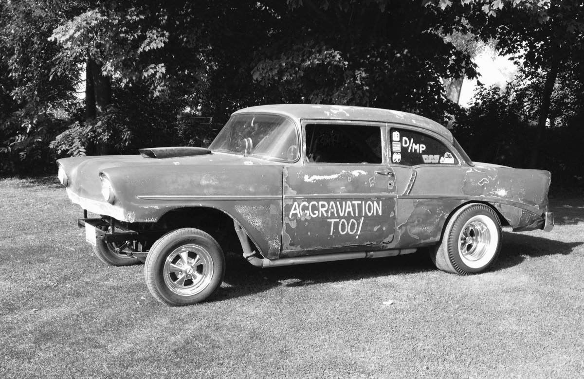

  3. Mac_55
    Joined: Mar 10, 2008
    Posts: 688
    Mac_55
    im same as above . I went with the 57 truck axle because the leaves are perfectly parralell and almost match up perfectly with the stock frame . The earlier truck axles have tapered leaves that come closer towards the front . To me it just looked like they would sit to far inboard on the stock frame to be safe.
    i can get some closer pics if you like

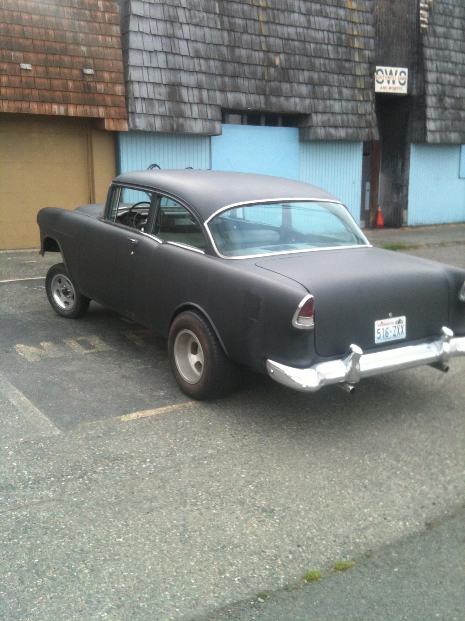

    id like to see some pictures.
    I still ogtta get my steering lined out "ie ,,, a correct steering arm"
    as you can tell fromt he pics my drag link is at a big angle , no motor right now and just hooked that up to roll around on , ive got a 6 inch bendable from borgeson mullins but it wont drop far enough off the stock box so i gotta do something else.

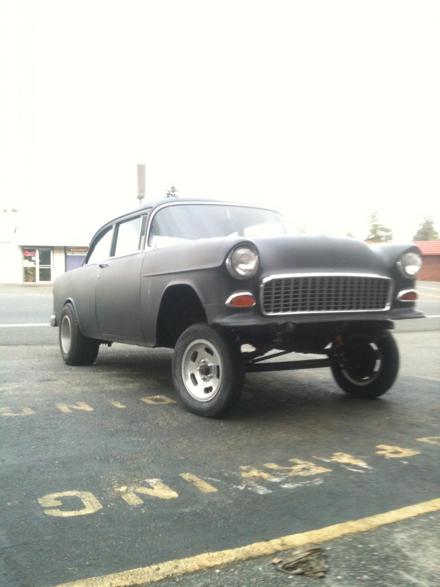

  7. My 55 project is supposed to arrive later today. I will share pictures and progress with y'all. Thanks for all of the input fellow HAMBers!!!

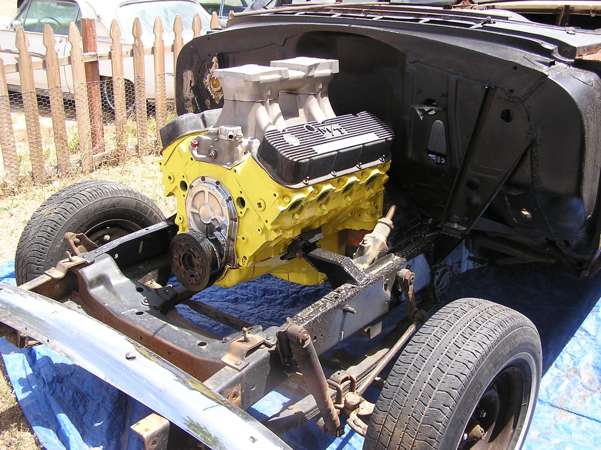

    how about using the truck frame, firewall forward, this is a 55 gmc

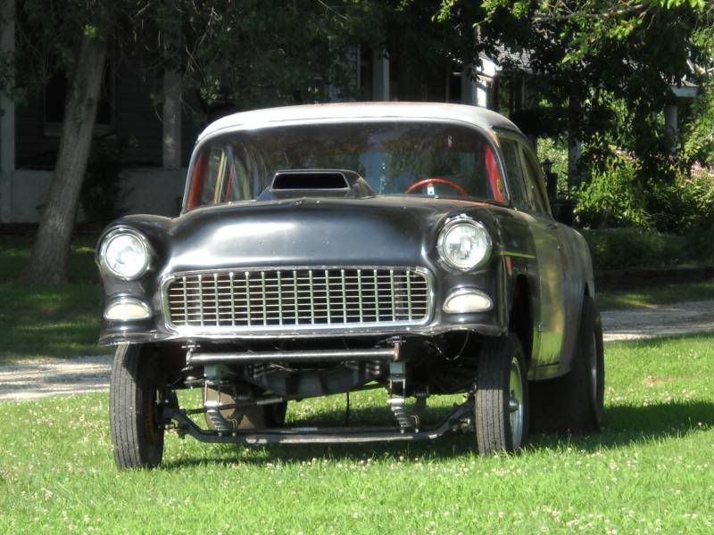

  16. cs39ford
    Joined: May 1, 2012
    Posts: 861
    cs39ford

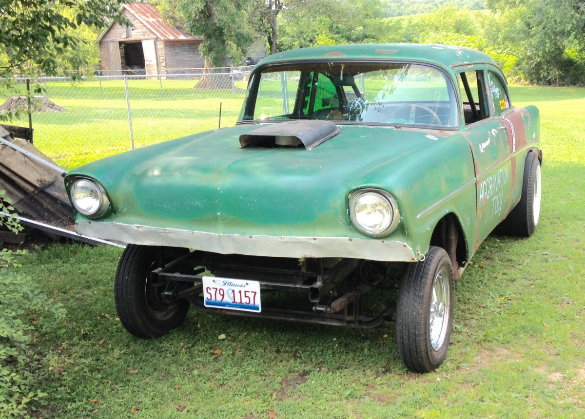

    image.jpeg image.jpeg My 56 with truck axle. But square tube frame stub. Done in the 1960s
  17. cs39ford
    Joined: May 1, 2012
    Posts: 861
    cs39ford
    I didn’t build it. They look like the original truck springs. It was built in the 1960s. So I would say Original. Since there were not a lot of options then
