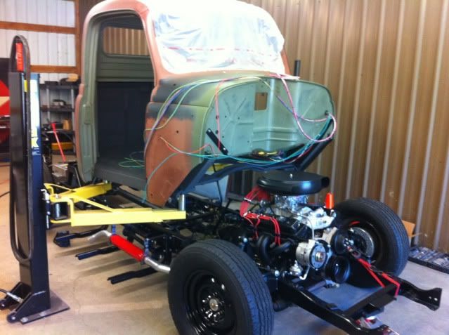

  15. RatPin
    Joined: Feb 12, 2009
    Posts: 574
    RatPin
    Yes, just getting back onto this after a 6 month break. Last weekend I sprayed in the Lizardskin sound control and ceramic insulation. Next will be setting cab on frame and wiring the beast.
    Updates to come...

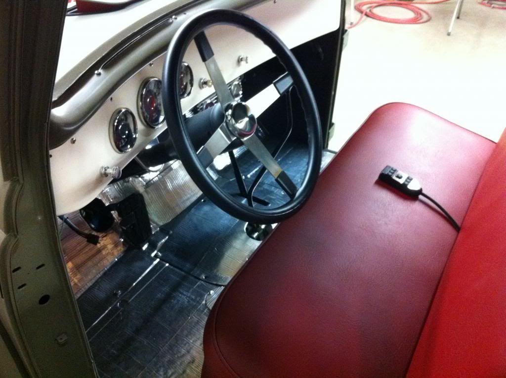

  16. RatPin
    Posts: 574
    RatPin
    Lots of progress over the weekend...
    Finally mated cab to frame for last time

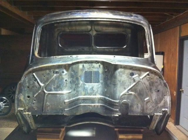

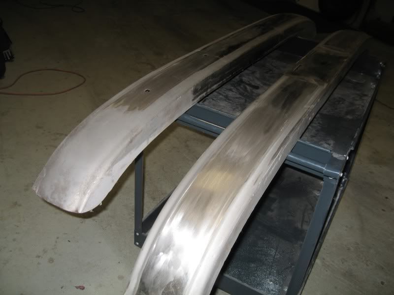

    Through the course of this project I have removed every spec of the previous four paint jobs. Here are some gratuitous bare metal shots.

    As a noob, I have a couple of questions for you, RatPin.
    What Heidts rear end did you use?
    and
    With a V8, you didn't feel the need to box the whole frame?
    Thank you in advance sir!
  20. RatPin
    Posts: 574
    RatPin
    I'm using a Thorbros parallel 4 link in the rear with the original Dana 44. Hopefully that axle holds up.
    As far as boxing the whole frame, the 8 point K-member gives the frame way more than enough structural rigidity. Plus I was able to mount all my air valves, air lines, wiring and compressors in the frame recesses out of the way.
    Here are a few more updated pictures.
