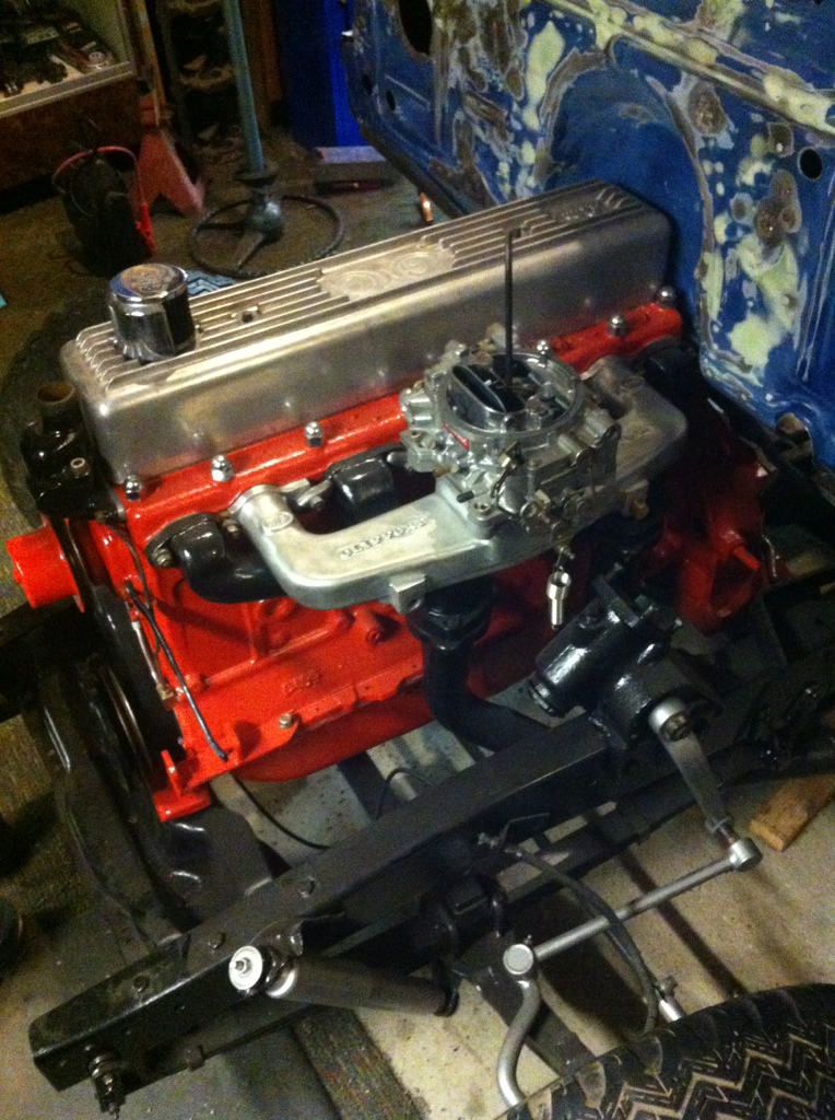

    but seems to work great with no binds or anything, also picked up the new motor for it. from a good buddy of mine who recently pulled it from his model a and replaced with a 427 bb chevy!
    mild build
    4 bolt main
    30 over
    new pistons
    rv cam
    194 heads
    air gap intake
    carter 650
    deep sump oil pan
    nice and healthy
    around 375hp maybe a bit more!
    paint and clean up should make it look real nice!

    just curious, where did you get the intake?
  20. came with the motor when i bought it. i can inquire about it. ill let you know
