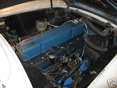

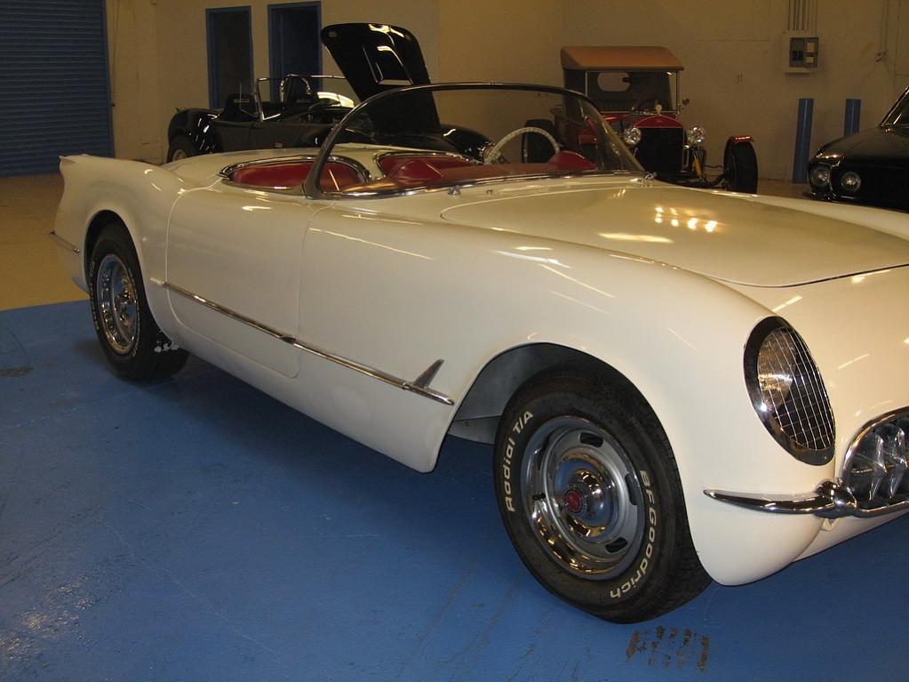

    For starters, you need to be looking for it's other two carbs! Is that the original 235?
    The wheels are going to have to go, does it have the stock hubcaps? Stance looks like it has weak springs.
    It looks like a great candidate for making a hot rod. :)

    It needs 3 carbs.

    Engine set-up doesn't look very original. Make sure EVERY piece of trim is there, including interior. Look for cracks and repairs in the fiberglass from underneath. Lose the wheels/tires.

    The motor isn't right.It should have three Carter YH's not one Rochester B.

    I'm no expert on Corvettes by any means....Something about it screams "kit car".

    should have 3 carter side drafts, that appears to have 1 rochester?

    yeah i would be wary of that tire wheel combo....has it been upgraded to disc brakes? i would double check all of the fiberglass work too (if its obvious any has been done). i am no corvette expert but the carb set up does seem incorrect. i've also heard that sometimes wiring can be a pain since its a fiberglass car and there is no ground at the rear of the car. the tail light wiring has to run there and back to ground.
    other than that from pictures it looks pretty complete on the exterior. interior looks nice too,....what engine tranny is that?

    Not being a smartass but there are kits of those available. Can't see enough in the picture to tell one way or the other. Don't know what chassis the kits are designed for. Might be worth investigating before $ changes hands.

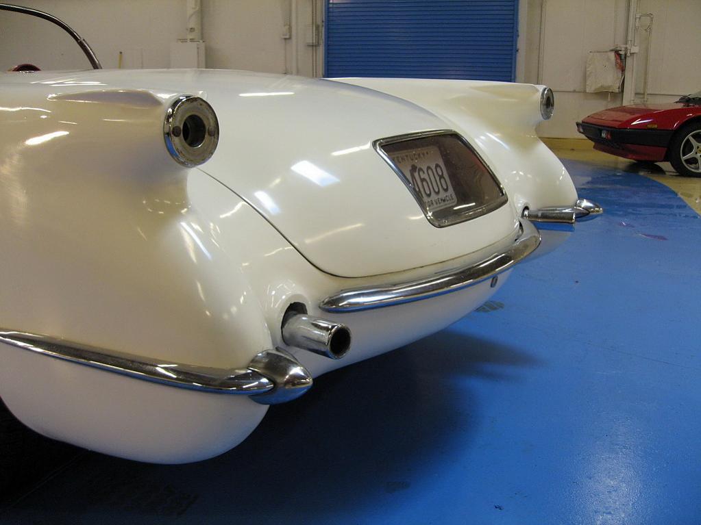

  13. Looks like its in a museum in those pics? And a Kentucky plate too? No tail light lenses?
    Check it VERY carefully, hell, have a Professional Appraisal/inspection done on it, PM Boldventure on here, he does it, and is reasonably local. Lets face it, that ain't gonna be a cheap car, so drop a few extra $$$ for the 'non rose tinted spectacles' view of the car.

    It should have a stock cast iron split manifold with multiple carbs IF the engine is original...there's usually a decal on the valve cover that sez "Blue Flame" or "Blue Flame Six"...
    It should have a '53/'54 type front suspension if it's original...if it's got something else, then it's been modified...

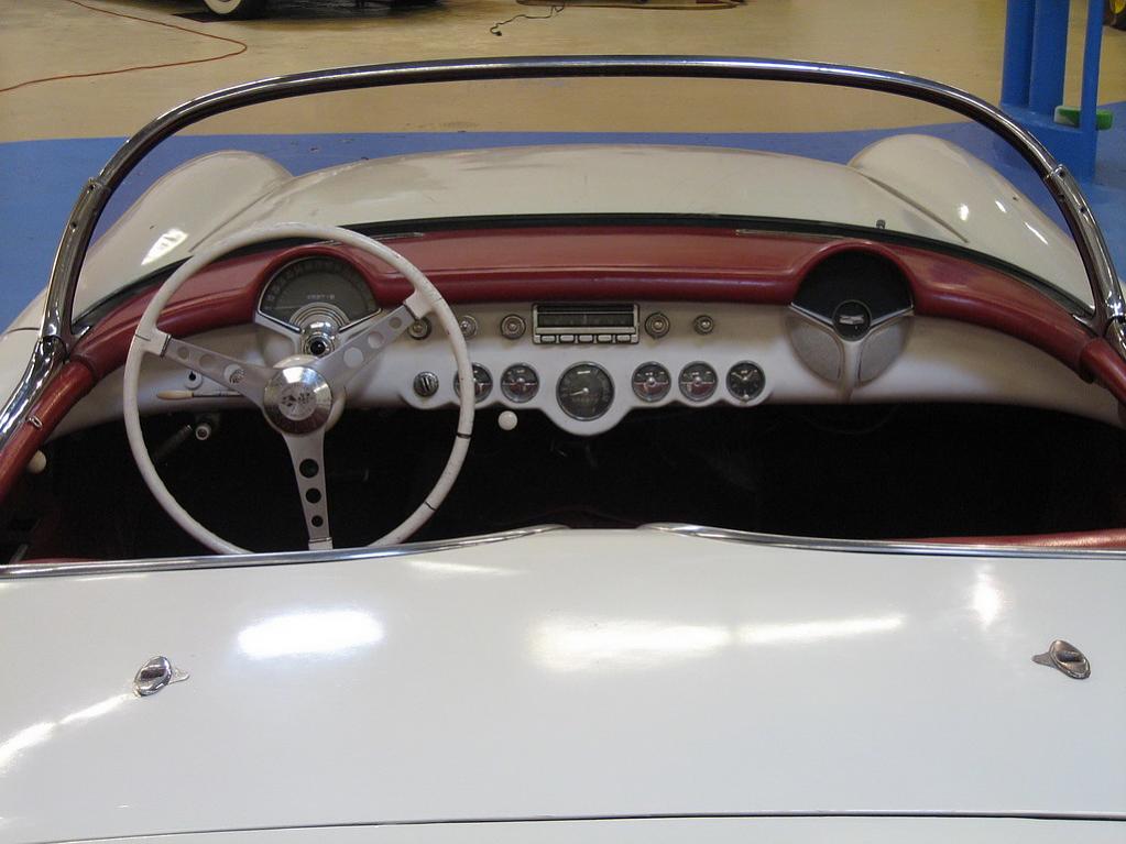

    Missing bumper pieces , wrong steering wheel and some script trim pieces among other things . Was on eBay , no sale 2/12/09 . Look at completed sales on eBay to compare.......

    looks a little bent in this picture.

    I can see real rough body/paint work from here, and I'm half a country away.
    But, that may be a plus, cause the early Vette's were supposedly really poorly built.
