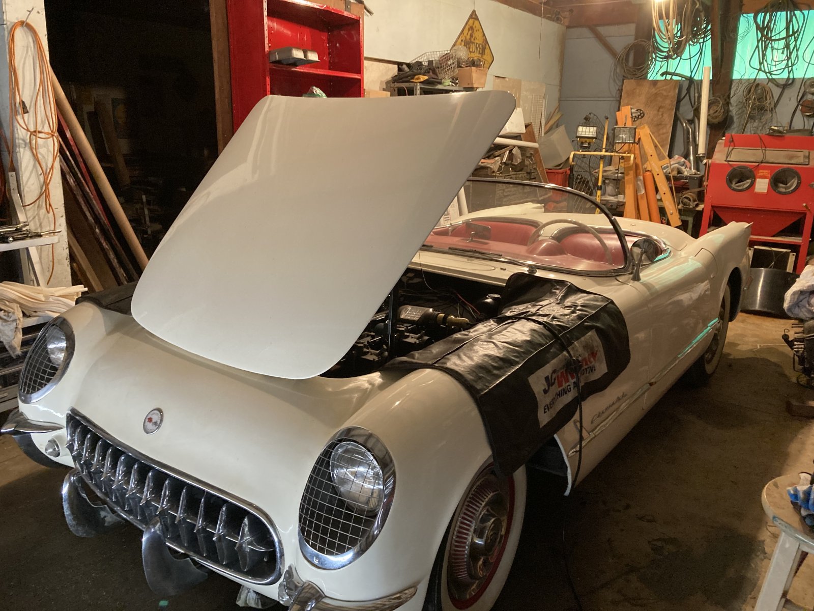

    does the car have automatic chokes? it sounds like a sticking choke problem to me. make sure when the car is warmed up that the chokes are wide open.. I can't believe all the people here lobbying to keep cars stock... I thought we were hot rodders here??

    Well Trent, did the mechanic give you a “health” report on the engine?
    It’s been mentioned I’m sure, but …
    intake vacuum at idle and then again at say 2500 RPMs.
    Dwell setting, plug gap and what they looked like. I could go on, but just home from my night shift;) and will start babbling soon.
    But think about this
    Cost of an engine. You mentioned a 265 or 283. A fresh one is most likely not available, so several months in the machine shop.
    Then there’s the exhaust, what’s needed and has to be done for it to swap in.
    Will you need a carburetor, distributor? You will need a fuel pump, all accessories and brackets for the V8 to work.
    Is the radiator adaptable to the V8?
    Then there’s the fuel line routing.
    Wiring should be okay.
    Now I understand your grandfather is 80, he might recall the day when it was common and a weekend thing to go find a low mileage 265/283 and do a weekend thrash and have some fun.
    He has 20 years on me and I recall those days as well too. But everything we needed was available at the local yards and wasn’t that old when we used it.
    I’d bet you’d be into 5k bill minimum, to swap a V8 into that car, and it would be 2022 before it was on the road.
    Maybe let folks know what area you’re from and some guys might know who you should contact to get it running right, or at least tell you what the issues are and how or if they can be dealt with. Heck. The engine may be dead. It is near 70 now.
    Night, er,… morning? ;)

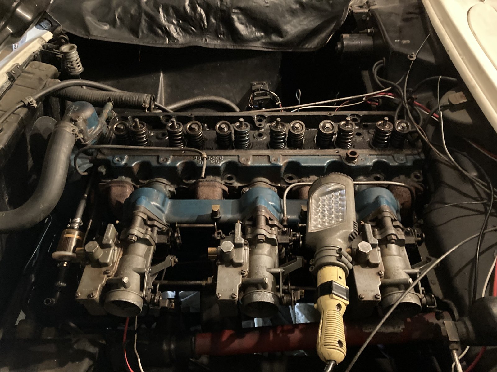

    But concerning the original triple carb six running rich:
    Three major possibilities:
    (1) Electronic distributor conversion without upgrading to an alternator!!!!!!!!!!!!!
    (2) Parts house carb kit (fuel valve orifices too large)
    (3) Electric fuel pump (too much pressure for stock orifices)
    Now if you combine any two, or worse, all three.........................
    The Carter YH carbs, if properly rebuild and adjusted, run great AND are reliable.

    Had very little time on first post. Adding to that post:
    In the 1930's Carter developed a "spring-loaded needle and seat" for both off-road and marine use. The original Carter YH number 2066s carbs used fuel valve number 25-228s which is one of the special spring-loaded versions.
    The seat is the same as a normal seat, but the needle has a small vertical hole machined into the top into which an even smaller conical spring is inserted. Sitting on top of the spring is a pin that resembles a miniature golf tee. The spring tends to cause a much more even fuel level in the bowl.
    Not saying they do not exist, but I have yet to see one of the cheap FLAPS rebuilding kits that contain the spring-loaded fuel valves; as they are significantly more expensive to produce than the standard fuel valves. These are absolutely critical in the YH, OR the carburetor WILL flood.
    Even if the proper fuel valves are used, another problem which may arise with someone not familiar with these. When the spring-loaded valve is used; the float MUST be adjusted by taking the measurement with only the weight of the float pressing on the spring. The spring MUST NOT be depressed by the "mechanic's" finger. Obviously, spring fatigue would result in an incorrect fuel level.
    Since the YH is a horizontal carburetor, absolutely essential that correct parts are used, and correctly adjusted.
    Jon.

    Friend of mine cured a lot of the carb problems on his 54 when he installed a pressure regulator on it. Most of the time before that his problems were due to lack of driving the car. He sold the car after owning it for many years and bought a 32 five window. Drives the snot out of that one! D

    They had a choke that had one pull mech. on them connected to three cables.

    so have you checked to verify when the choke is pushed in that all the choke blades on the carbs are fully open??

    I'd second the motion to send the carbs to Carbking and have him go through them.
    Or at least pony up and buy the correct kits from him. I've used at least one of his kits and there a difference than what you get from the parts house.

    I just answered the post. Another guy is working on this one. BTW, I forgot to add that I modified the choke cables on my friends car. Originally the three cables came together in the center of the choke pull. Even lubed real well they were a bitch to pull on or push off. It helped if you pushed down on the gas pedal taking the tension off of the idle cams. I separated the cables and made a couple of plates to attach them to the push/pull mechanism, worked much better and still looked correct from the dash side.

    Yeah no you really didn't, the competent part. Even if there's something esoteric with the carbs he wasn't comfortable working on he should have been able to diagnose the problem. And I wouldn't bet $100 it's in the carbs, or it could be as simple as a piece of debris under one needle.
    When you say it starts fine then when does it start running poorly? Will it idle indefinitely? Is the problem time dependent, heat dependent, or engine load dependent? Let's do some actual diag here.
