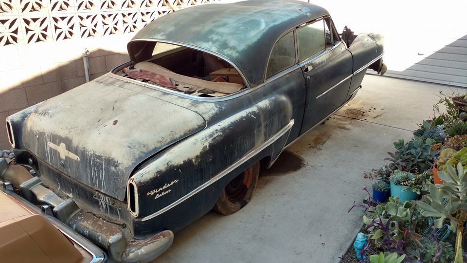

  1. I haven't posted here for a long time. I just picked up a 1954 Chrysler Windsor Deluxe Newport two-door hardtop. It will eventually become kustom, but first I need to get it running. I have a 1977 Thunderbird to sell and a 1960 Chrysler to sell so I have funds to build this new project. So far I plan to remove the 383 Golden Lion from my '60 and install it in the '54, I want to maximize my dollar spent in getting the drive train installed and I wonder about updating the rear end and front suspension so that I can have disc brakes compared to just restoring the stock brakes. I don't have much experience in what would work best and be spending my money wisely in the first steps of getting my project running and driving. I'm open to suggestions and your experiences in upgrading drivetrain and suspension affordably also taking into consideration the ease of finding parts for future repairs.

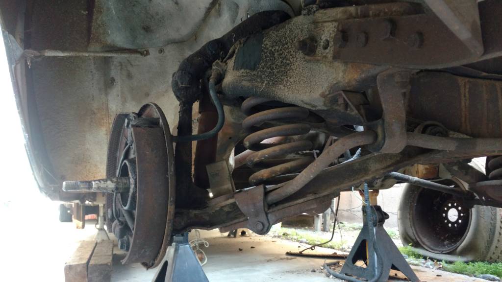

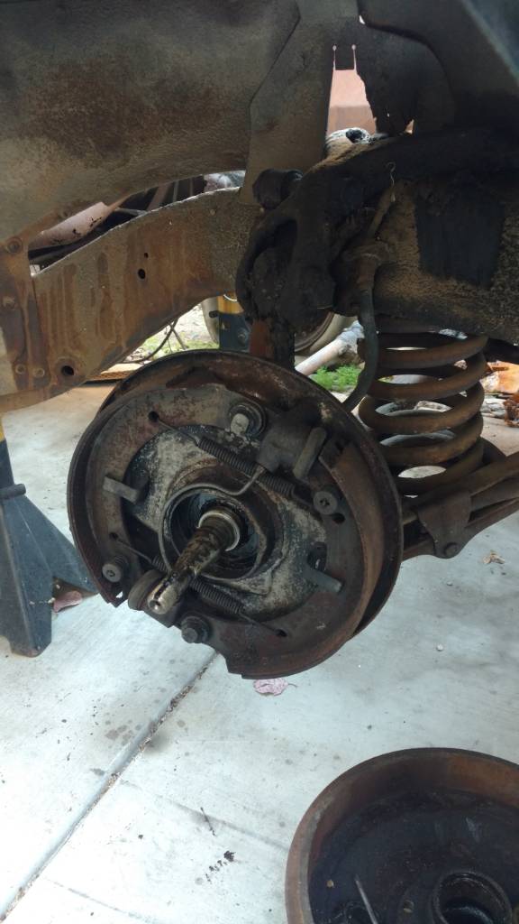

  6. I'm trying to remove the drum so I can measure the spindle for a disc brake conversion. Do I need a puller for this? These are stuck tight.

  10. Mike.....nice car........the front drums should just pull straight off once the nut is removed, maybe the shoes are stuck to the drum, try a moderate tapping around the drum with a hammer.....do the drums spin or are they stuck fast?..........as for a disc conversion..........there was a long discussion regarding this on a early 50's Chrysler a few months ago on the P15-D24 Forum.........I'd strongly suggest you join it as there are some very knowledgeable guys there.........anyway as for the disc conversion, from memory the upshot was that I think that the stub axles are different between the Plymouth/Dodge front end and the Chrysler one..........however we found that the Plymouth upper inner & upper A arm would swap allowing the Plymouth spindle and stub axle to fit for which there IS various disc brake adaptions made............as for the rear end I'd swap out the complete rear axle for a late model one, ie, one with the parking brake built into the drums and with easily removable drums............the mopar rear ends with a tapered axle drum and the large centre nut require a VERY LARGE PULLER...the biggest you can find, unless you are doing a 100% resto then swap the whole rear axle.........also what steering setup does the car have?........the weight on the stock front suspension will be fine, I have a 318 Poly in my 1940 Dodge with essentially the same front suspension as your Chrysler, and the same cast iron Toqueflite as you have but I modified a Valiant shifter to operate the push button cable, tho' personally I'd use a later engine & alloy trans, but mines been in the 40 Dodge since 1973........lol....... ..regards, Andy Douglas

  12. Mike .The front brakes should come off if they are backed off. The rear brakes you will need a puller .I know I needed one for my 56 Chrysler Windsor. Bruce. 002.JPG
    Kustomike likes this.
  13. Mike.You need the old fashion puller for your rear brakes.Bruce. 001.JPG

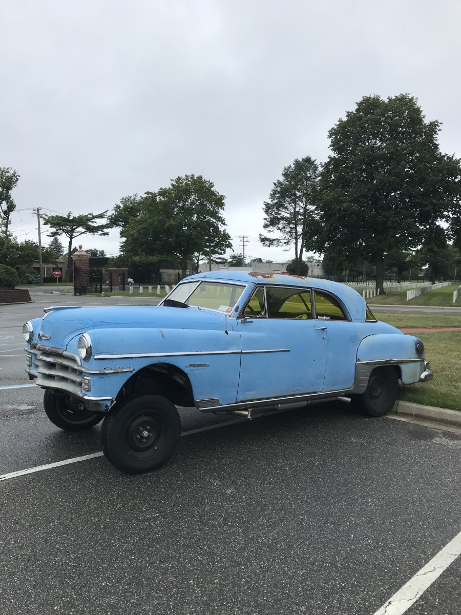

    How you making out with that build? I have same car 1950 windsor newport with straight axle front end, 340, 5 speed.
    Next is an axle swap, searching for stock WMS dimension. My flange to flange is 55 3/4”, so i’m curious if your’s is narrower or I fudged measuring.
