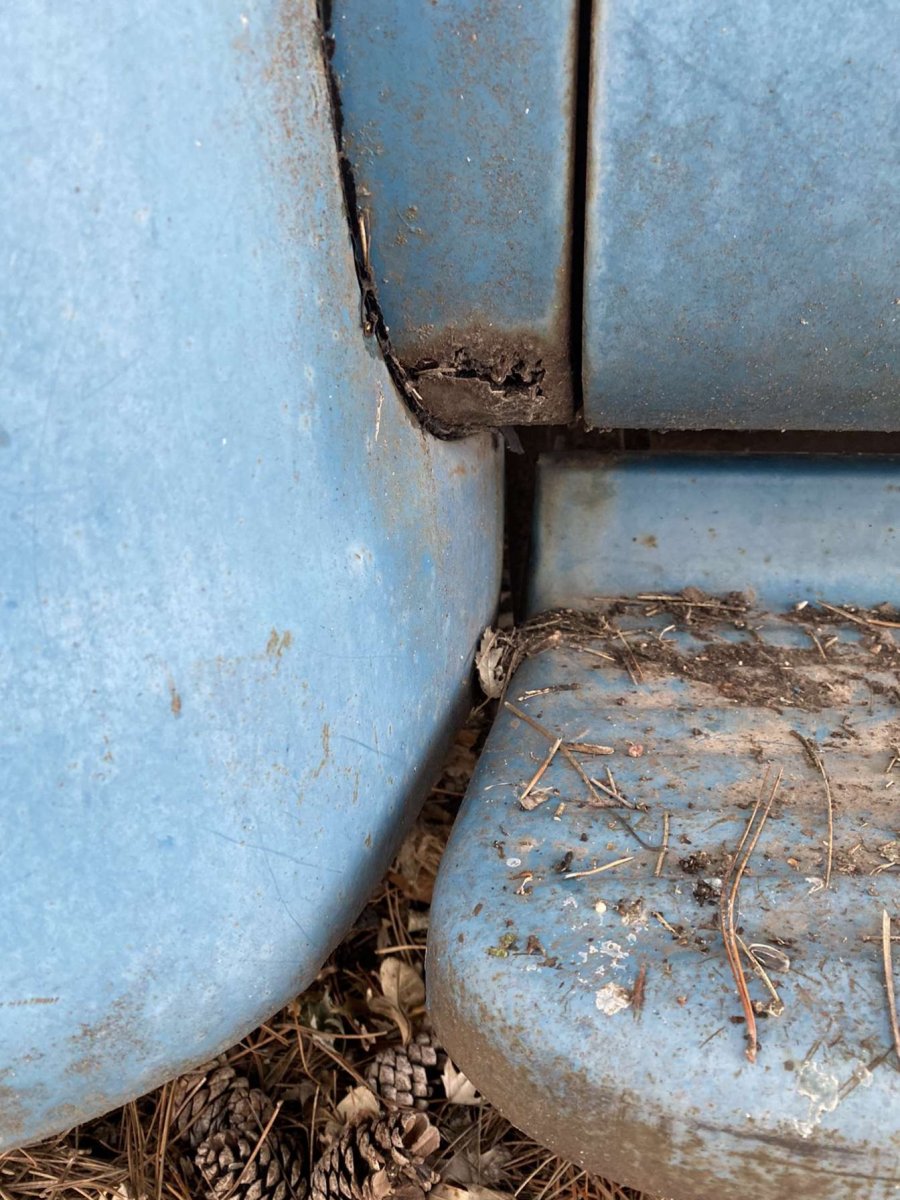

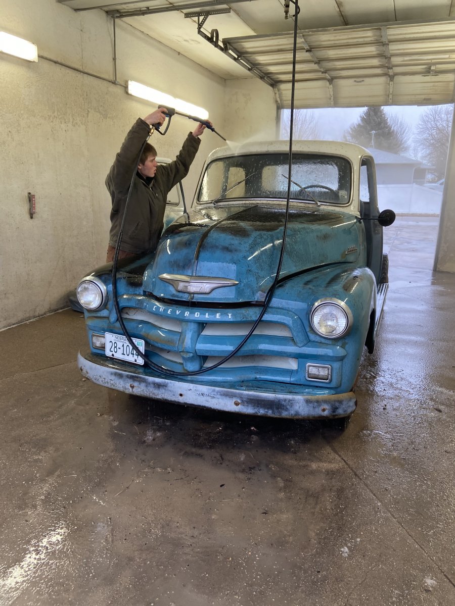

    This weekend we started the processes of removing 50 years of dirt buildup to repair the rust. the floors, inner cowl panels and the driver side cab corner are all rusted out. Here are some pics of the truck as it sat in the trees and us prepping. Seat had been taken to interior shop to get redone. Removed door for easier access. Tried powerwashing Sap off with no luck. Any suggestions? 0DFE6A46-2AEA-4F8C-A808-137CE4756872.jpeg 6DA618C6-5C69-4553-8977-9CEC25E3F3DF.jpeg 42C0058B-B10A-455B-A0F0-075D3E31E423.jpeg F4D529B7-6D7D-433A-9A2C-C400A5A5E1A3.jpeg
  4. Budget36
    Joined: Nov 29, 2014
    Posts: 9,060
    Budget36
    You'll need a pressure washer that can heat/steam the water.

    Try dish rags and Dawn dish soap. Don’t use cheap soap as it’s diluted. The “ power degreasers” maybe too hot for the finish and too hot on your wet hands. It really helps to soap it up and let it sit a while.

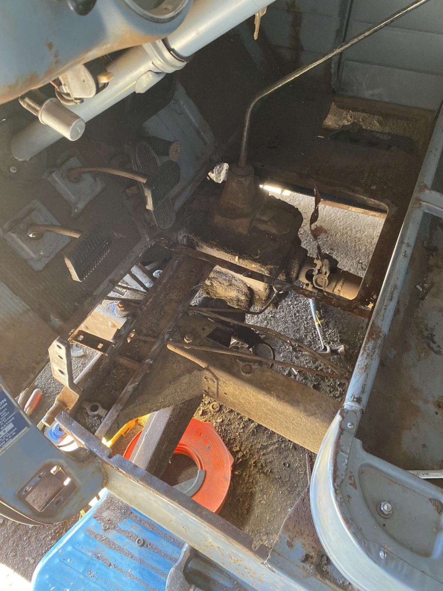

    Those I believe mount the cab to the frame. My brother took the pics. Will be a late night tonight. We started to remove the driver side floor 46749263-0A81-41B1-9A83-5BA995BB0700.jpeg A94CE2EF-C81B-4EBC-8AB7-E3F8361DE049.jpeg this picture might answer your question Indigo.

  16. Laquer thinner might dissolve the tree sap and probably your paint also.
  17. tractorguy
    Joined: Jan 5, 2008
    Posts: 730
    tractorguy
    Maybe try turpentine on the sap ? It may cut it and not damage paint.

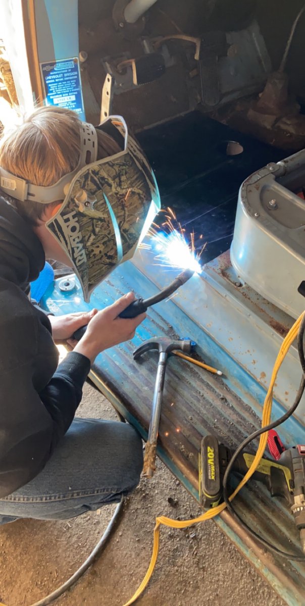

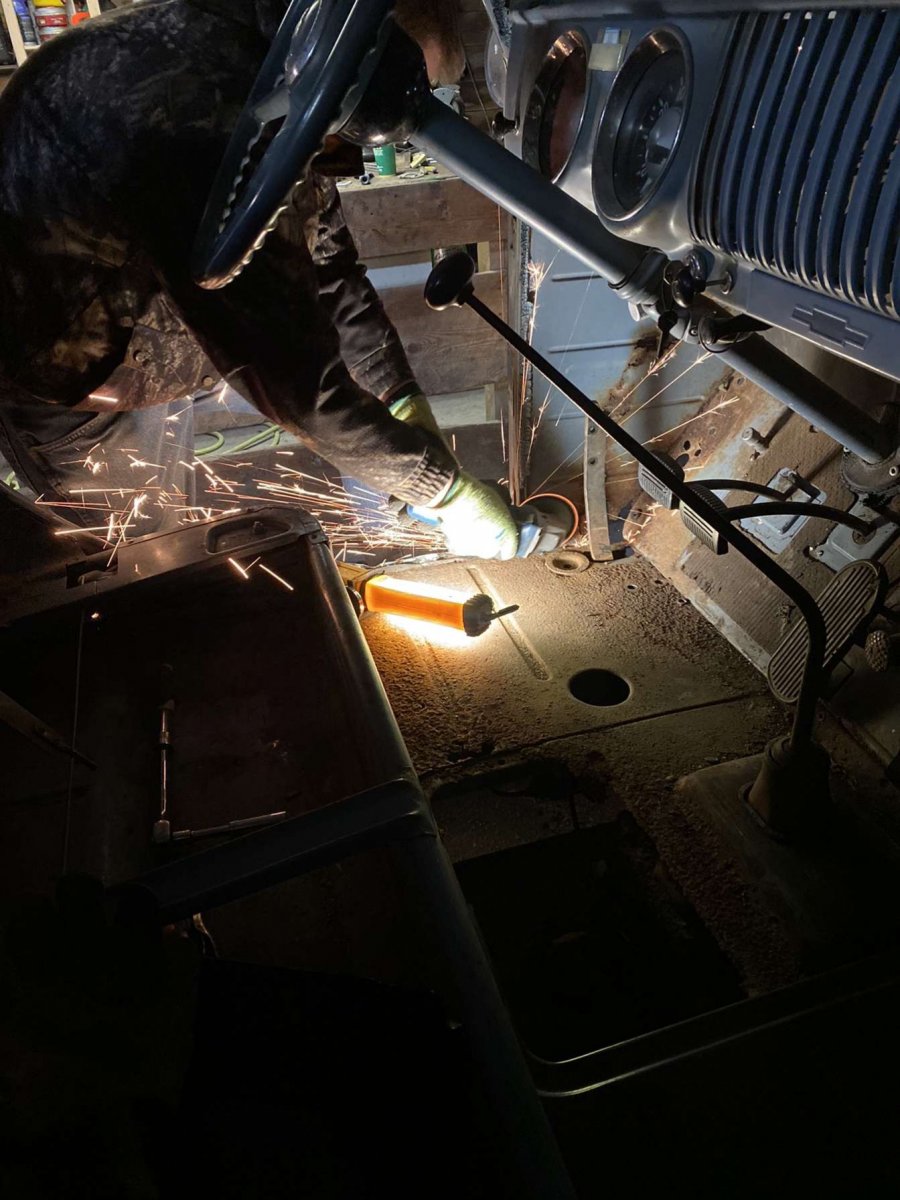

    Will try the methods listed. We will have to use plenty of elbow grease. Tonight we are welding in the new floor pans. Making sure to take our time and make sure everything is lined up correctly. Notice inner cowl panel removed. 3A35943B-676D-46BD-9062-B54A5D9517AB.jpeg 2488373A-AADD-4FBB-BF19-F80F9905CDE3.jpeg

    I cut up a huge balsam tree so I ended up with a thick layer of pitch on my hands and a chainsaw covered with pitch. I tried some 70% isopropyl alcohol. It cleaned my hands perfectly and then I wiped down the saw. It worked amazingly well. Thinking in hindsight that alcohol is used to soften shellac and liquifying shellac so it can be used. Shellac is solidified pitch. Now isopropyl is my go to when I get sap on anything and it needs to go. The isopropyl is easy on finishes and worth a try. We buy it at the local pharmacy.

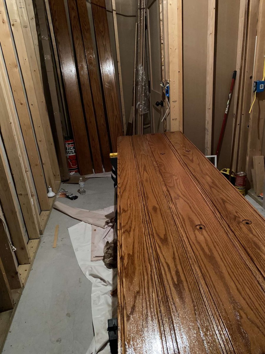

    Stained the bed wood kit this morning, had the holes predrilled for the offset washer. Should make installing easier. We used this product and put about 3 coats on we had to stain in the basement unfinished bathroom to keep the temperature up. Made the whole house smell of stain. 1DE50E7B-7BDB-4467-A602-9B5B957B8F3F.png C4CF67AB-8079-4EF9-AA83-C966F55D7011.jpeg
