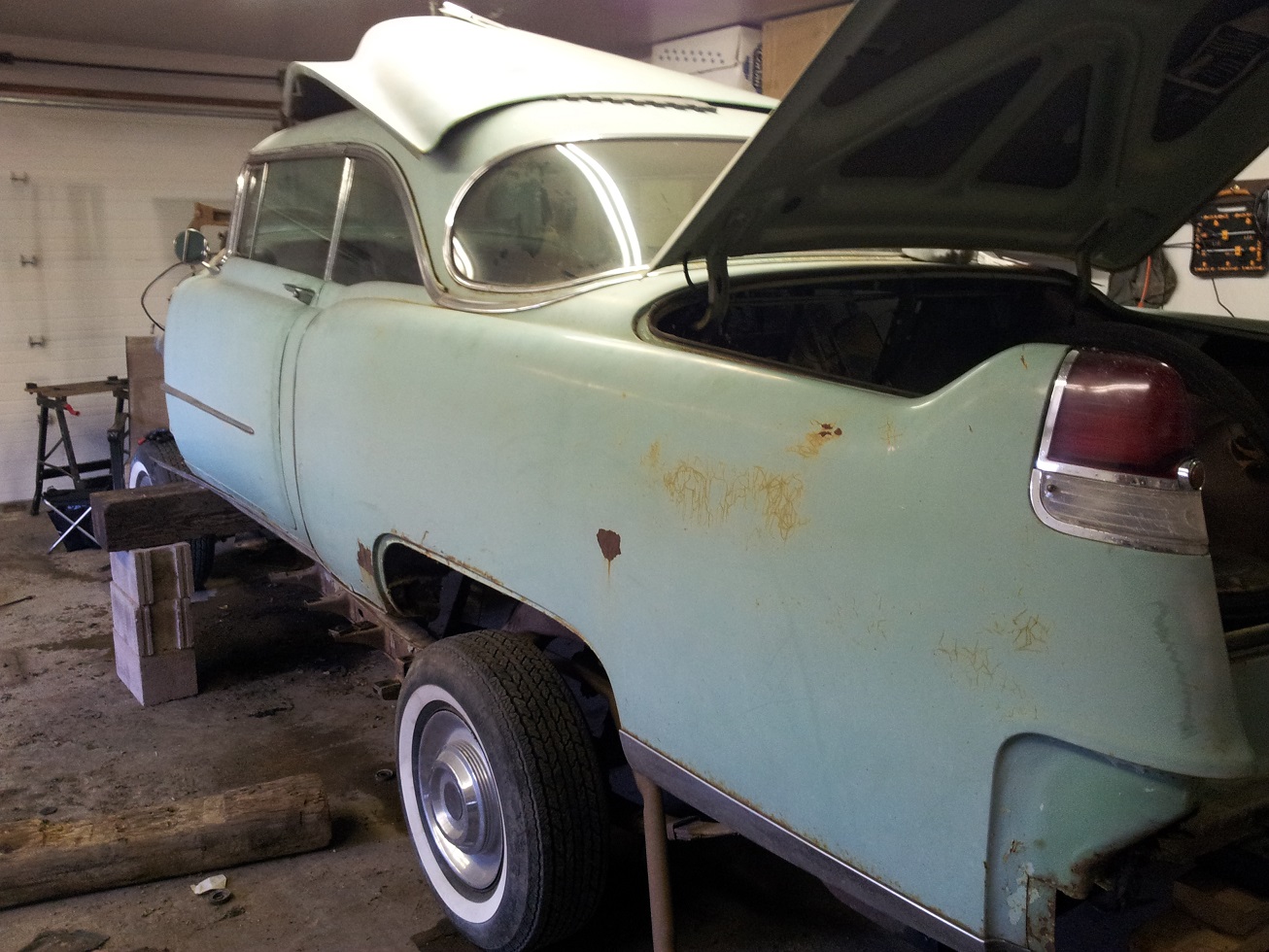

    So I have been agonizing over this project for a period of time as I find myself at a bit of cross purposes. Recently I purchased a fair decent and mostly complete 1954 Cadillac. My intent with this car is to keep it 'in the style' of a 1950's cruiser but to feel confident about heading out on a 500-600 mile road trip without the worry of having to search for 60 year old parts in the middle of no where. I presume a sentiment that is shared with many here. This car is not to be a restored trailer queen. It will be driven, and I completely expect it to go there and come back, barring the usual vagaries that follow any endeavor of this kind. Having read through the "best 1955 Cadillac build" and a number of other similar builds of cars of that generation my end goal is to accomplish something similar to 'Dan's Cadillac' that you see in the 55 build. My plan is to follow pretty closely the path set out in the 55 build but not necessarily include some of the accouterments that are found on that car, scoops, extended fender skirts etc. So here's the rub. I want disc brakes, ease of access of parts in case of break down, newer steering parts and so forth. That seems to indicate a clip but honestly I'd rather not. It isn't only the fabrication issues, those I can over come, but it is then creating a level of complexity that I am hoping to avoid. Then there is the engine issue. I have a rebuilt 454/700R that is turning out some decent numbers and in my mind just plain suites the caddy. Big engine, big car, big torque, good combination. If I do this I feel like I am forced into the clipping corner. As of yet I haven't gone mad with tearing the car apart because I would like some input from those who have gone down this path ahead of me and may have some thoughts I haven't considered. As well I intend on doing much of the work myself. This isn't my first rodeo so the level of difficulty doesn't worry me but I also don't want to expend countless hours heading down rabbit trails that will produce only spent money and disappointment. So HAMB'ers let me hear your thoughts on how to proceed before I go lighting up the torch.
    Cheers.

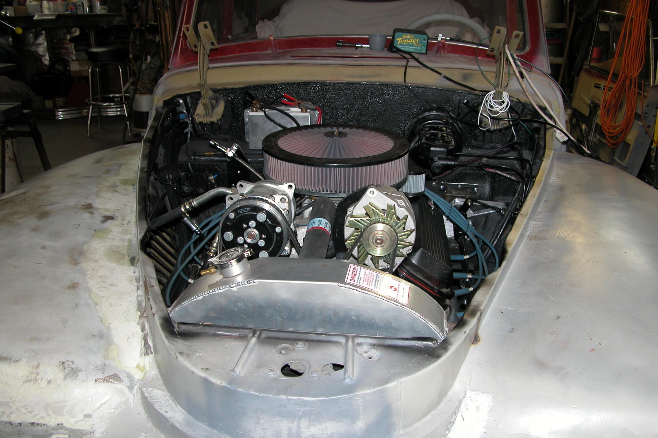

  19. I don't know if this helps you, I have installed a BBC & 400 auto in a 1946 Lincoln Continental for the same reasons. This compartment may be longer and more narrow. I really don't know, but here's a couple of pics,

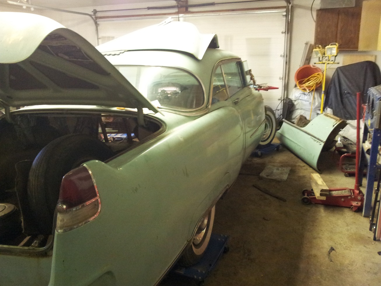

    So I have been gone for a bit but I did get a little done on the car this past week end; with the help of my faithful shop dogs who are already good to go for our first show. I have a wounded paw so I have been side tracked as the stitches heal. My stand in 'right hand' refuses to have her picture taken but she did get in there and get a fair chunk of the front off. Hopefully next week I will get the front clip off and with a little bit of luck separate the frame from the body.

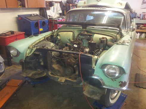

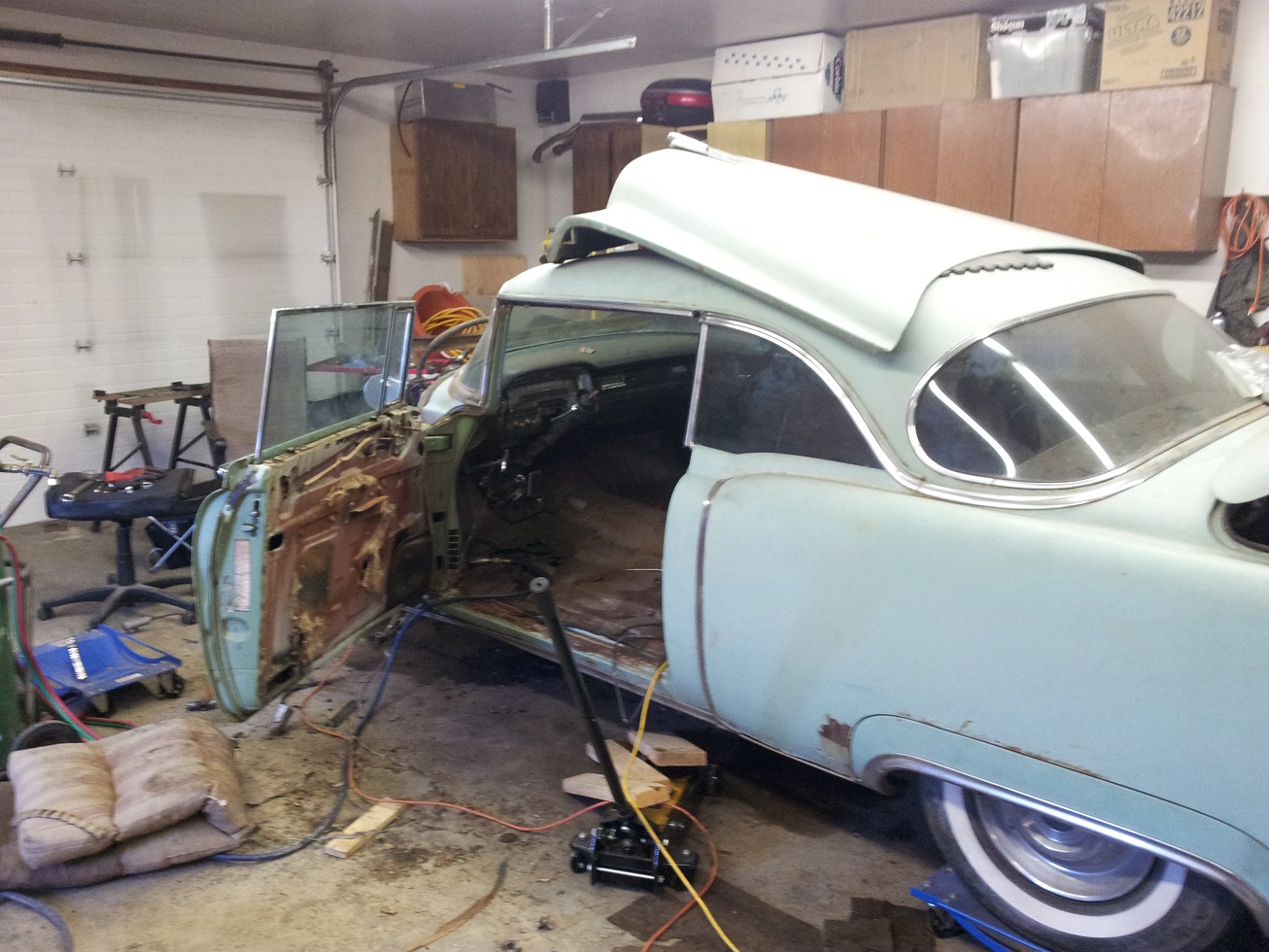

    Been back at the car after what felt like near forever for my hand to heal. It became infected so I was down longer than expected. With that said I have made some progress. Interior is out, front end is off, and I should be able to lift the body from the frame once I am back to my garage. However I am stymied at this point because I have been out done by a steering column. Unlike the 55's that use a soft coupler to join the steering column to the box the 54's use a direct connection to the steering box. I have read the manual about 2 dozen times and still I can't figure out how to liberate the steering column. Any suggestions would be great. Sorry no pictures. I thought I had some on my phone. I will post some soon.

    I have been able to get back to the build. Still pretty earlier. Some tear down shots. Hopefully by the end of today the frame will be at the sandblasters and the engine will be sitting on my stand.
