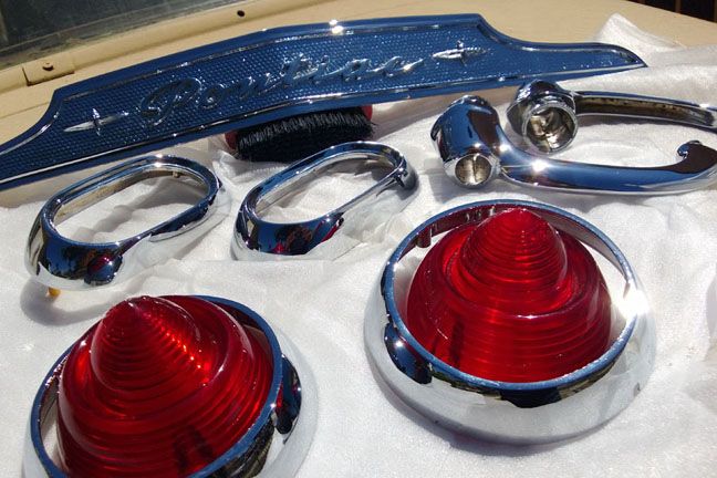

    Got a nice surprise text message from David over at David's Polishing in Motebello, Ca..
    It was a sneak peek at my pot metal pieces that are almost finished, I should have them within a day or two. Thought Id share my excitement with you, as I'm pretty excited about the chrome!

    Got a call from my polisher's that a few of my pieces were finished, so I picked them up and brought them home.. "I'm thinking of shaving the doors on the poncho so those handles might be up for grabs soon" I'm extremely satisfied with how they came out and cant wait to get the rest...

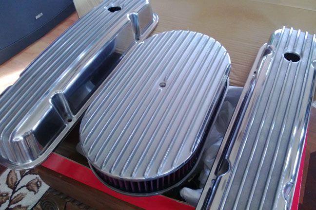

    Not much of an update.. I've been bored fellas. I haven't really done much, but I did get a few goodies for the engine to dress it up a bit.. I figured even if its not the progress I wanted at the moment, its progress none the less...lol... Here are the Valve Covers and Air cleaner I decided to run with...
    I went ahead and put some of the trim back, I'll probably be painting the roof and dash in the next few weeks... Im hoping that will get me pushing even harder to get me on the road
    And last but not least... I finally found the parts I need to convert the Trans.. stay tuned...LOL..
