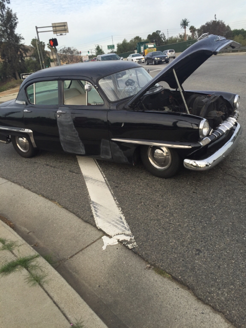

    Hey guys. I acquired a 53 Cranbrook and I was trying to sell it but no one bought it so I'm going to build it. I was driving it for a while on the stock drivetrain and the engine took a dump so now I'm in scramble mode to get it back on the road. The plan for now is to get it on a modern chassis and a more reliable drivetrain. S10 frame swap using the power brakes, power steering and a 350/350 combo. Should be fun. ImageUploadedByH.A.M.B.1462680654.355229.jpg ImageUploadedByH.A.M.B.1462680670.971315.jpg

    Upon further inspection of my six I found that a large piece of sludge had plugged up an oil hole and starved a rod journal or I wasn't getting enough oil to a wrist pin. Motor won't turn at all.
    The six is done. The block may still be ok. It's been bored 40 over already. It will be cheaper for me to swap than fix. Most of the parts I have laying around. Definitely a budget build. Plus when it was driving it was all over the place so vice replacing the entire suspension anyway. This is the route I'm going. Cheap to find parts too. I'll have to cut a section out of the frame for sure and build new body mounts. Probably build the steering with u joints. As I go if anyone is looking for parts let me know.

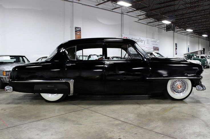

    Drop it, put some white walls and imperial wire wheels on it. Add skirts, hop up the flathead and add two rows of
    louvers in the hood. My 2 cents.
