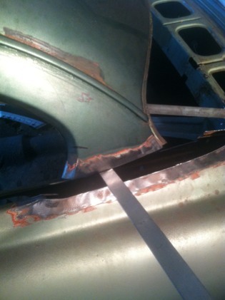

    Ok so worked a bit on the car tonight found a bit of rust that will need patching in the quarter panels on the drivers side between the door and rear wheel opening and on the pass side in the wheel opening and a few inches back probably gonna have to make a panel for drivers side and buy a patch for pass side along with new rockers any way got all glass removed
    Galvanized and riveted patch somebody put in that needs removing

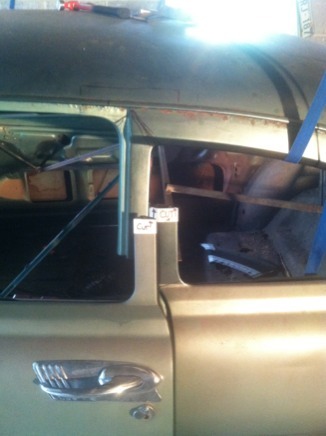

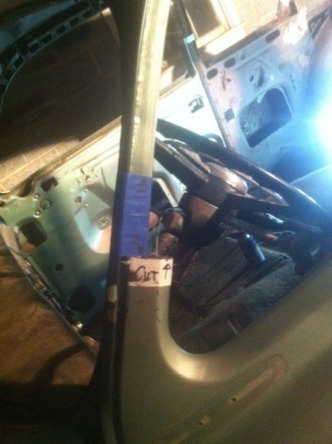

    Started measuring and prepping for lowering the roof ... Looking like 3 up front and 5 in the rear got it all taped up measured again and the door frames cut tonight more tomorrow I hope

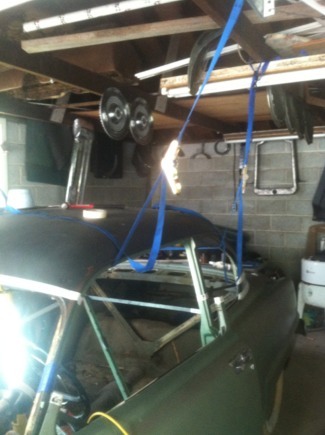

    And got all the braces in now time to lop the top no going back now haha ... Also since I have no friends and my girlfriends son is only 4 I had to to some creative problem solving with lifting the roof so some ratchet straps have become my new best friend I think it will work out rather well
