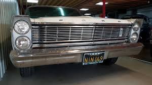

    does anyone recognize this grill? i dig the way this car looks

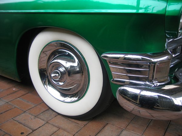

    cleaning up some original 49/50 Cadillac sombreros for the 53! gotta figure out what to put in the centers still 20190610_095735.jpg

    Get some 3" domes

    I believe you may need special wheels to properly mount Sombreros.

    yeah, im customizing them, going to epoxy and pop rivet or glue the ford dog dishes on the back

    I had '55 Olds Fiestas, centers rode on the rim centers. Fix is mid-50s International pickup 15" wheels, 5 on 4.5" pattern, deeper 'dish' is prefect for 'shallow back caps'.

    Here's how I did mine. ..first you have to grind the nubs off that hold the stock ford cap on (don't worry, it won't hurt a thing ) . Next drill out the spot welds holding the large cap to the back of the Caddy wheelcover. The plastic medallion or a chrome bullet will cover the holes. Next take a 15" trim ring (I used 49-50 Ford ) and make one cut inorder to spread it apart. Tack weld the trim ring to the outer edge of the Candy wheelcover. Tack weld three even spaces around the cover. You can Tig, mig, or braze the tacks. Done correctly they will not show or discolor the cover. If there is discoloration, just polish it out. ...it's stainless. This technique has been on my car since the 50s with no problems.
