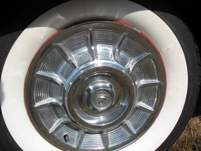

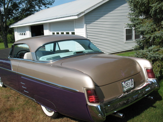

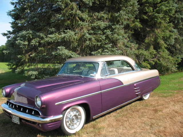

    IMG_0888.JPG IMG_0889.JPG IMG_0887.JPG IMG_0886.JPG Here's mine. 55 Pontiac side pieces, 54 Merc taillights and 1/4 panel ends, 57 Caddy caps with Mercury Comet gas caps for centers, Caddy interior, 351 Windsor and C6 tranny and 9" rear. Tom... IMG_0888.JPG IMG_0889.JPG

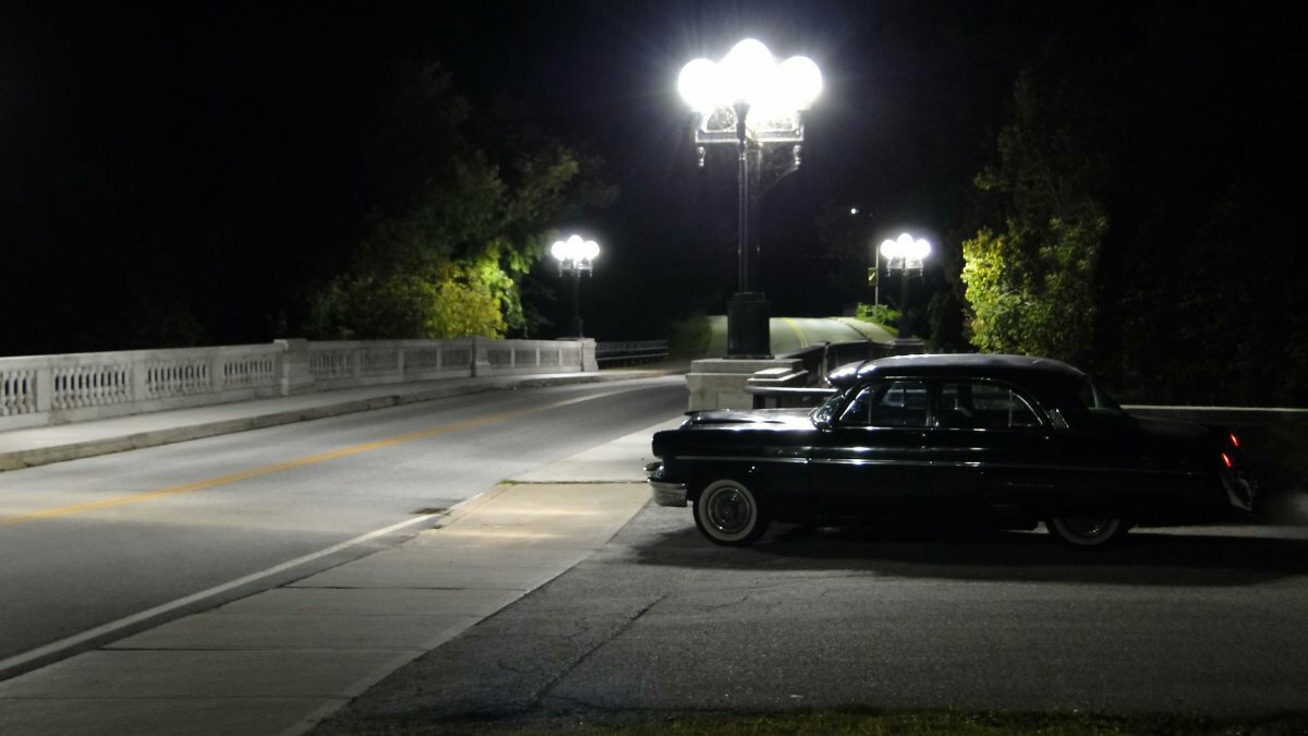

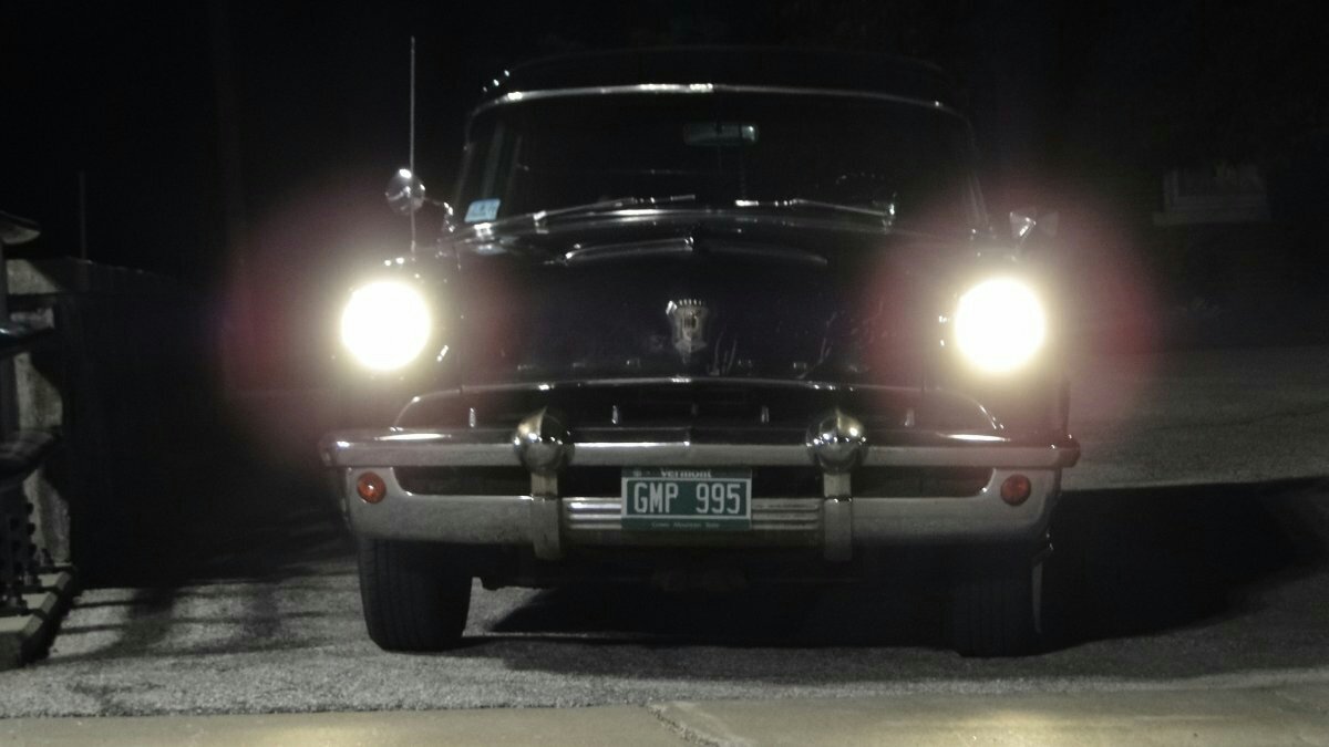

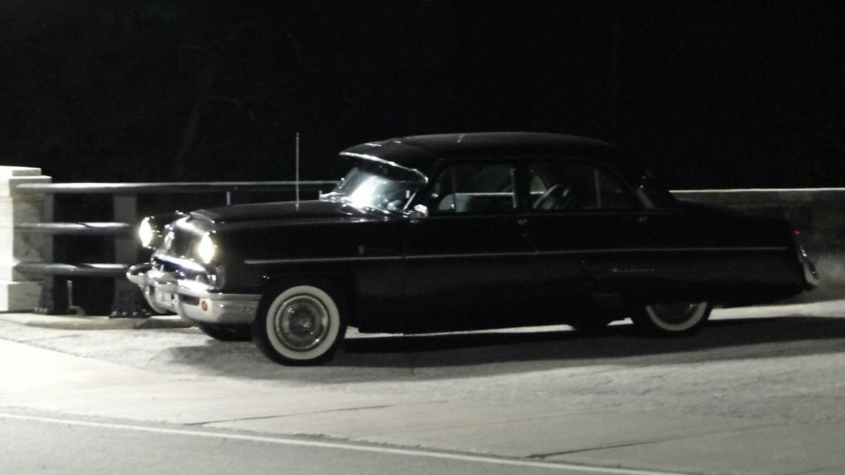

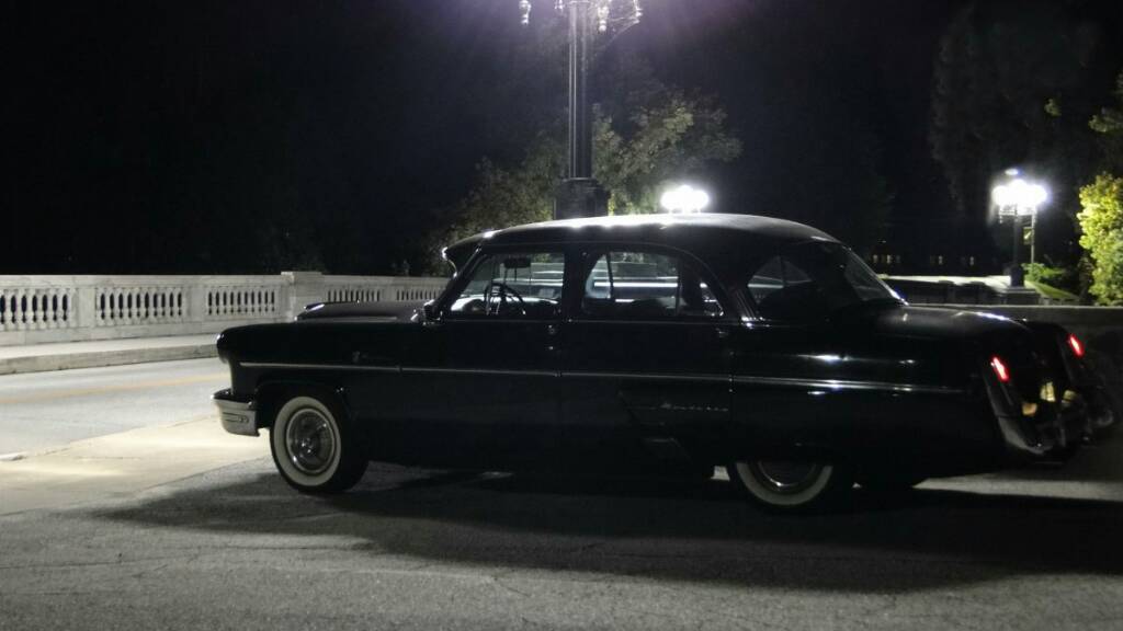

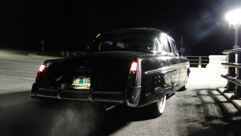

    Took some pictures last night to spruce up the thread a little.
