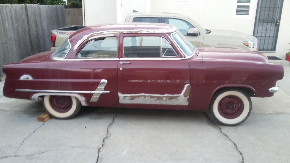

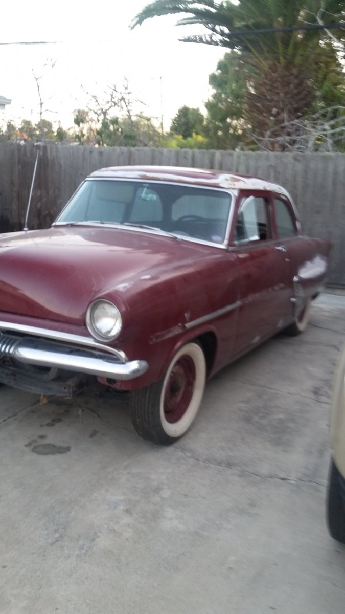

    So I just picked up this 53 for 1500, . I got the original flathead with it but its taken apart I can have it rebuild or what would be good to run in it, 289, 302, 351, I have no clue what will work best. I got a great deal. the interior is like new. bumpers are newly chromed, the only rust is in the passenger door from a old repair, car was restored about 10 years ago for shows then sat in a garage. anyway I'm trying to figure out what the best motor to put in with the lease hassle. Any suggestions would be great thanks 20171011_180754.jpg 20171011_180634.jpg

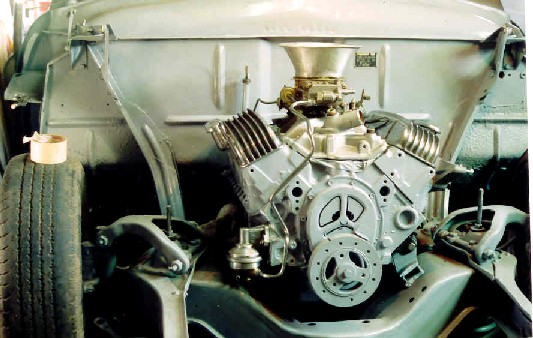

    I put a 289 in my 49. With the right oil pan, it's as easy as a SBC swap and you won't be embarrassed to open your hood.
    I used an early 289 and kept the original trans 3spd w/ OD. Simple and cheap swap.
