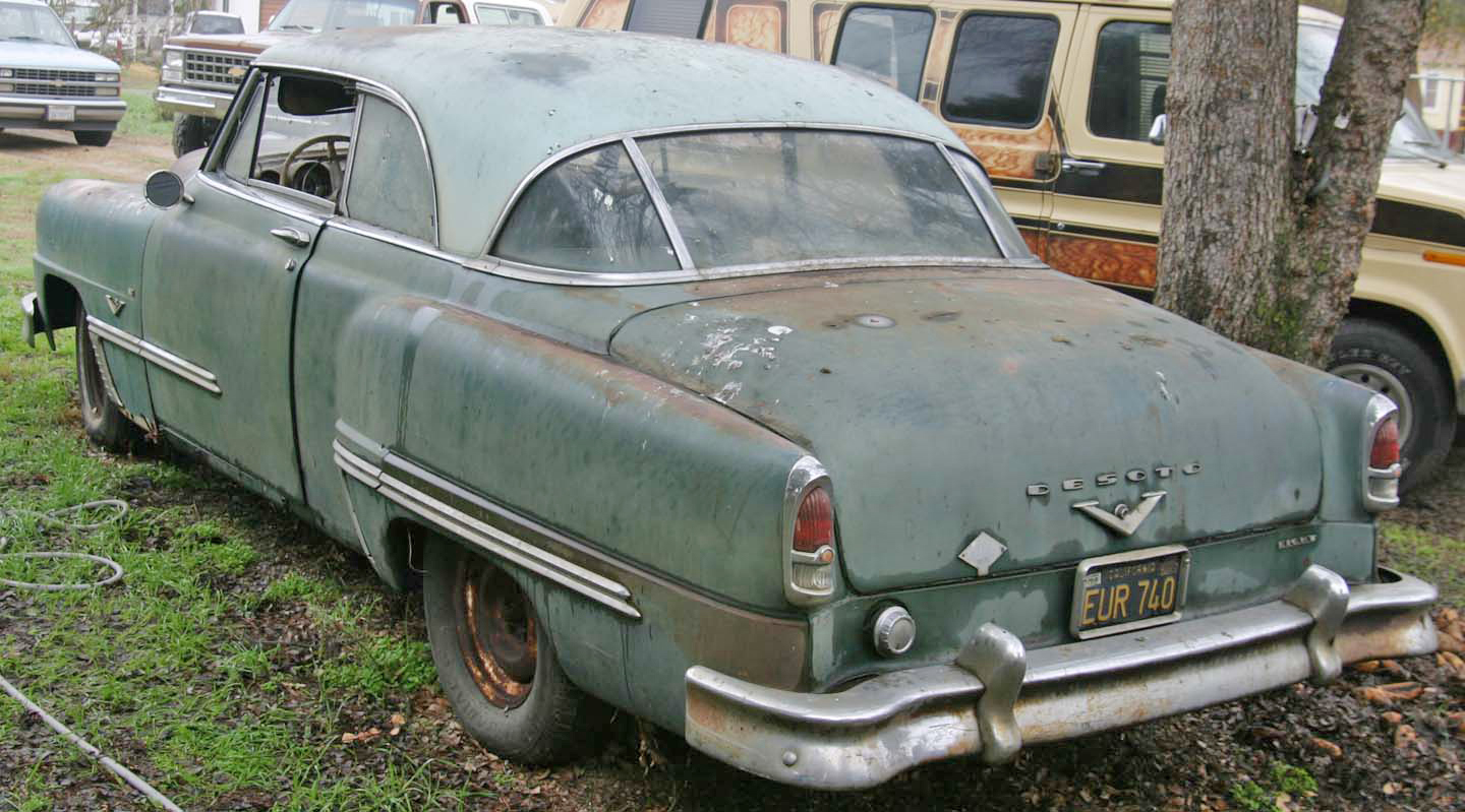

    I think it looks good with the desoto back glass. Probably more work than the 49 ford back glass though.

    @desotot well, we are moving the roof forward a few inches so the A pillar matches up. So it changes everything int he back area and makes the stock glass unusable as far as I'm concerned. It looks like they leaned back the A pillars on this Photoshop version so the rear glass works better.

    4" to 4.5" chop is the goal. Will use the same rear glass as the Royal Victoria. Rooflines should look the same when done. We did kick around the idea or using the stock glass and sinking it into the body but it still would have have the look I'm after.

    Chopping that roof using the stock rear window does not involve sinking the rear glass. The common practice with 3 piece rear windows is to lay down the center section and fab up some lexon corner pieces. That's the way that the Larry Ernst Chevy Bellaire was done by Barris back in the day. No leaning of the A pillar was done either.
    The other way it is done is to slide the rear window forward and to extend the "Cat walk"between the trunk and the glass. When you bring the rear of the roof down you cut the new window opening up into it .There is quite a bit of crown in that roof right above the rear window that allows for this method.
    I'm sure that what ever you do it will look great.
