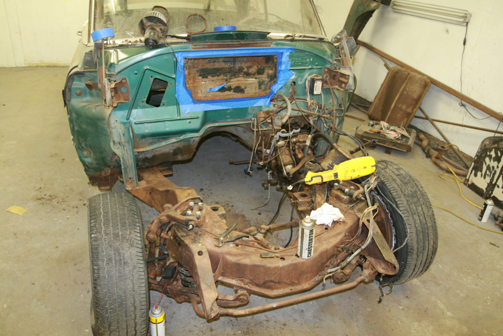

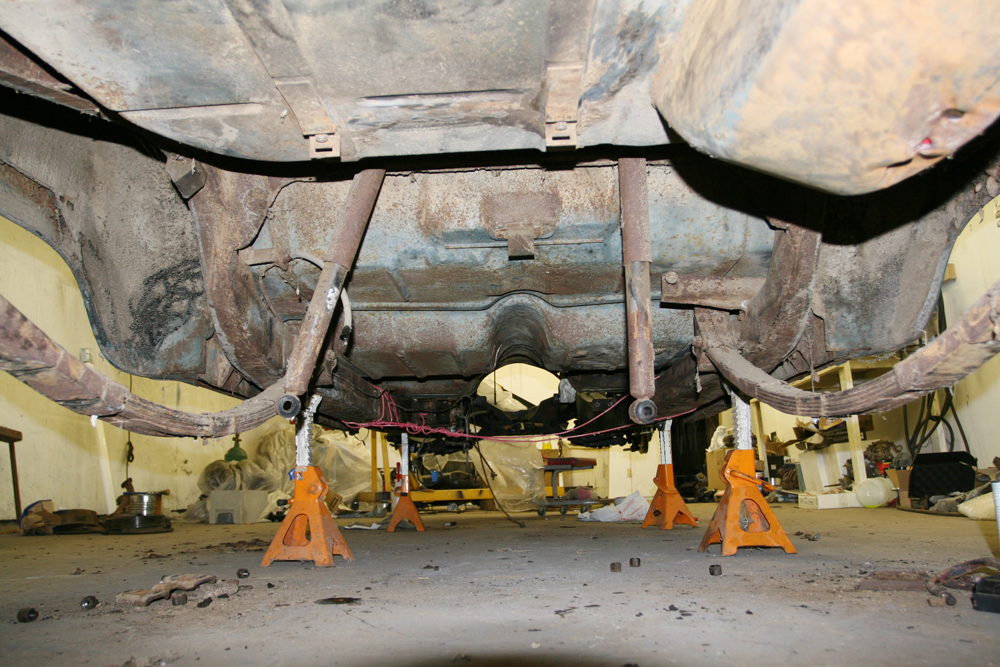

    @plymouth1952 Thanks, the rear end was updated already. Just playing catch up with the pics. I put a 8.75 in it out of a mid 60s car. Matched the length perfectly, just had to move the perches for the sprints.
    Most of the garbage is off the frame. Did some pressure washing and a lot of wire wheel.
    Out with the old.
