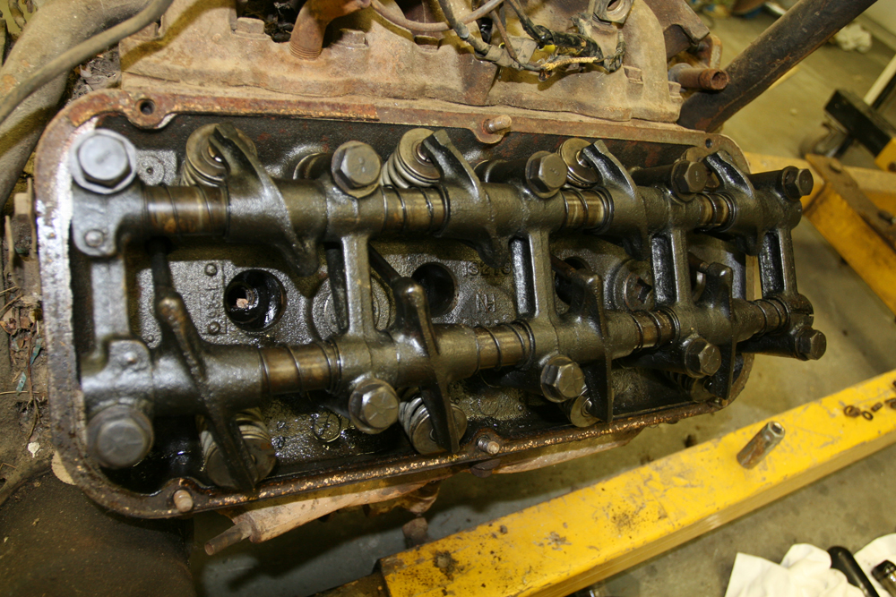

I pulled the covers to see what was going on. Was much cleaner than I was expecting. Covers went back on as I began the cleaning process to get it ready to repaint and reseal with new soft gaskets. Other than the rear main seal and the head gaskets everything was replaced. Don't want this thing leaking. The bottom of the engine had the same nasty hard crusty coating that was on the whole frame and under carriage. Lots of scraping and wire wheeling and for the smaller parts I could take off, glass beading. The vent tube is coming off and the oil filter is getting updated to a spin on style from Hot Hemi Heads. They were a huge help and explained how to convert to a free flow oil system. This required pulling the rear main seal and oil pump and then removing the cage and ball that are up inside. The ball came out easy, the cage not so much. But with some tools to help it along it all came out and went back together with a new pan gasket. You can see the wiring harness thats near the distributor. It connects to two switches on the carb that run down to the side of the transmission. This is what tells it to shift. Pretty interesting design.
Looks surprisingly clean! Assume you put the block off in where the anti-drain back check ball was... Installing a PCV valve in place of the puke tube is a good upgrade. Also the company's name is Hot Heads by the way.
Okay, well its HotHemiHeads.com forgive me @George Honestly its been a few years since I did this and am going from memory, which is kind of scary. Hot Heads walked me through each step, I purchased the external screw on unit from them. They were really great to deal with and I would recommend them to anyone. I don't recall putting in any block off plate, if I recall their directions were to just remove the check ball and cage and then install their unit and it would would properly. But its been a few years like I said. Oil pressure is good and all seems to work fine. I've ran it quite a lot. Someday I'll get to drive it.
@George Yes, motor is together and running. The engine did not get rebuild. It ran well enough so I just cleaned it up and replaced all the soft gaskets then repainted it. All the external bolt ons received a rebuild.
