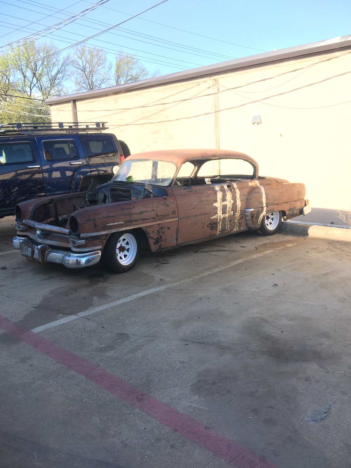

    Taking more time on this door to make sure everything stays straight
    Tacks on tacks on tacks
    low budget likes this.

    Mounted extended front door on the car and clamped the qtr on to look at my progress
    This thing looks better every time I look at it
    Okie Pete, 55Deso, Squablow and 3 others like this.

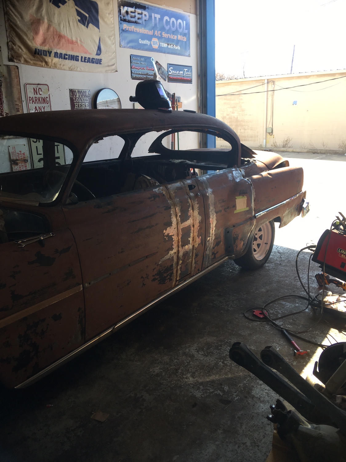

    Took advantage of the days great weather and got a lot of work done on the 53
    Dragged the car around and got the car in the shop and welded the post onto the car and tacked up the qtr panel
    The door opens and shuts great
    Squablow and low budget like this.

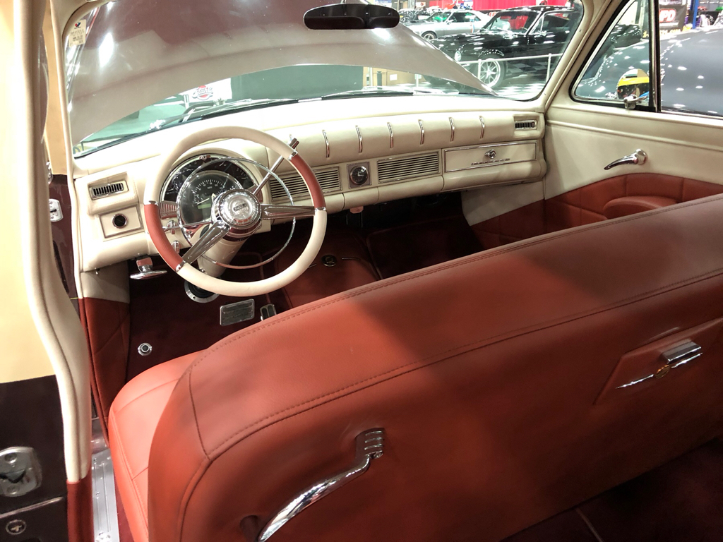

    Thought I would send you pictures of my 53 Town &Country dash for inspiration.....nice job on your Chrysler, there aren’t many Chrysler hot rods out there[​IMG]

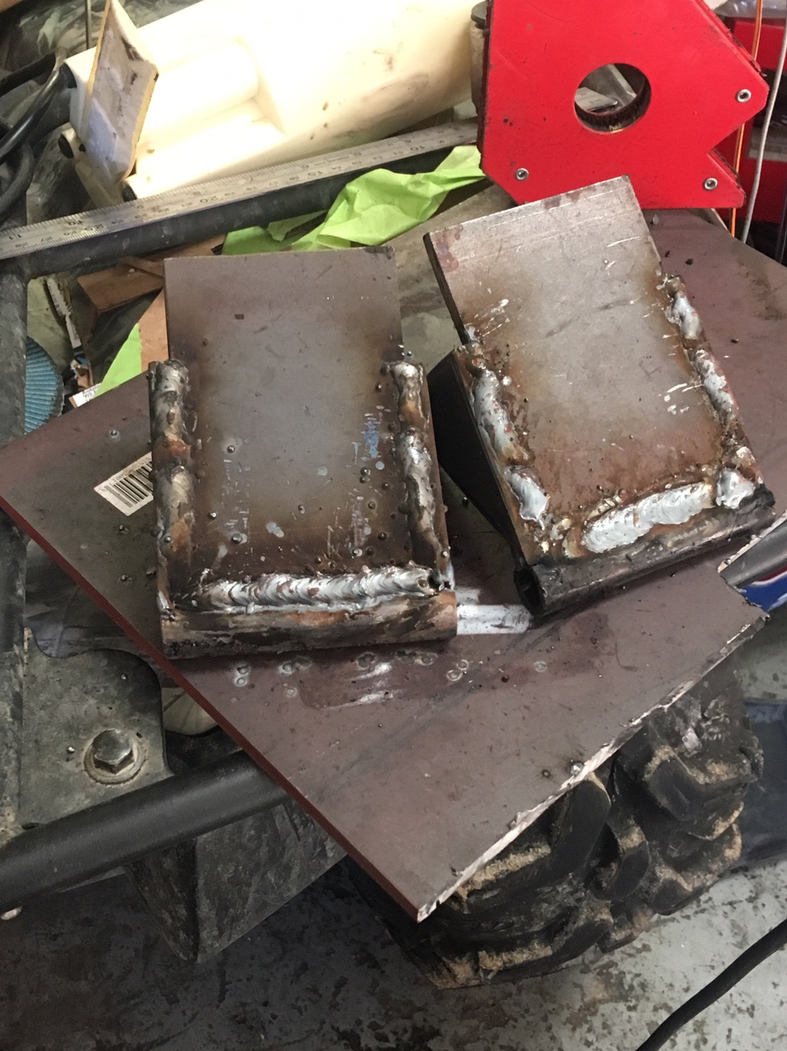

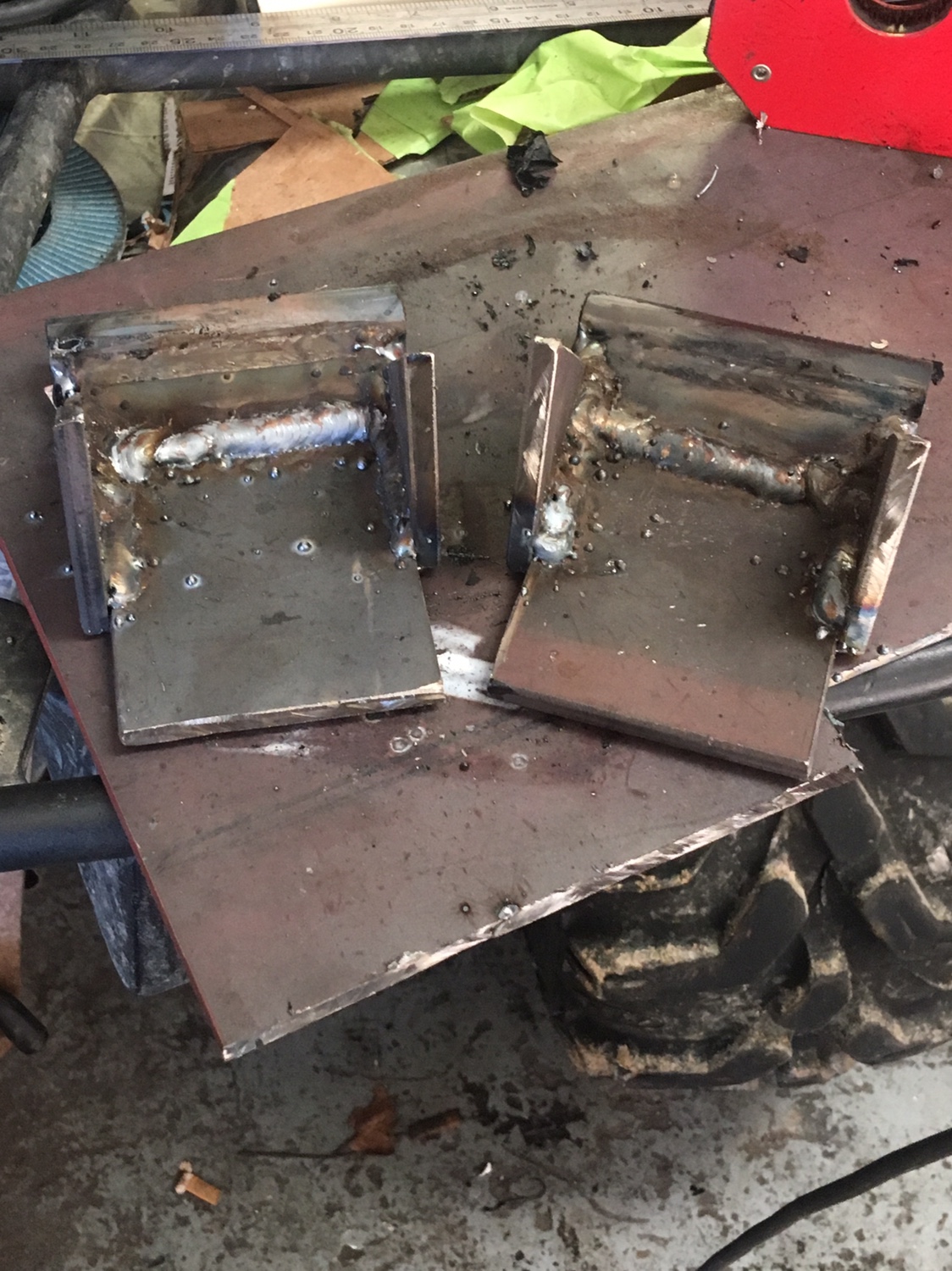

    Made some cheap lowering blocks to get the back end down low
    mcnally351 and Peanut 1959 like this.

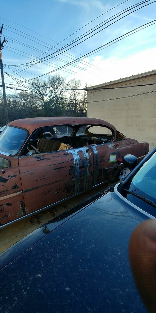

  29. low budget
    Joined: Nov 15, 2006
    Posts: 5,566
    low budget
    from Central Ky
    Passenger side coming apart now?
