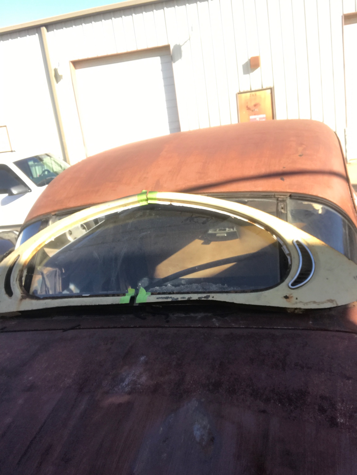

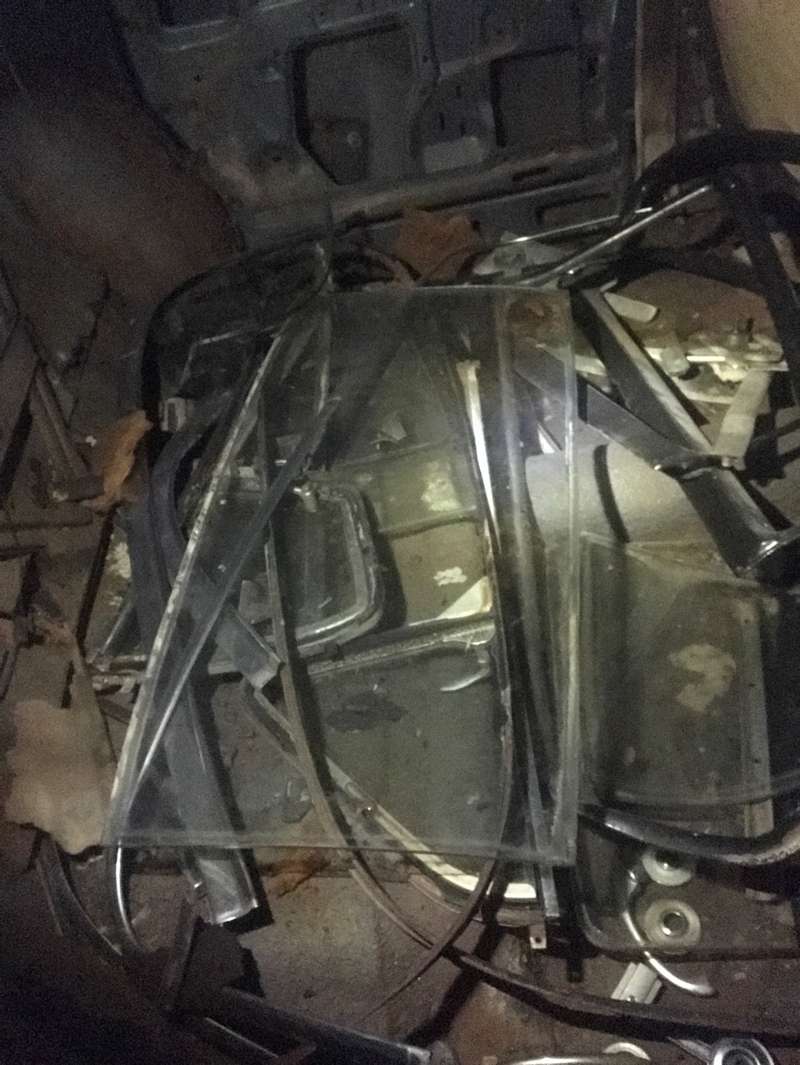

    The local junk yard has a 47 chevy I can get the rear window metal for $100
    My uncle gave me 2 vw bug side windows that I've been messsing around with
    And stick them together to possibly turn into a rear window
  9. Bearv81219
    Joined: Jan 10, 2018
    Posts: 47
    Bearv81219
    I'm keeping the front windshield but won't use it after the car has been chopped most likely
    My glass guy said it's too cracked to attempt to cut down
    But he can get me new glass and cut it down for me
    So he says

    That's why I'm leaning for more towards the 47 chevy rear window
  12. Bearv81219
    Posts: 47
    Bearv81219
    It was part of the deal for the car
    Previous owner wanted all the glass back for his car
    I would rather put a smaller one piece in instead of trying to chop and make a 3 pieces curved glass work with my chop top plans

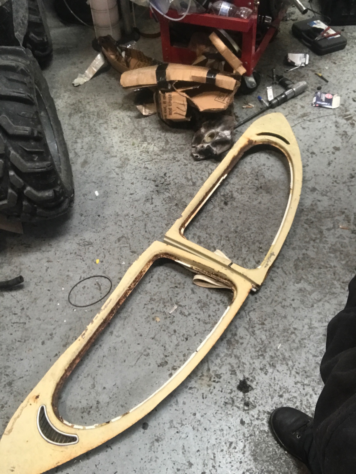

    Got bored at work and started making a patch for the rear door handle hole

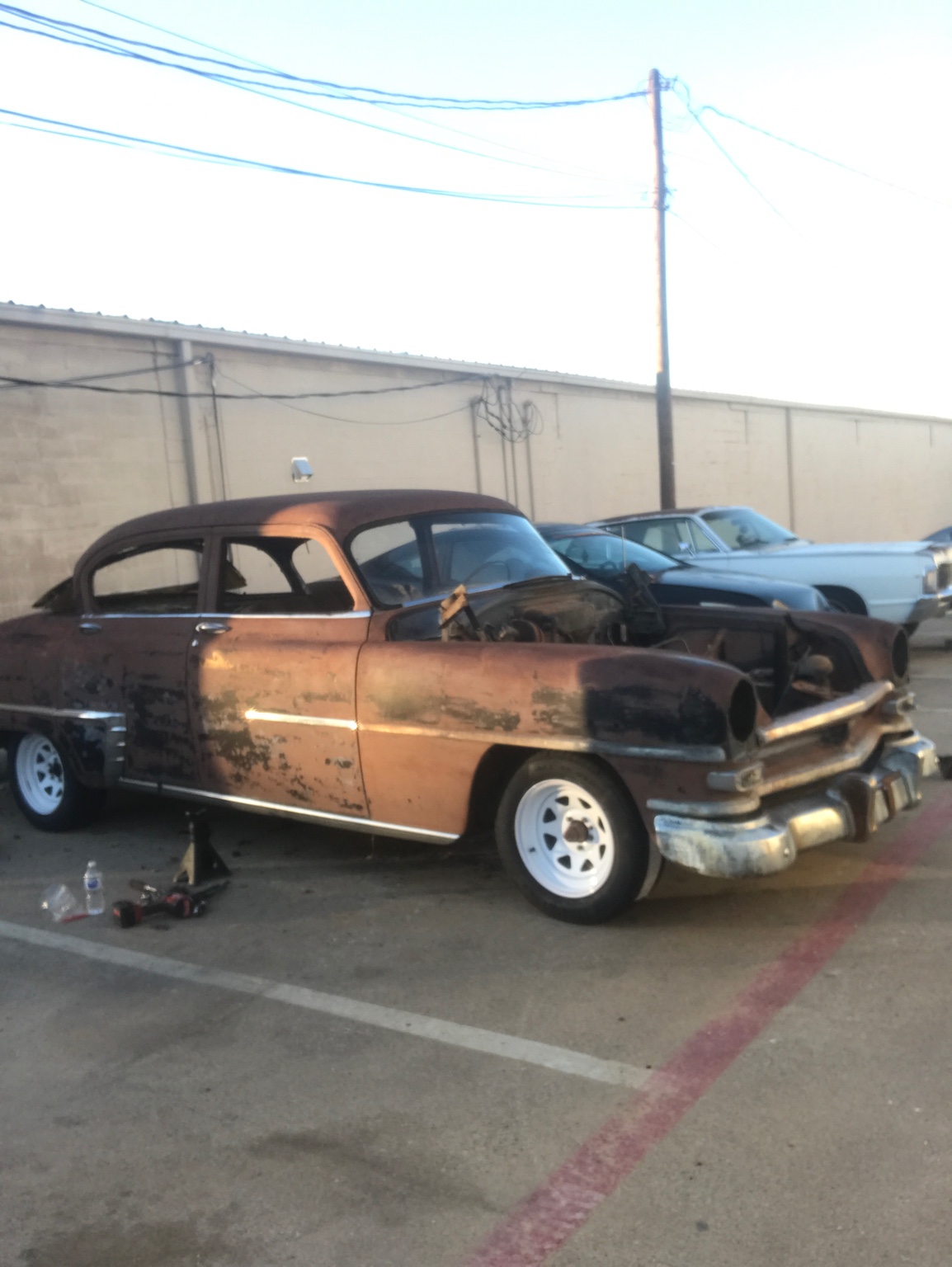

    Pulled the front end apart today and cut the coils
    1.5 coils cut each side
    I'm way happier with the way it looks now
    Just needs the v8 ford in it to see how much it really dropped it

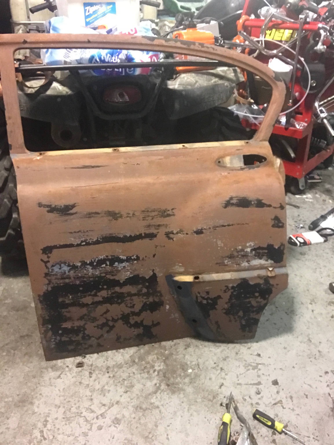

    Cut the 7 3/4 inches out of the rear door
    Need more gas for the welder and need to clean up my edges before I can weld it back together

    Weldied the rear door up
    And set it on the car
    It's not perfect but I'm happy with the results

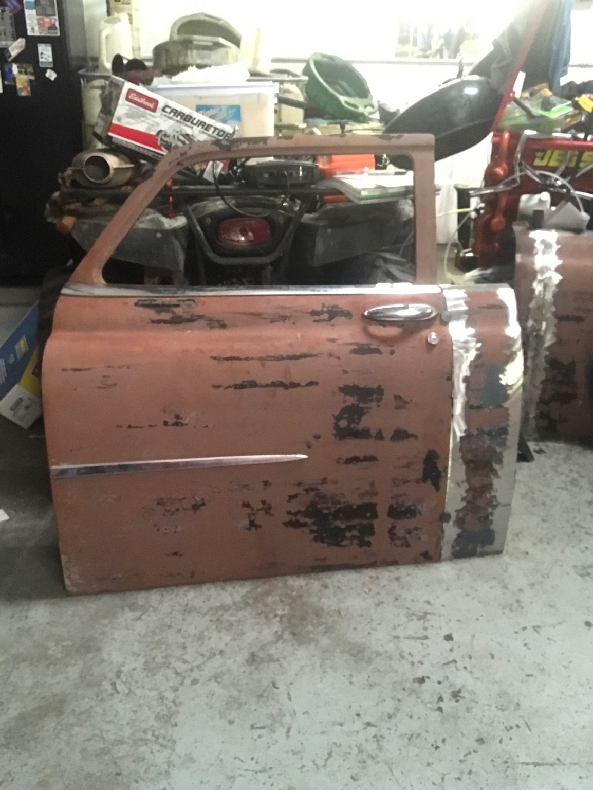

    Got front door removed
    Need to strip the chrome off and start measuring for my cut and smooth out edges on the extension
    chryslerfan55 and low budget like this.

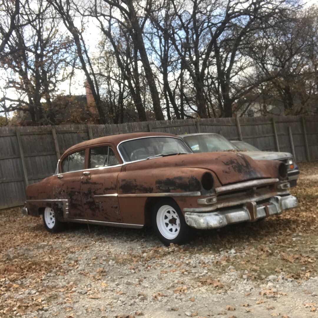

    Here are some candidates...
  27. Bearv81219
    Posts: 47
    Bearv81219
    Where did you find that first pictures
    It's one of my car
    I guess before the guy I bought it from got it and changed the wheels
  28. Peanut 1959
    Joined: Oct 11, 2008
    Posts: 1,155
    Peanut 1959
    I was pretty sure it was! I just googled "1953 Chrysler Windsor" and it was one of the results.
  29. Bearv81219
    Posts: 47
    Bearv81219
    Very cool
    I never took a good side shot before I started cutting this thing up thanks for find it
    chryslerfan55 and Peanut 1959 like this.
