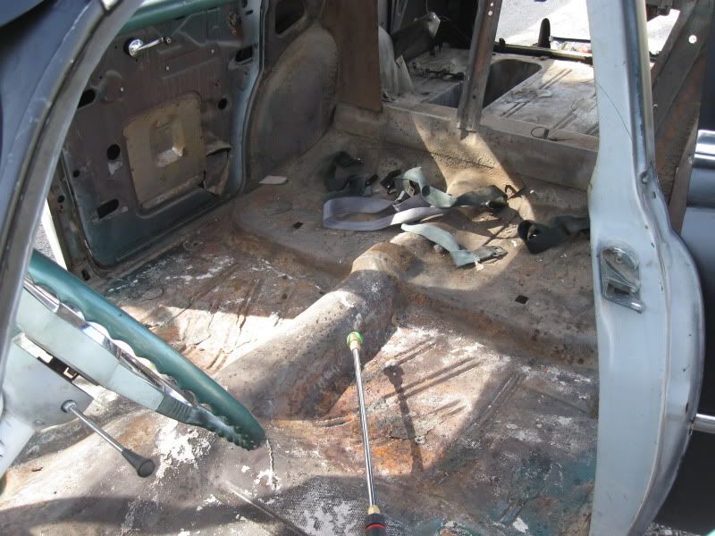

    Day 1: Strip interior, pressure wash, air dry, minor surface rust removal. Pressure wash, air dry, heat dry. Pull out shitty 2x4 steel blocks welded together for lowering. Clean axle housing and weld in new perches, make new U-bold plates and bring back to stock w/new U-bolts.
    after: [​IMG]
    very suprised at almost no rust on this car.

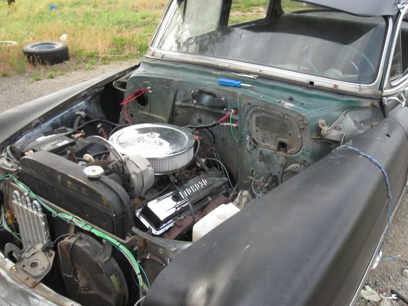

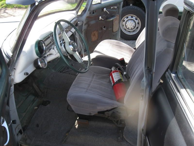

    Thanks for the comments. I should be done by now but we lost some folks at work so its manditory OT for everybody. I'm actualy posting this before going back in to work a surgical suite :(
    So I wired it up, installed new gauges, and fuel, water temp, oil pressure sending units. Painted the dash and installed new headlight, ignition, wiper switches and a new cigarette lighter.
    The new electric wipers need some modification but the motor is in and wired.
    I'm deciding if I want to change the electric fan out or not before looming the front wiring and the two loops on the firewall are unused that I may hook up.
    I installed carpet with heavy duty insulation on the floor and the trunk.

    Hopefuly tomorrow I can get to work on it and have the seats and belts in w/new hardware, and work on the windows.
    I found out one of my windows was acrylic when I did some overspray clean up with acetone :D. O well I want new glass anyways. I should be able to take this in and register it this week.
