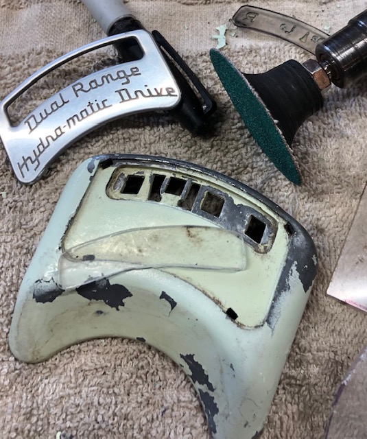

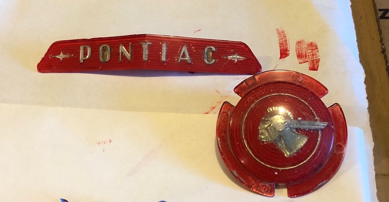

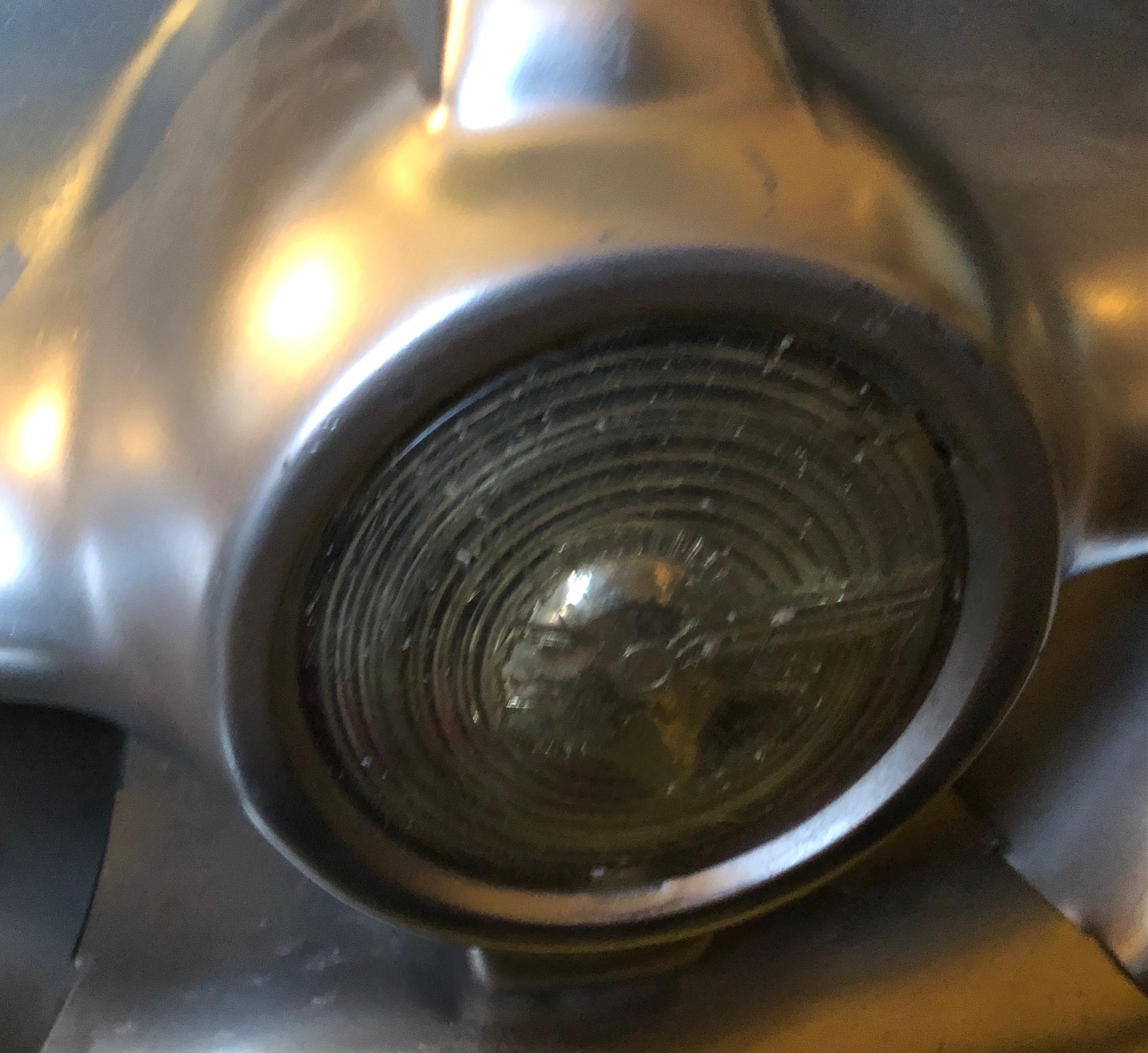

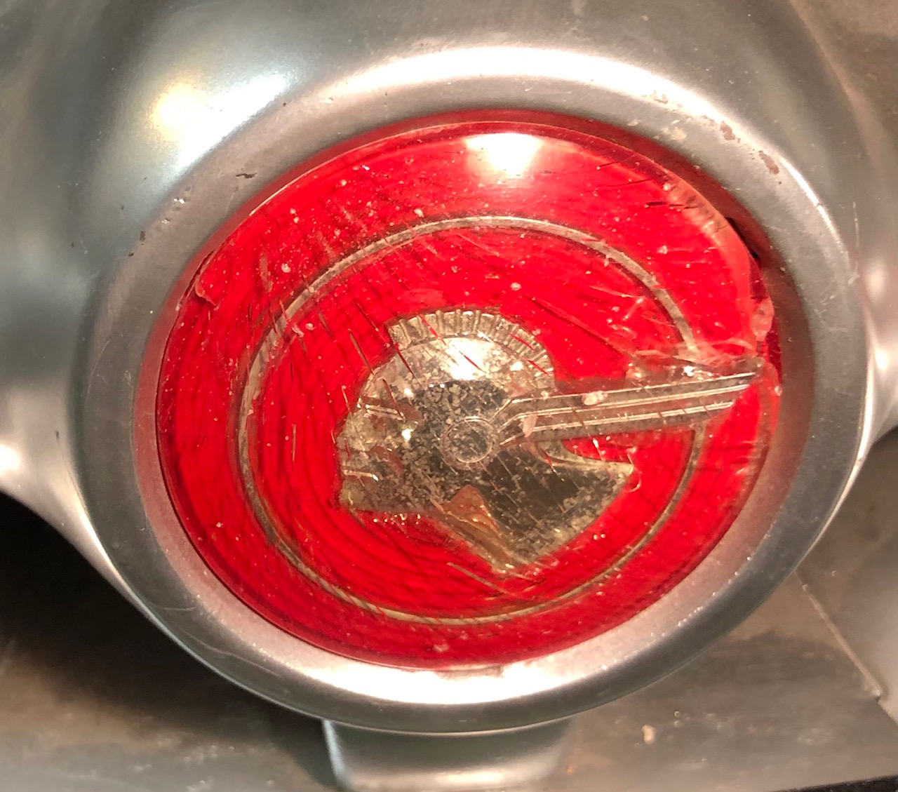

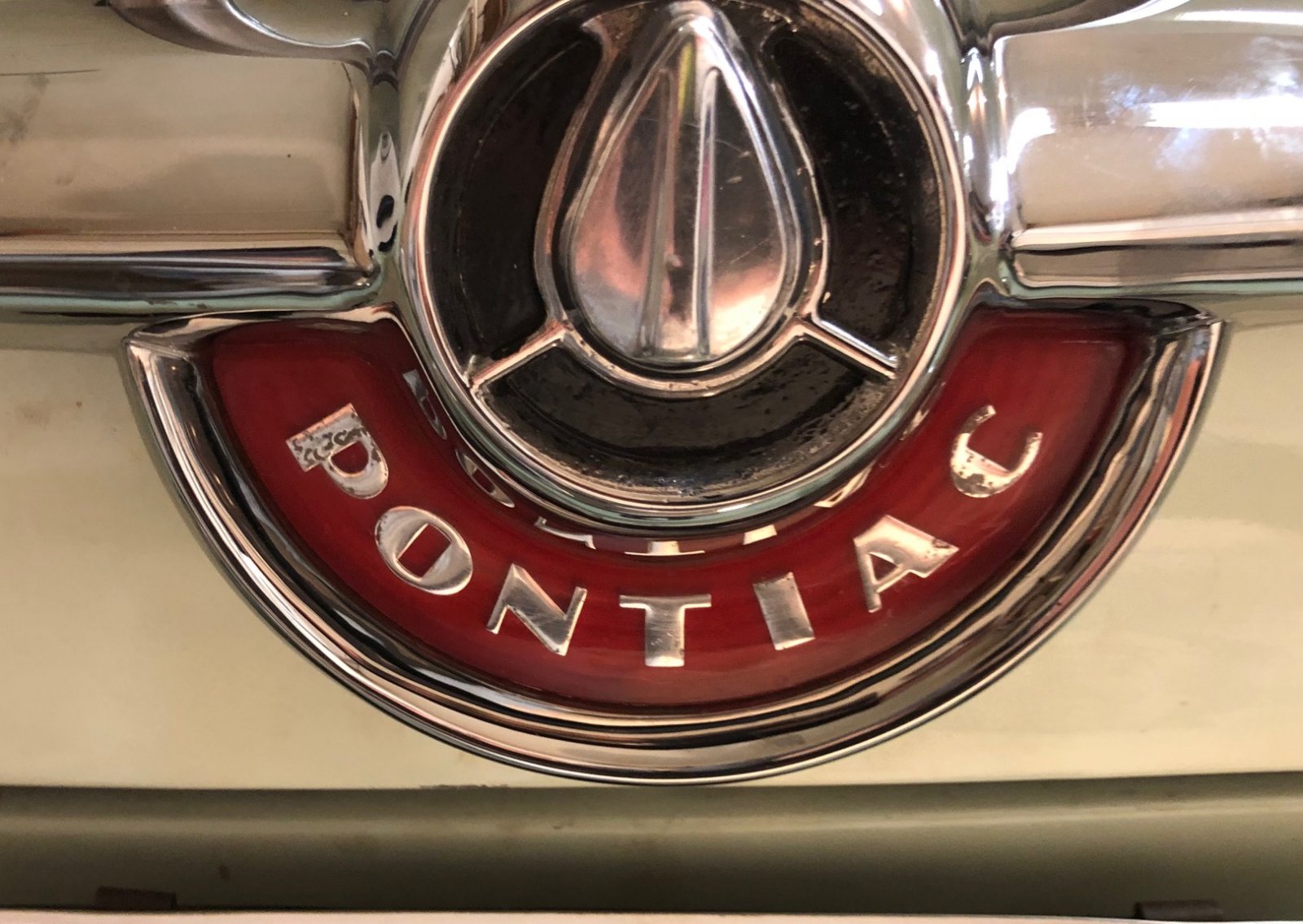

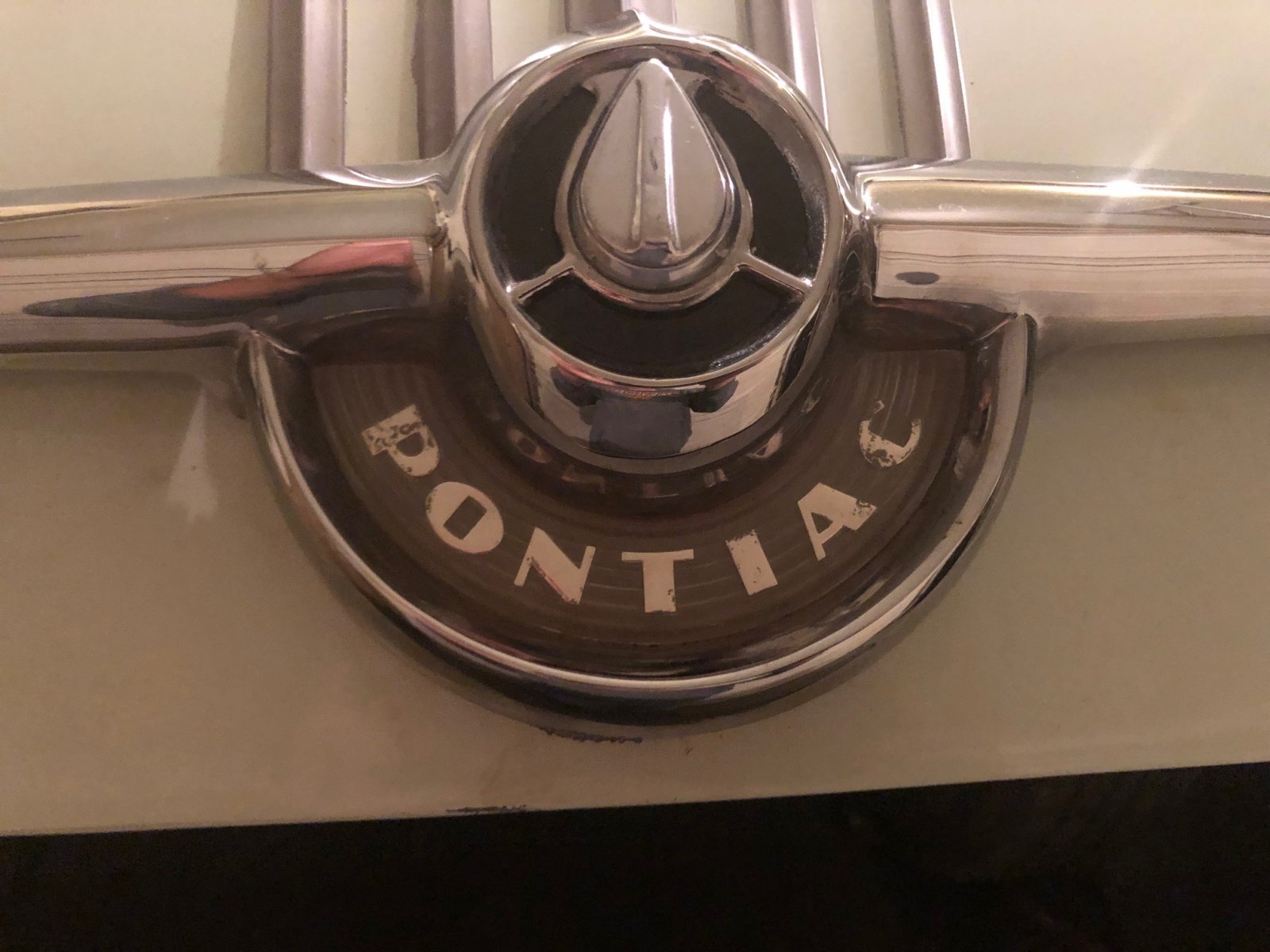

    Did some touchup on the badging to get the red back

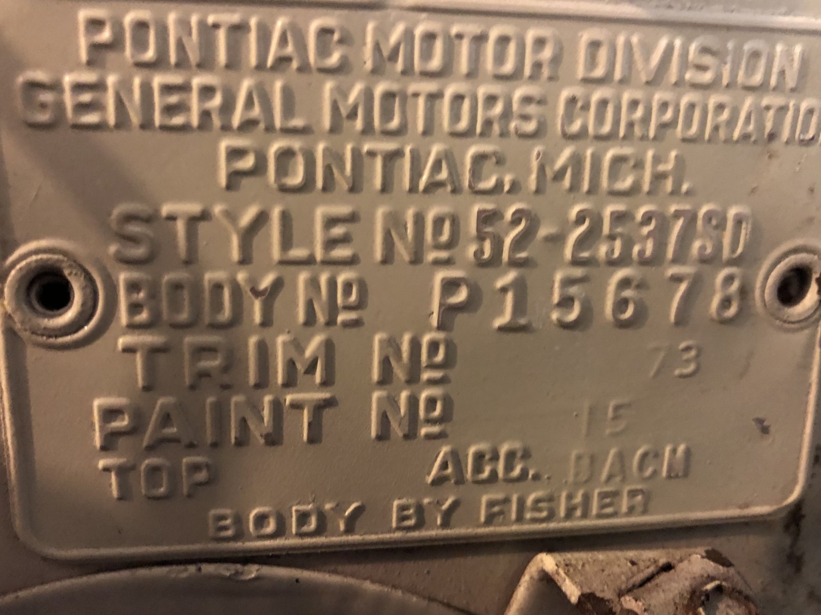

    Bruce A Lyke
    Oh, despite what the state thinks, seems i have a 1952, not a 51. this is now located behind the battery holder tag.jpg

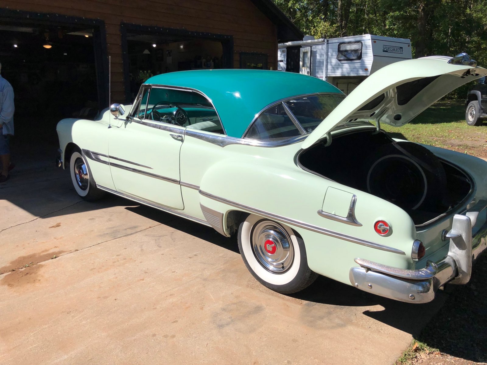

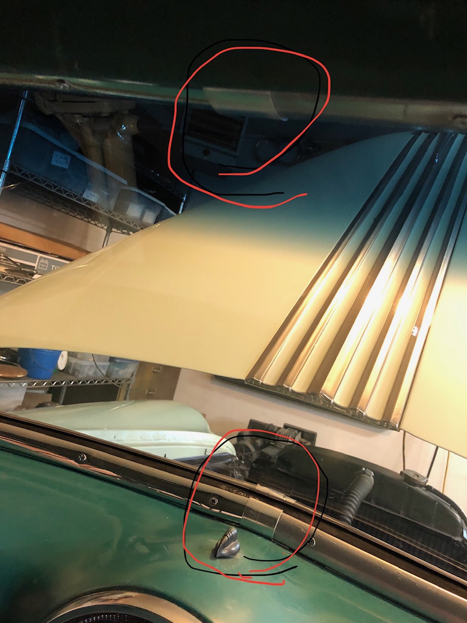

  7. Looks like it had a visor at some point? I see the holes in the a-pillar anyway.
    41 GMC K-18 and loudbang like this.
  8. Bruce A Lyke
    Joined: Jun 21, 2009
    Posts: 2,523
    Bruce A Lyke

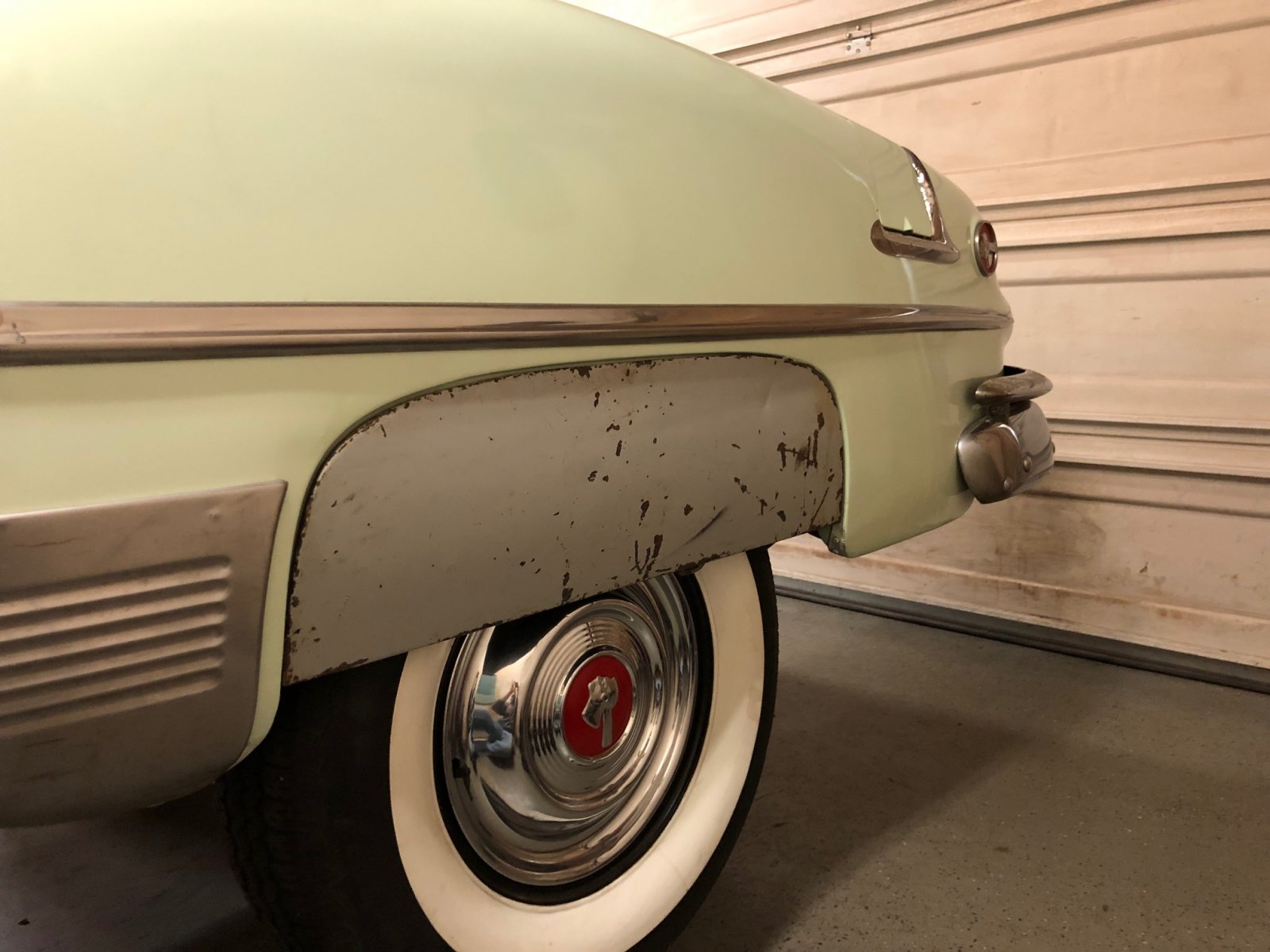

    Yep, and skirts too. I have found some original skirts that will get restored at some point. Looks like the visor will have to be a Oldsmobile version since it had a 1 piece windshield. there are Re-pops available and, like the rear window screen for the 59 Nomad, will be one of the last things to spend money on (unless I find a super deal some where).
    BTW, good eyes
  9. Lol...only with my cheaters. :oops:
  10. Cleans up real nice. Sure is purdy!
    Bruce A Lyke likes this.

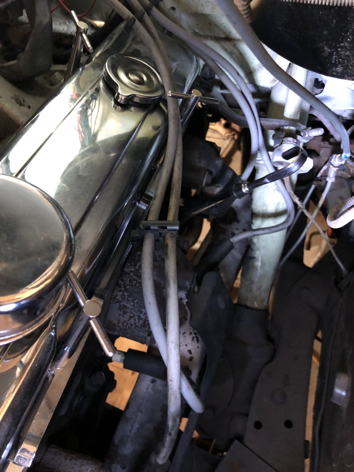

    Bruce A Lyke

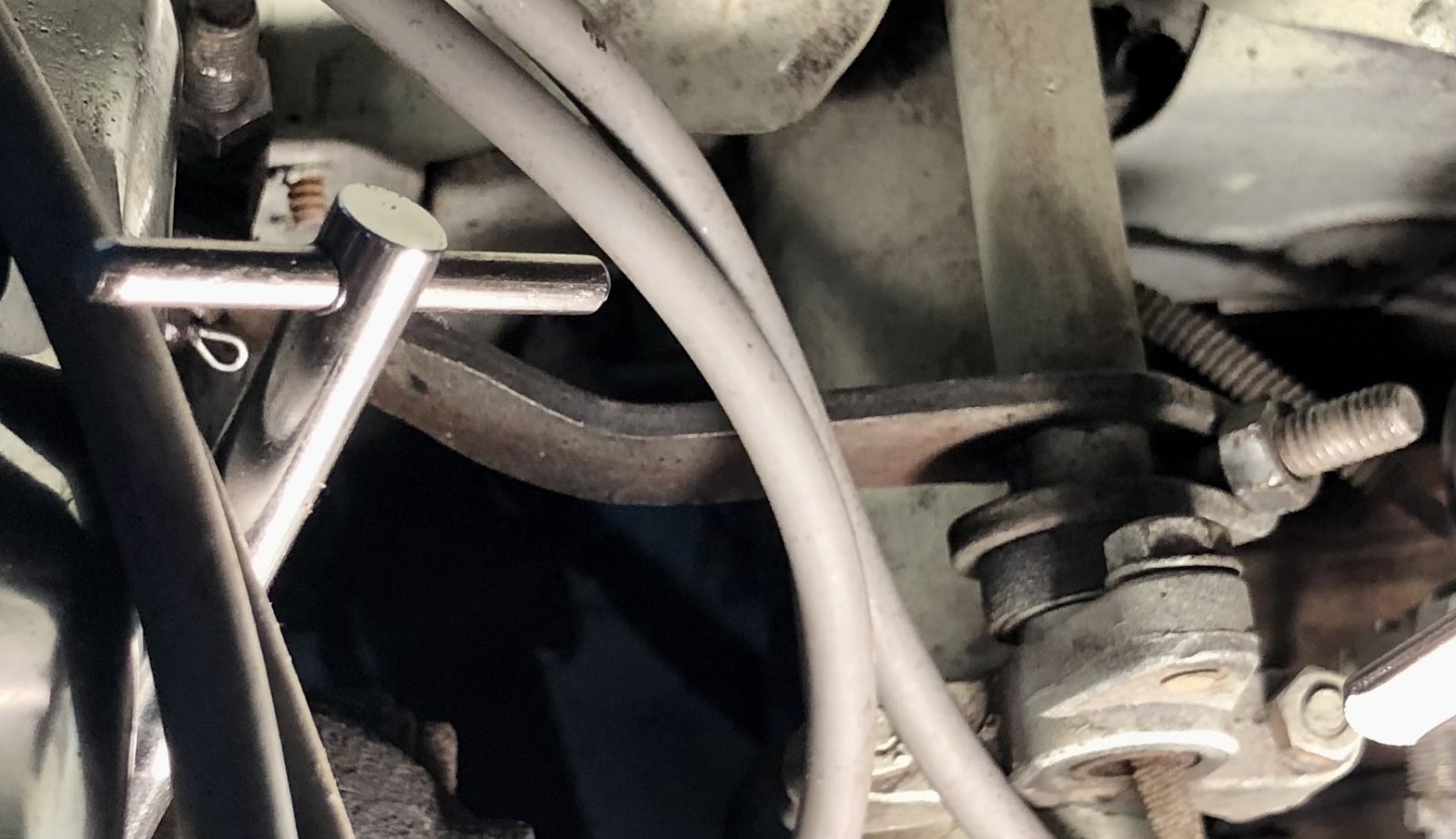

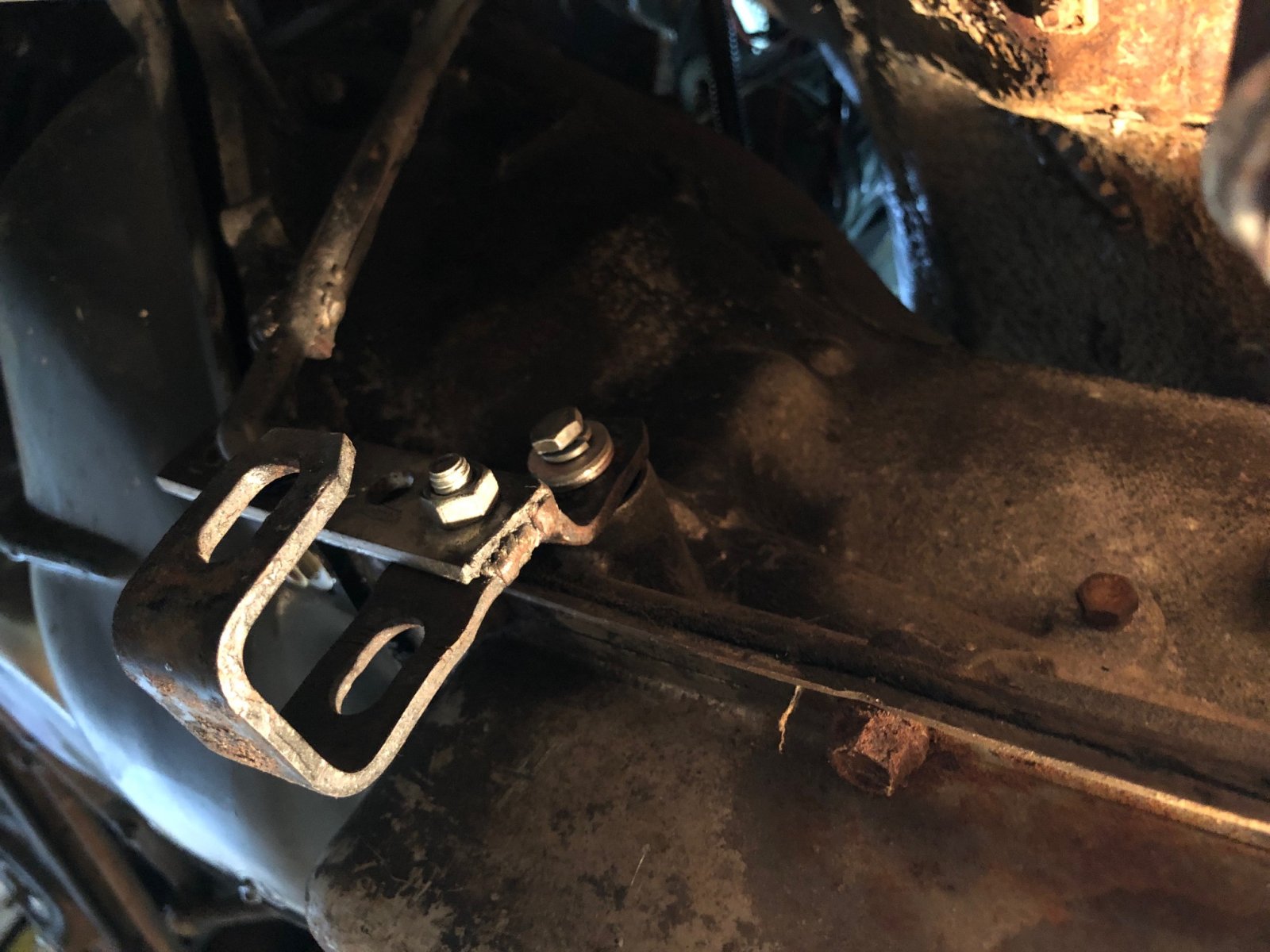

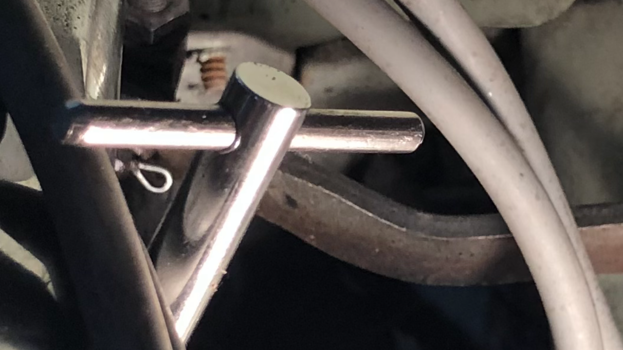

    Pulled the old shifter linkage and did some troubleshooting on the range of movement. From the looks of things, the PO put the engine back a bit too far, with homemade engine and tranny mounting supports. the shift lever on the column hits the valve cover. It looks like I can cut off an inch or so, it is currently about 5" from the center of the shaft to the current connecting rod shaft. Have a Lokar (or that style) kit on order and looks like this will allow a normal range to all gears. Currently it was not possible to downshift to 1 & 2
    Okie Pete, loudbang and 51pontiac like this.
  23. Bruce A Lyke
    Posts: 2,523
    Bruce A Lyke
    Well with a bit of effort, some cutting, welding, rework and some trial and error, the Catalina now has a fully functional gear shift. the lever on the column no longer stops at the valve cover. The Parking brake has a new cable and is fully functional. the speedometer drive gears have been switched and should soon provide an accurate indication of MPH. The old semi-shiny gas cap without a seal has been replaces too with a new one with a decent seal

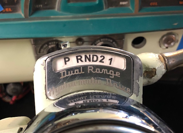

    Progress continues
    Now have a functional shifter and a reasonably accurate indicator

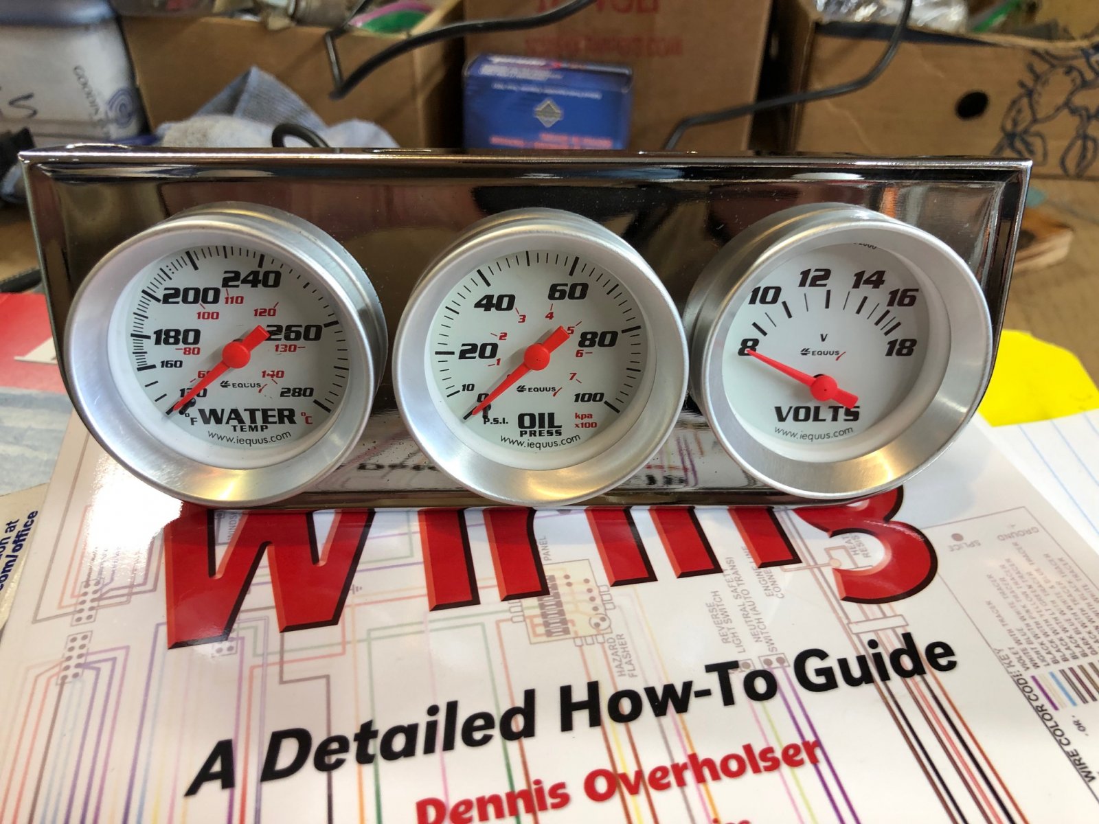

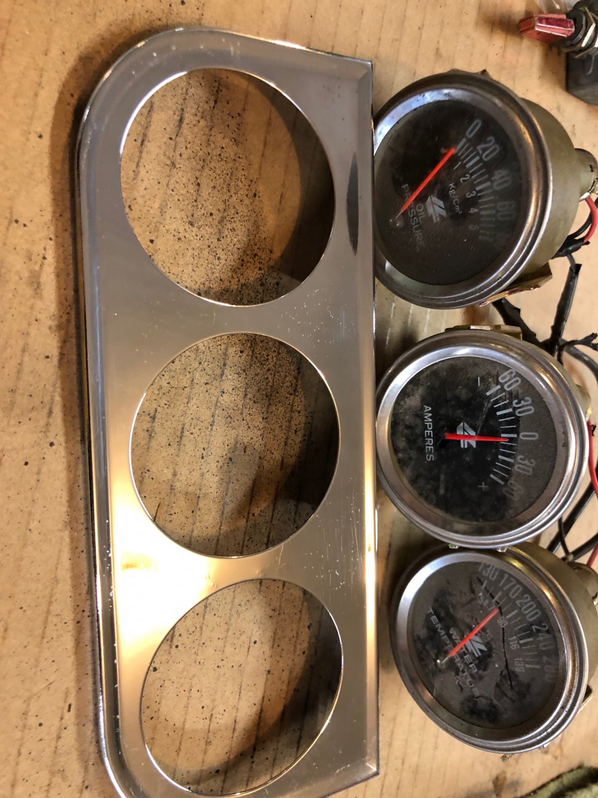

    Updated gauges to use a chrome mounting that was in the Nomad when I got it.
    Working on rerouting wiring, may have to shorten most of it, good news is ~75% was completed and working. adding 12 volt wipers, th400 kickdown, Backup switch and Neutral safter Switch, as well as a Small "defogger" just to have for a rainy day

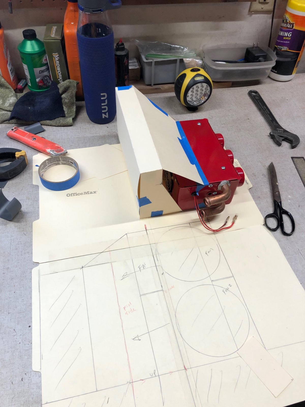

    Time for an update....

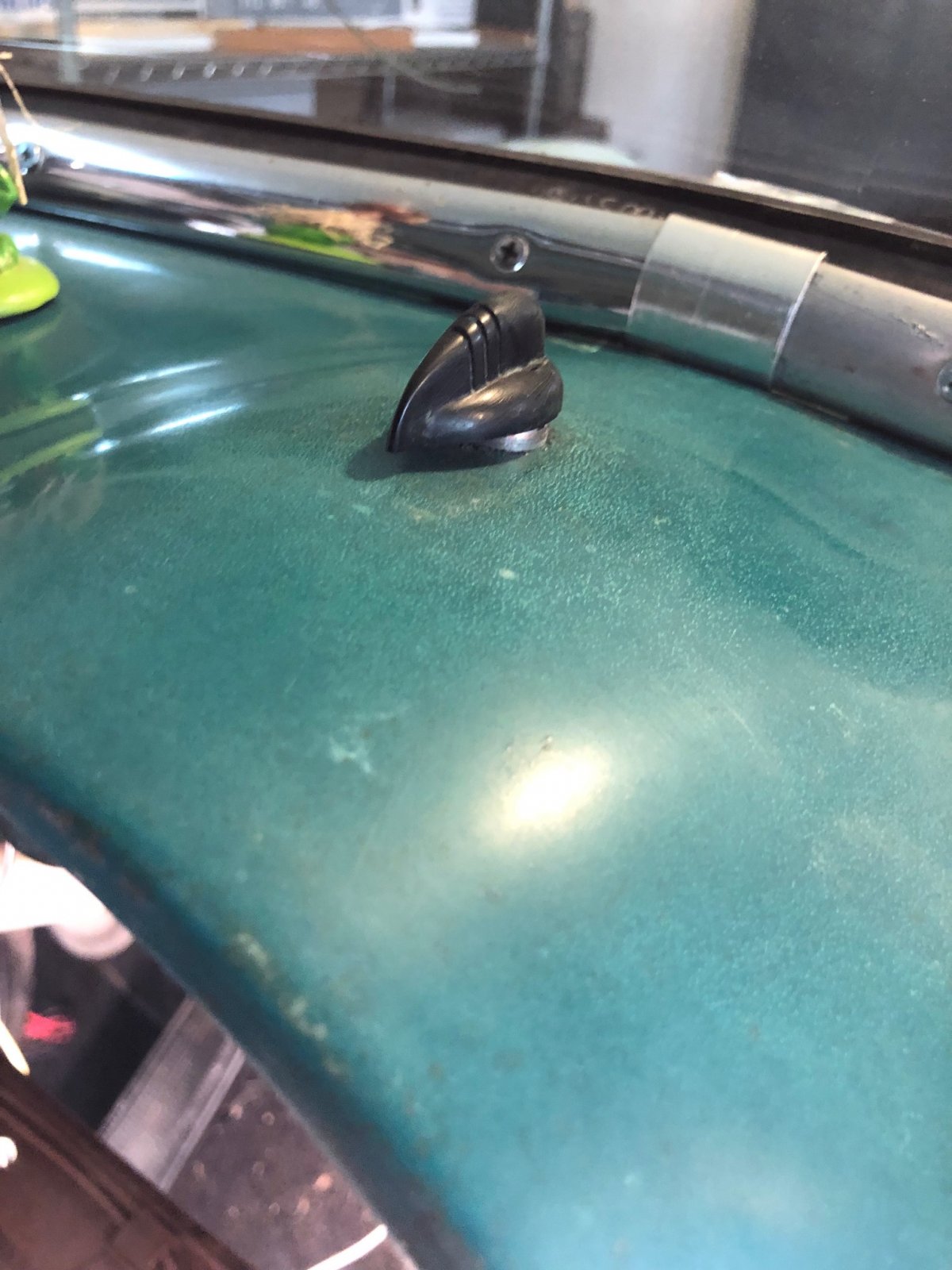

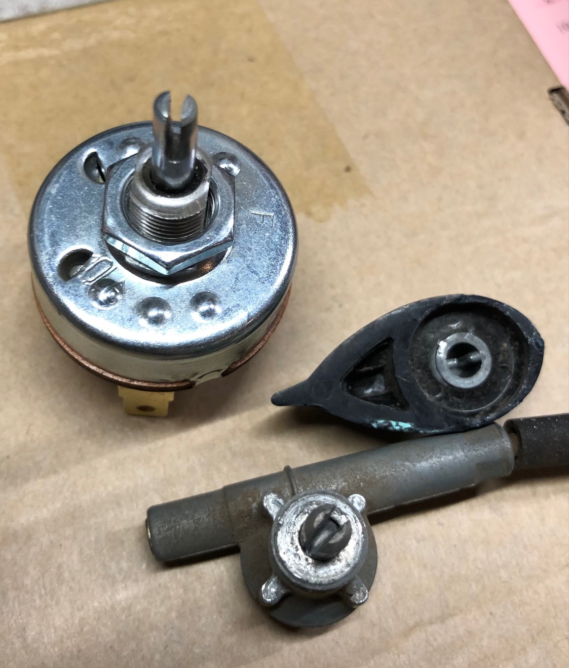

    The new wiper motor is now in and the switch was modified to go in the top of the dash and use the original knob
    Also have the heater ready for some paint and then installation, there will be plenty of air going to the windshield which was the main goal

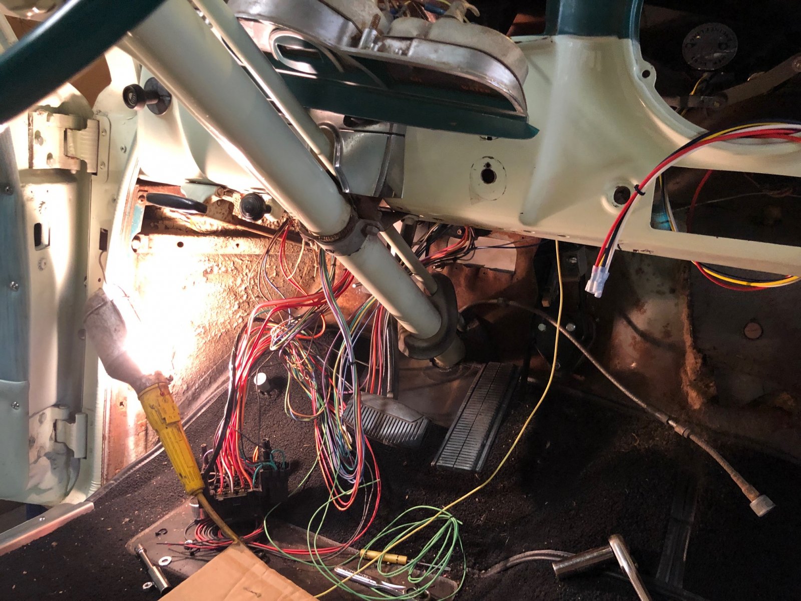

    Progress is steady but slow, as the rework on the wiring is getting done. Hard to see the progress but it is happening:rolleyes: wiring on 52.jpg

    One of the Before Pictures:rolleyes: wiring on 52 B4.jpg
